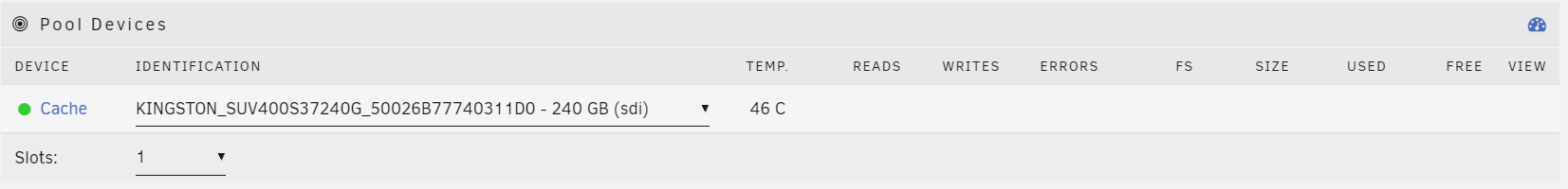

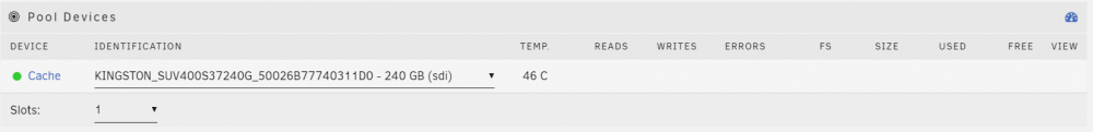

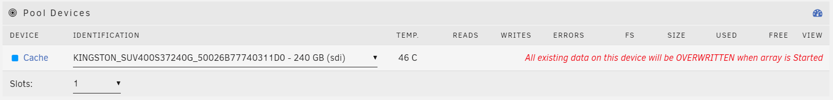

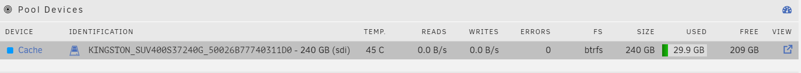

How to reproduce:
-create a new single device pool
-assign a device
-start the array
-icon will remain blue
-then when the array is stopped you'll get the data will be deleted warning at array start (but it's not)
-restart the array, after or without re-assigning the device and icon will remain blue.
Current workarounds:
-change pool slots to 2, then back to 1
-reboot with the device assigned
Now it's green and saved.
