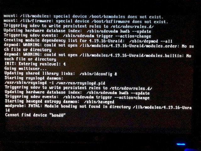

My adapter is br0.  I was running 6.6.0, I believe.  After updating to 6.7.0-rc1, I could no longer reach the web interface.  I logged into the console and run I run ifconfig, I see that my br0 interface has a 169.x.x.x IP address.
edit:  I manually changed the IP on br0 to the IP I usually use, but it is still unreachable.  (Used ifconfig to do that).  I Can't even get an ARP back.
Is there a way to revert to the previous version via the CLI?
After additional testing, it seems that the bonding module is missing from this build:
