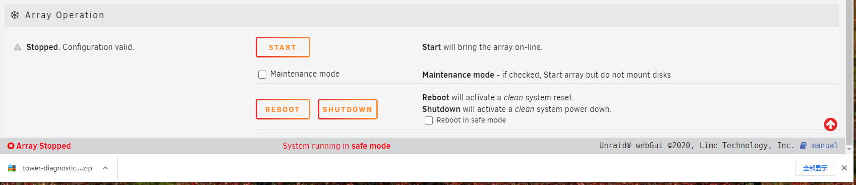

I found Vms unable start after reboot due to array is off-line, even though array auto start is enabled in disk settings. Such bug occur only when my Unraid failed to access network.
Reproduce the bug process:
1. Confirming that setting - disk settings- enable auto start is [YES]
2.Plug off network cable that used to connect  webgui for management.
3.Turn on/reboot Unraid, booting as safe mode.
4.After noticed that ipv4 address is 'not set', plug on lane cable. Ifconfig cmmand suggest that Unraid get ipv4 address.
5. Connecting to management interface, the arrary status shows off-line
tower-diagnostics-20201202-1754.zip
