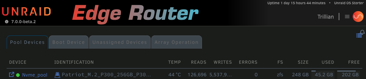

On a system with a single NVME drive formatted as ZFS - No Array

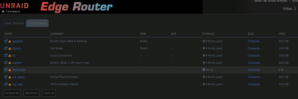

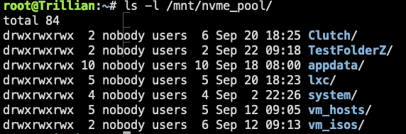

From terminal, create a directory on the pool volume

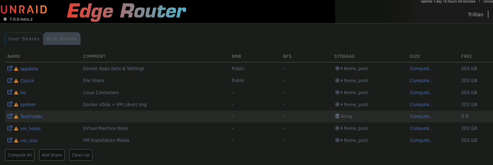

It gets created (shown as TestfolderZ in this image)
Open the Shares tab in the WebUI to see the directory/share listed as belonging to "Array" (which doesn't exist)

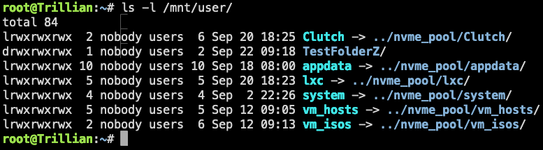

If you check the /mnt/user/ fuse path, you can see the directory appears there as well, but not as a link like all the other shares

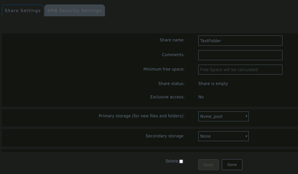

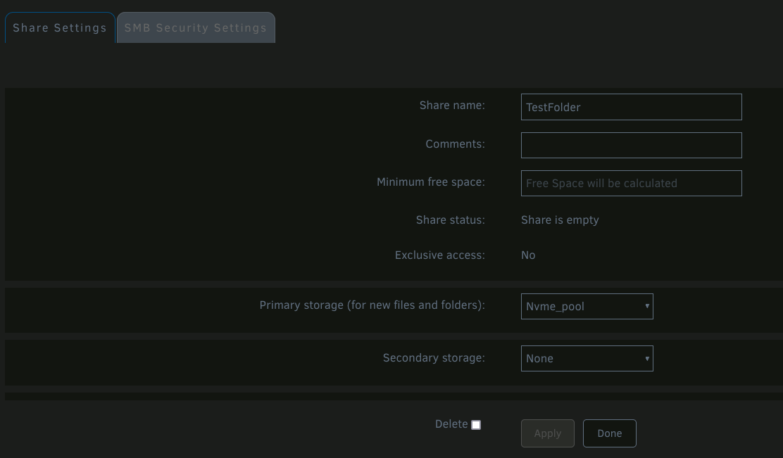

The directory/share's settings correctly show that it really belongs under the pool

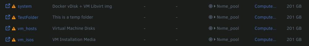

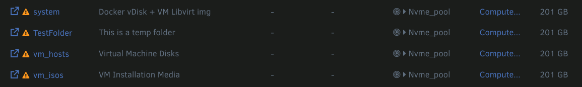

Making an edit to the settings, such as adding a Comment, and then applying, corrects the issue:
Continued in next post...
