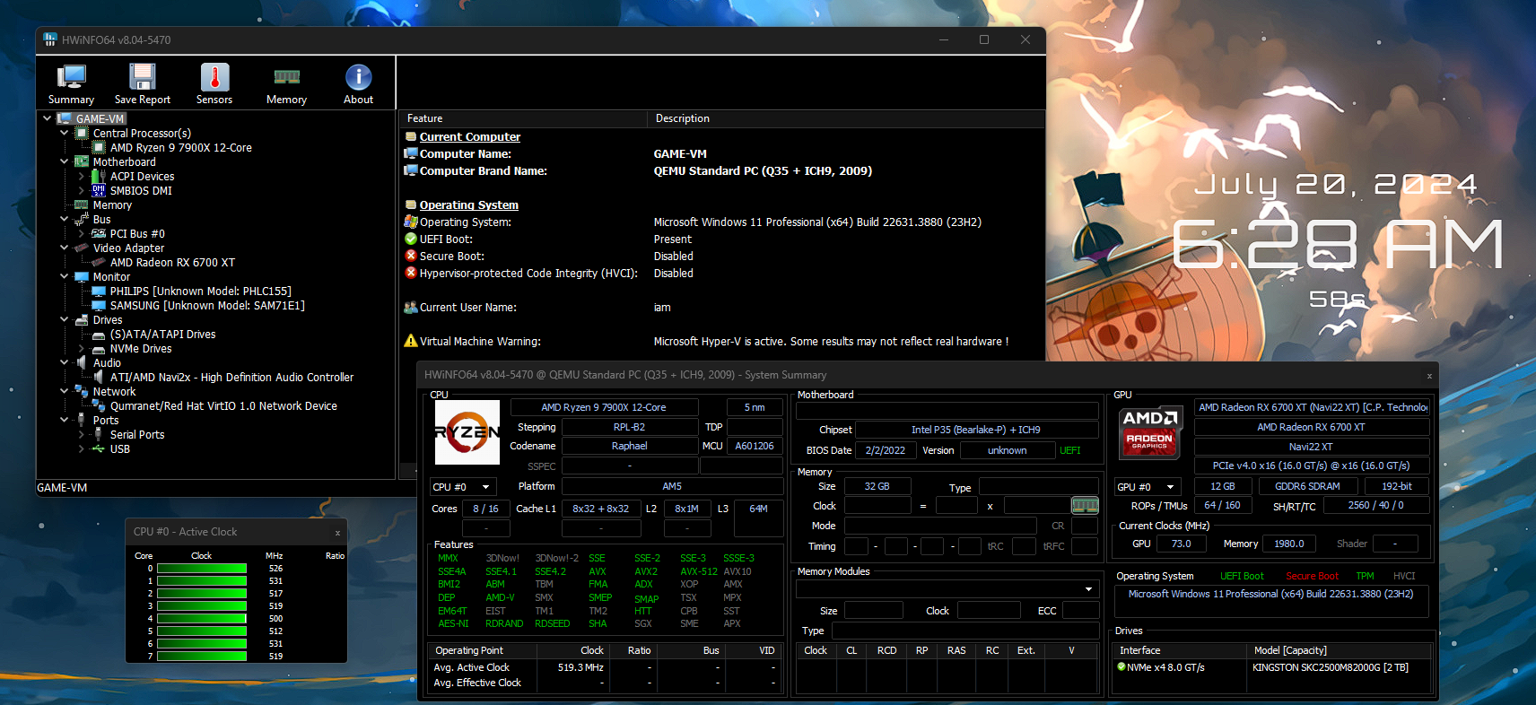

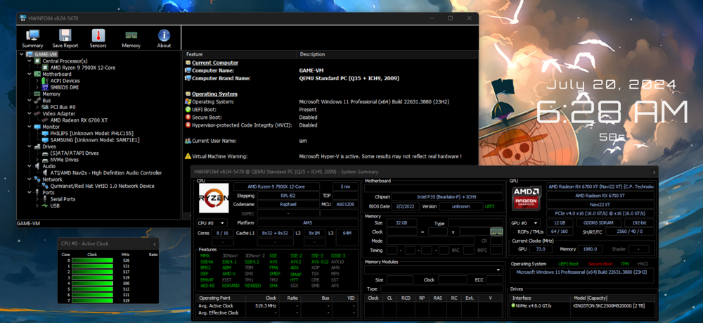

unRAID was unable to give out sensor data in 6.10, 6.11, 6.12, and now also in 7b2. So I'm not too sure what's going on here. Also! If I start CPU-Z or try to get the sensor data from HardWare Info, my VM reboots. That was a new experience.

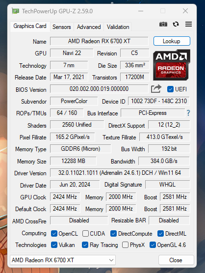

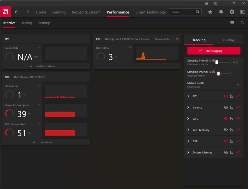

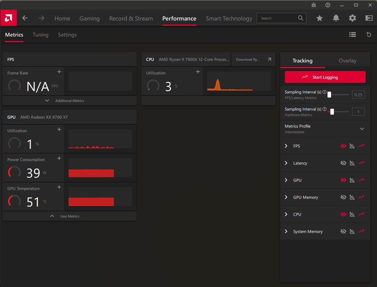

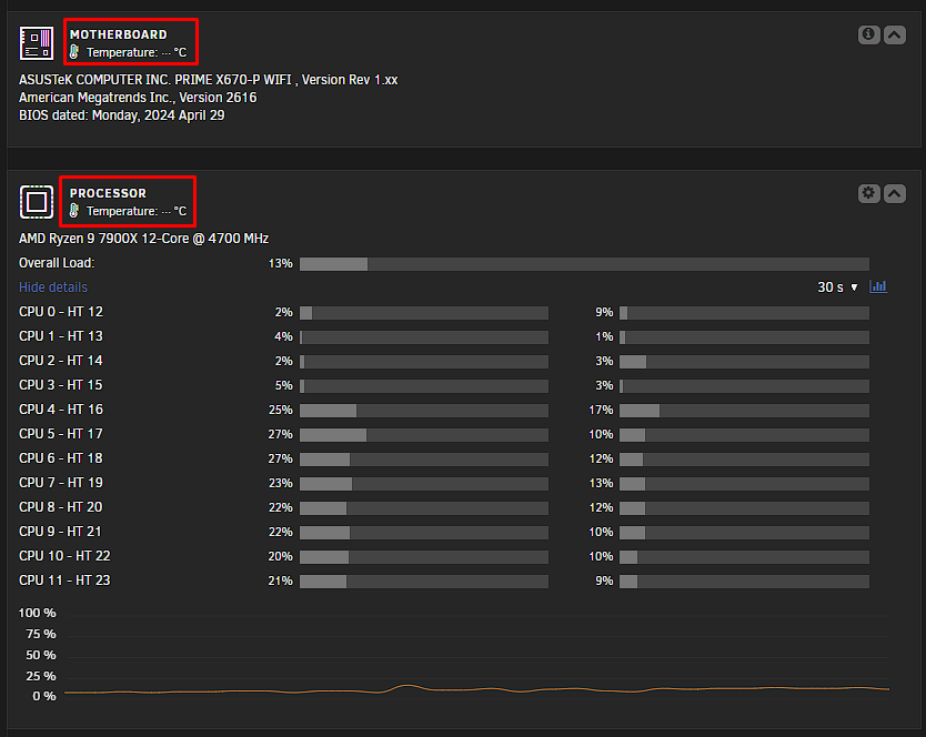

The first picture is from the terminal of unRAID it gives out the sensory data from the psu, which is nice, and one of the m.2 NVMe's i figure and the third is either the GPU, or the second m.2, the second picture is the AMD Experience Suite, and it has no problem giving out any sensory data regarding the dGPU, not strange at all since it's passed through to the VM. The third picture is of HardWare Info. . . . What is HVCI? The fourth picture is of GPU-Z, and it's just more data on the dGPU, the fifth & sixth pictures are also from unRAID . . . so that's about it.
The BIOS/UEFI gives out the CPU and Motherboard temperature data without a hitch, but it's never received by unRAID.
