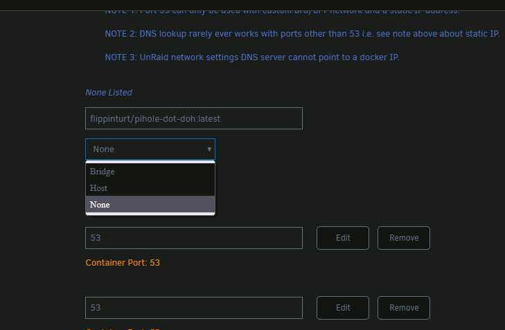

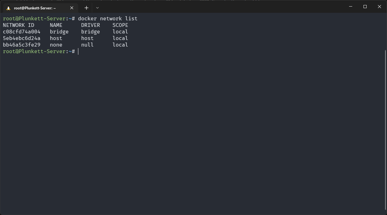

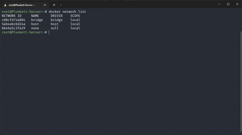

I updated to the latest rc4 and have been having an issue with networking. When enabling ipv6, the network goes down and does not come back up until I force a reboot. I let the system sit for quite a while and it just timed out until I forced a reboot. On reboot, the system came back up and was assigned an ipv6 address properly, however BR0 is missing. I did the following after reading quite a few posts here:
rm /var/lib/docker/network/files/local-kv.db
/etc/rc.d/rc.docker restart
That did not bring back BR0 at all. I've rebooted since then and still cannot get BR0 back.
Screenshot and diag file attached.
