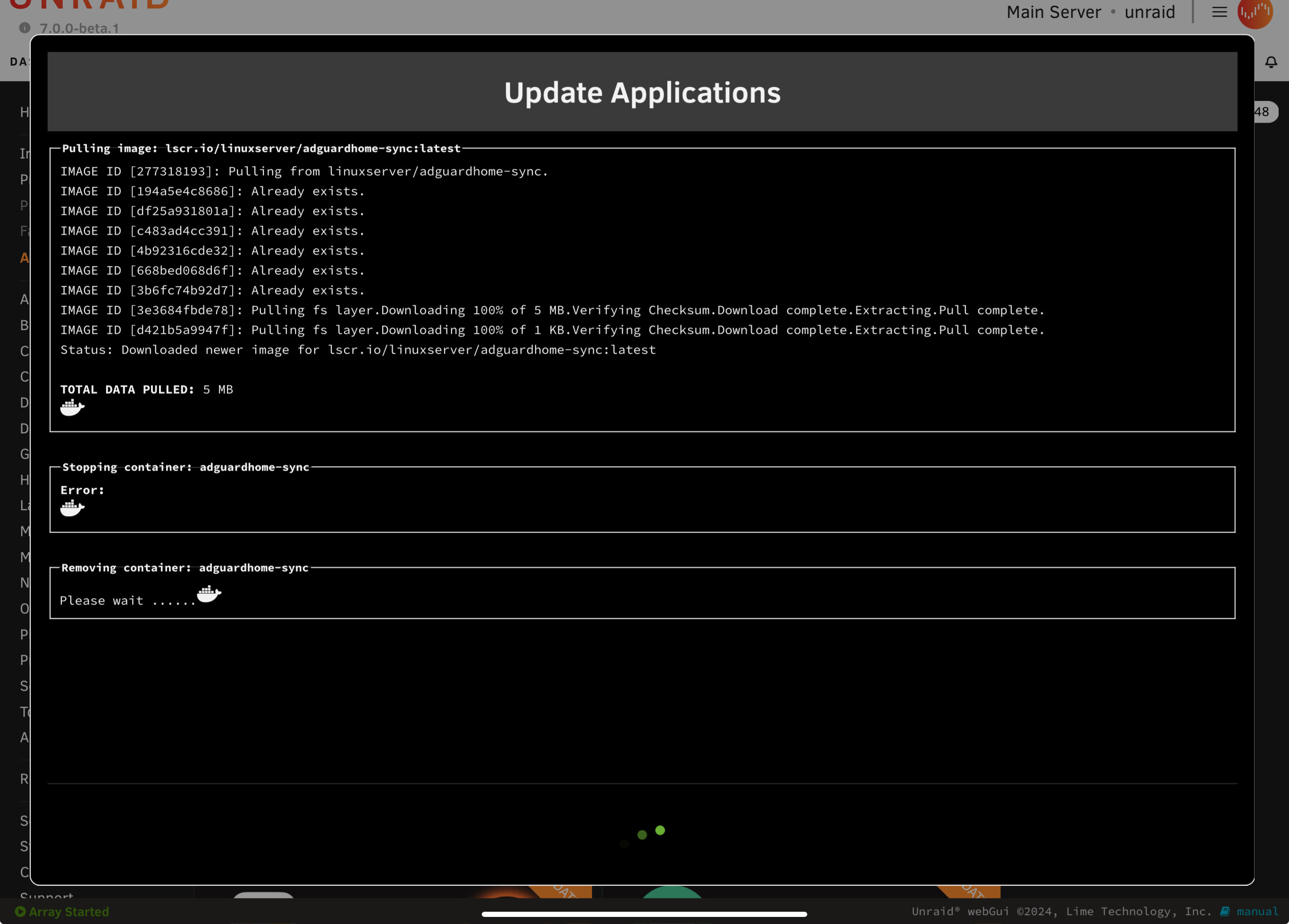

I recently replaced my old Node 304 with an i7 7700 with the UGREEN 6800 Pro and installed Unraid on it and it was working like a charm. Since I have multiple backups (tested multiple times and able to go back to a normal state) and was looking forward to test the Arc GPUs, I installed the new Unraid 7 beta. The GPU works without issues and almost everything is working as intended except for 1 situation: updating docker containers. Doing that, more than often, causes my server to “crash” and for the life of me I can’t figure it out why. Before updating to Unraid 7 beta I didn’t have any issues whatsoever.
I selected a few apps to update and the process starts as normal, but hangs (Image 0031)

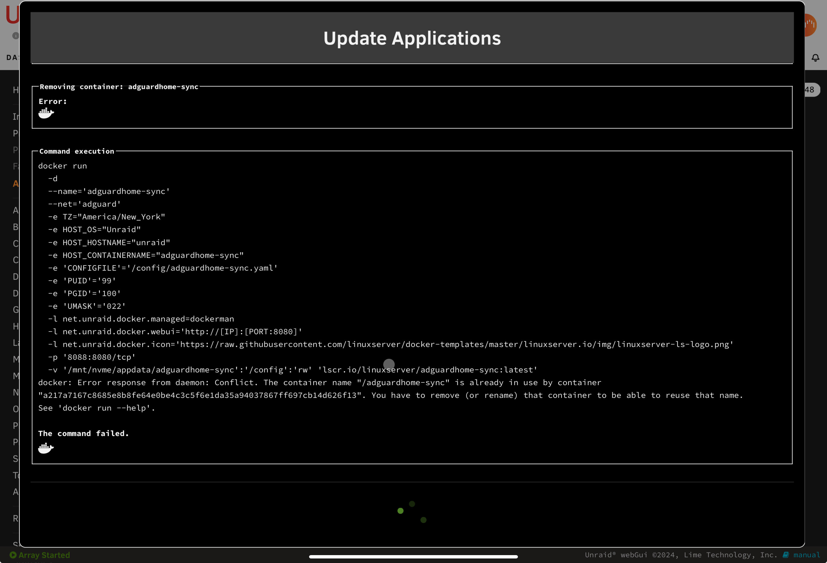

2) Shortly after it fails, saying that there’s already a container using the same name, which is 100% not the case (Image 0032)

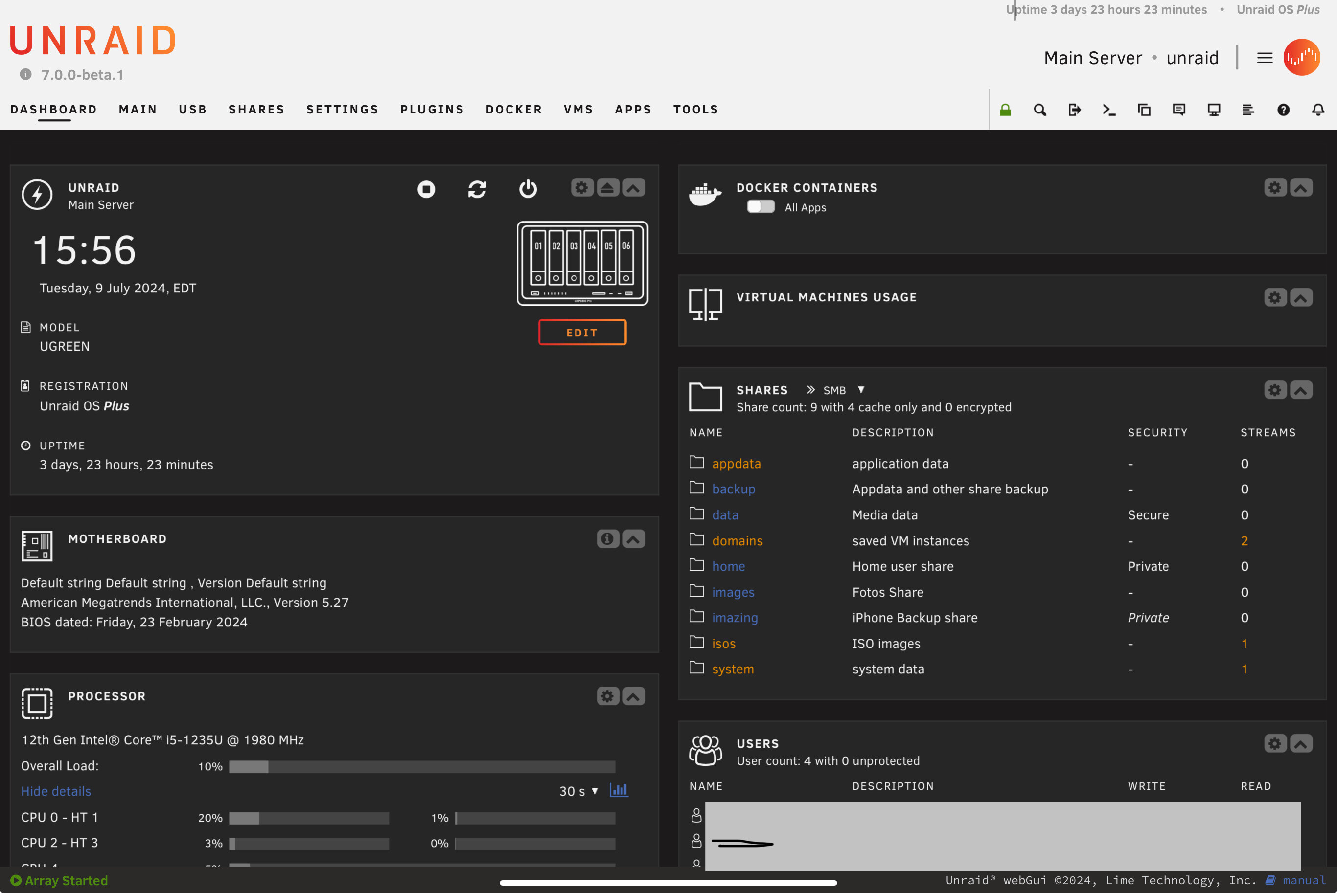

4) After the main ”Dashboard“ loads, it doesn’t show the docker containers or VMs that are running, despite them running if I type their IP/port (Figure 0033). The only container that it doesn’t work is the one that failed to update.
