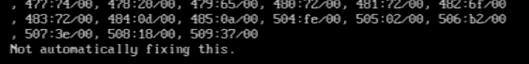

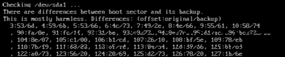

During boot I see the following:
There are differences between boot sector and its backup.
This is mostly harmless. Differences: (offset:original/backup)
65:01/00, 282:e0/b2, 283:43/42, 284:00/05, 303:1a/6e, 304:81/45, 305:37/2a, 306:6d/6c <--Not my numbers... There are a LOT of them
Not automatically fixing this
(Graphical glitch is caused by the video scrolling faster than my capture)
I first noticed this AFTER upgrading my system (Mainboard, CPU, USB key
I have:
Pulled the thumb drive out and scanned it with Windows (no errors found)
Formatted and Restored the Backup Zip File Using the Unraid USB Creator
Formatted with a fresh install of RC2 Using the Unraid USB Creator
I recorded the boot, but none of this stuff shows up in the log.
I was worried that something was wrong with my USB disk, or my install, but now that I'm seeing it on a fresh install... I'm curious if there is something wrong with the Unraid USB Creator? And if there is a way to fix the problem?
