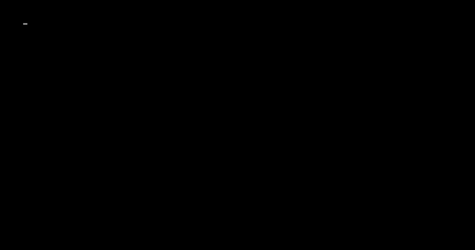

During this migration my Bazzite img file got corrupted (tried xfs_repair, no success) so I decided to start from scratch. I had backups of all config changes in Bazzite so it would not be an issue to recover, however I am unable to get the bazzite .iso to load inside a virtual machine. The VM has a GPU, NIC and some USB devices passed through. After deleting the original .img file I created a new blank raw .img and even though the GRUB menu loads, after selecting a boot option I am immediately greeted with a black screen with a non-blinking cursor as shown below. I left it on this screen for over an hour to no avail. Unraid reports 1 full core utilisation while this hangs, with no disk activity after grub.
