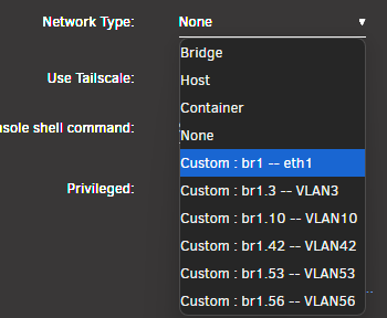

Hi, I upgraded to 7.0.0 RC2 and the update went smoothly, except for one thing I can't seem to figure out: I have multiple virtual bridge interfaces for various VLANs which all show up fine in the network overview.
However in the Docker container edit page I'm missing the last one with the highest VLAN ID (81 in this case). It was working fine using br1.81 before the update (coming from 6.12) using the same configuration.
In the container's config (under /boot/config/plugins/dockerMan/templates-user/*.xml) it's still correctly configured, meaning I can see the container in question still has br1.81 assigned as before, but I can't select it in the GUI and it also won't start as configured in the .xml, but instead shows Network: None.
Is it a coincidence, that it's the last one or does unRAID not like VLAN 81 (in this specific case) for some particular reason? I can work around the issue for now by (mis)using another VLAN with a lower ID - just curious what's happening here. Attached you'll also find diagnostics. Thanks in advance!
