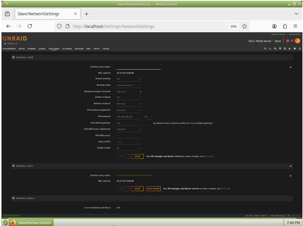

When using Unraid 7 Beta4 (or older, like 6.12) only one ethernet interface is detected - The 10gig network card.
Once RC1/RC2 is installed an additional ethernet card is detected which gets configured to ETH0 (MAC 36:2F:E6:75:BD:8B).
Unfortunately i am not really well versed in linux and can not find out for the life of me what that device actually should be.
Per default this new card is bonded with the 10gig card (which is now eth1) and i have no route to my network.
I can remove the bonding, but i get no "interface rule" to select the 10gig card as eth0 and the new device as eth1.
I would expect that if i have more than one device i would get the "interface rule" setting to show up.

Also disregard the wonky IP address in the RC2 screenshot.
I tried to properly set up the new device to my standard 192.168.1.5 IP with proper gateway/...
I simply cannot connect to it. Even stranger is that the bonding does not work where i would then connecto through eth1

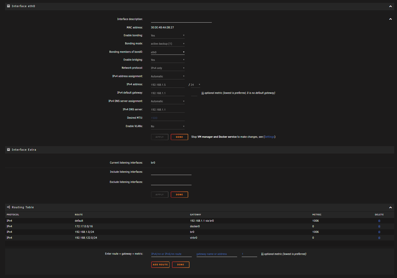

Network Settings Beta4:
Network Settings RC2 (via Unraid GUI / IPMI)
