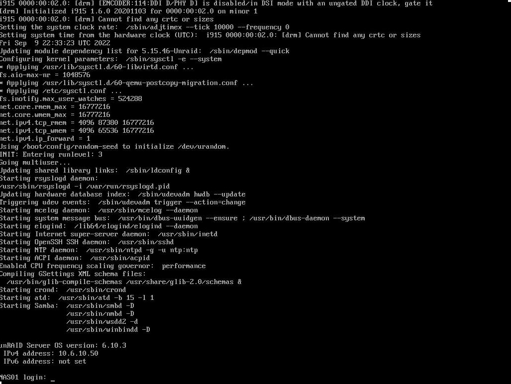

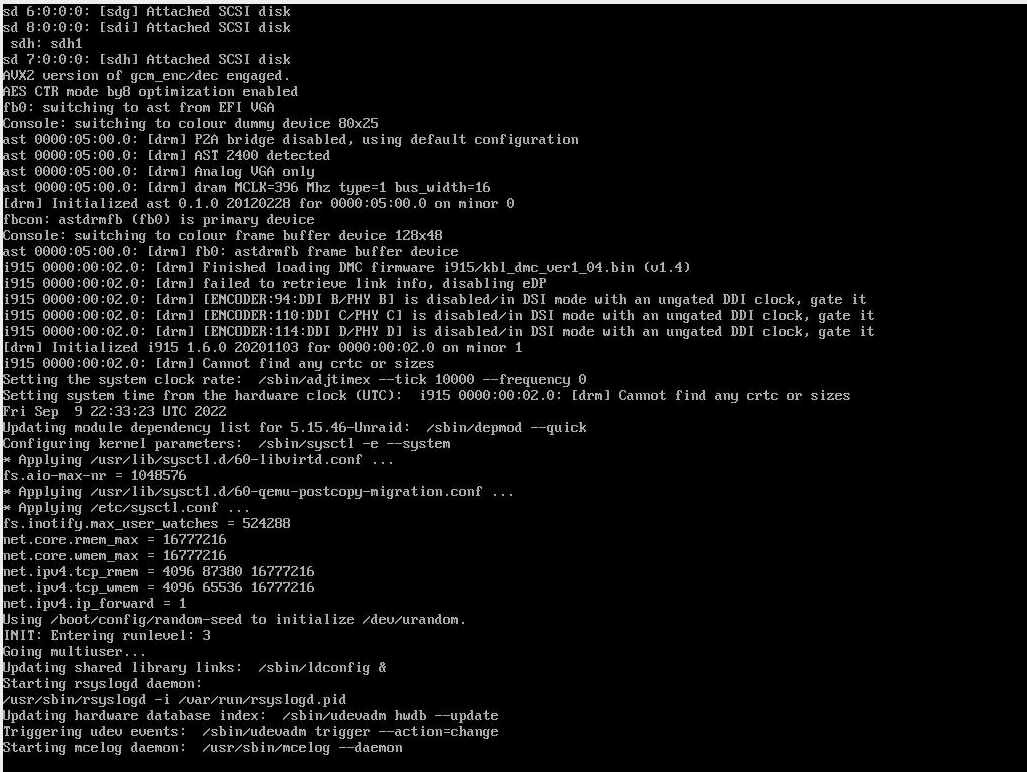

When i remove my Network-Card or Place it in the PCIe 8x Slot with 4x Lanes (Not in the x16 or x8 Slot) it Boots, but with the i915 Error. (error02.png). The Server was running for a few days and suddenly stopped working, didnt Boot, except when i removed the Network-card. After that it was running again

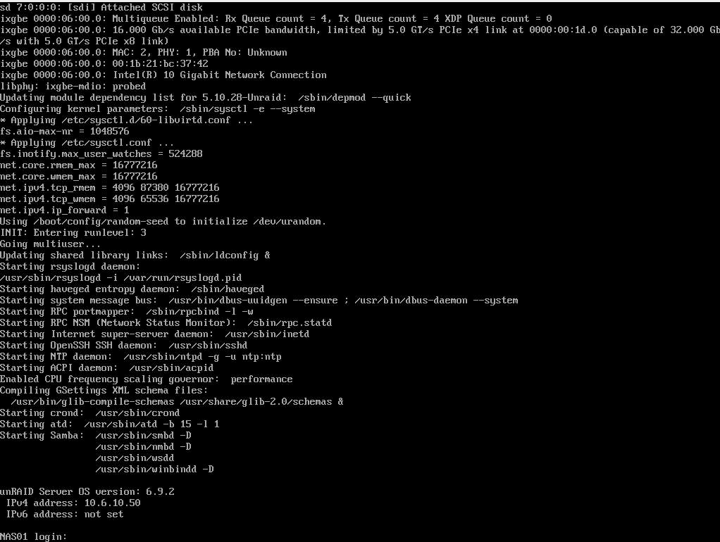

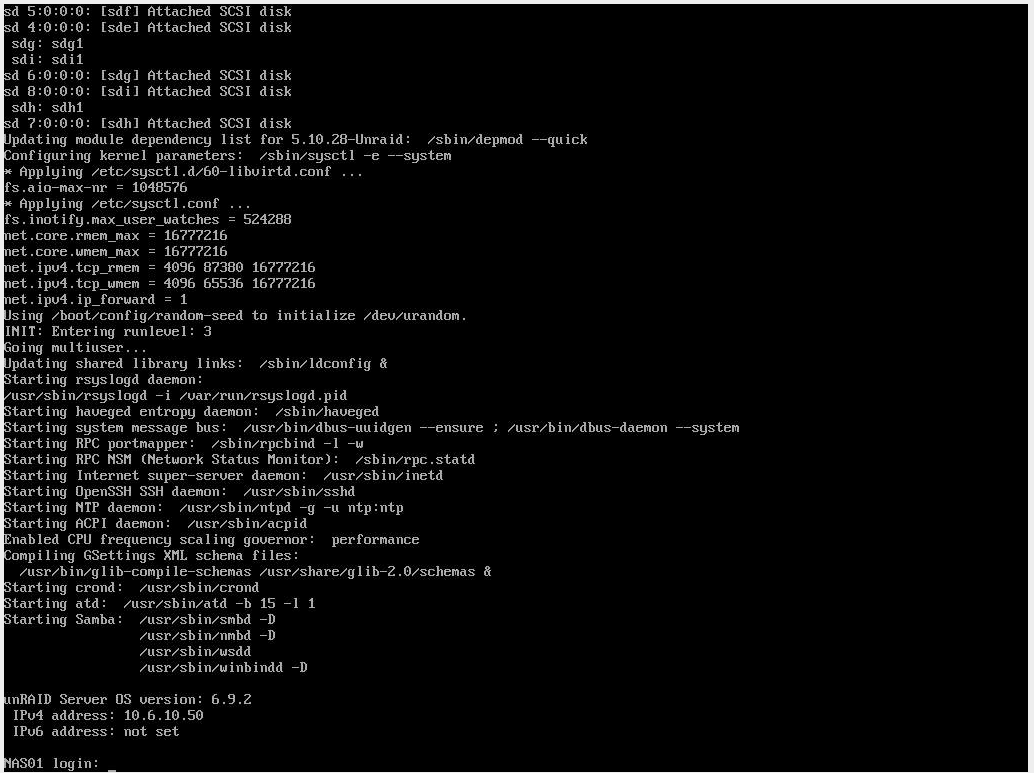

Error03.png is with the Network-card in slot x8, 4x lanes,  and error04.png is the Card in Slot x8, 8x lanes (Both in 6.9.2)
