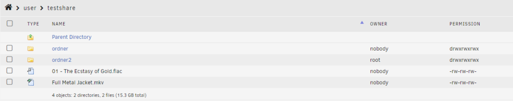

I cant see any Files and Folders on my Oppo BR Player on my unRaid 6.11.0 NFS Share.
because i cant add any Credentials on this Player i assume the rights for "other" is relevant, so i set them to rwx for testing.
The Files are Showing up perfectly on my 6.9.2 unRaid Server.
i had the same issue on my TrueNAS Server, i was able to open/connect the share but cant see anything in it. The Fix was to set the ACL for "everyone" to "read" (everyone wasnt in my ACL and i needet to set it as "inherit"
Now i can see all files on that Server like on my 6.9.2 unRaid Server.
The Issue shouldnt be nfsV4, that works fine from my TrueNAS Server, so it should be fine for unRaid aswell.
So i think the issue is, there are missing right on the files and folders.
The Screenshot is from the 6.11.0 Server
