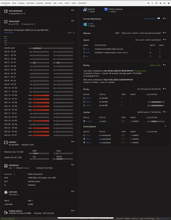

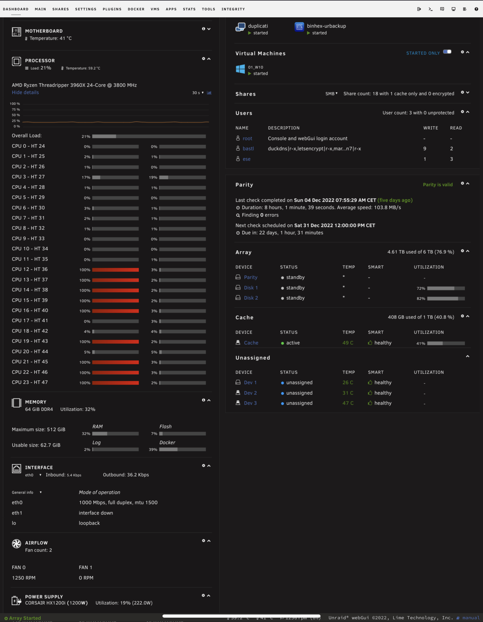

Hi guys,
almost 2 weeks now with 6.11.5 and I got a couple of freezes/crashes of one of my servers. I skipped the first couple 6.11.xx releases and directly upgraded from 6.10.3 to 6.11.5. So far so good. After 2-3 days I found my main server unaccessible in the morning. Main VM with GPU passthrough, idle over night, didn't show any output in the morning and webui also wasn't reachable at this point. SSH access also not possible.
Force restart the server and everything worked as usual for another couple days until it crashed again. No access. I than started to log the syslog to my other server and let it run. Now 5 days later I found my main VM again not accessible. The webui was reachable, almost half of the isolated cores from the VM maxed to 100%

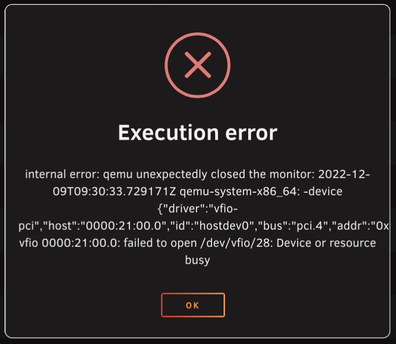

Restarting the VM didn't work and I had to force shutdown it. Starting it up again brought the following error:
Looks like the GPU wasn't reset correctly and I had to restart the whole server again. Navigation in the webui also seemed a bit slow and unreliable. I didn't pulled the diagnostics at this point. Looks like something crashed yesterday evening. Syslog showed the following:

I found a couple reports from users using some torrent dockers with some similar freezes which I can kinda exclude. The only dockers I run on startup are duplicati and binhex-urbackup which basically do nothing when the server crashes. Scheduled backup jobs don't overlap with the server crashing. At least not with the last 2 crashes today. Such crashes and freezes never happened before to the server. Nothing changed software or hardware wise. It all started with the upgrade from 6.10.3 to 6.11.5.
Maybe someone can have a look into the syslog and the diagnostics and can point me in the right direction to fix this.
Thanks
