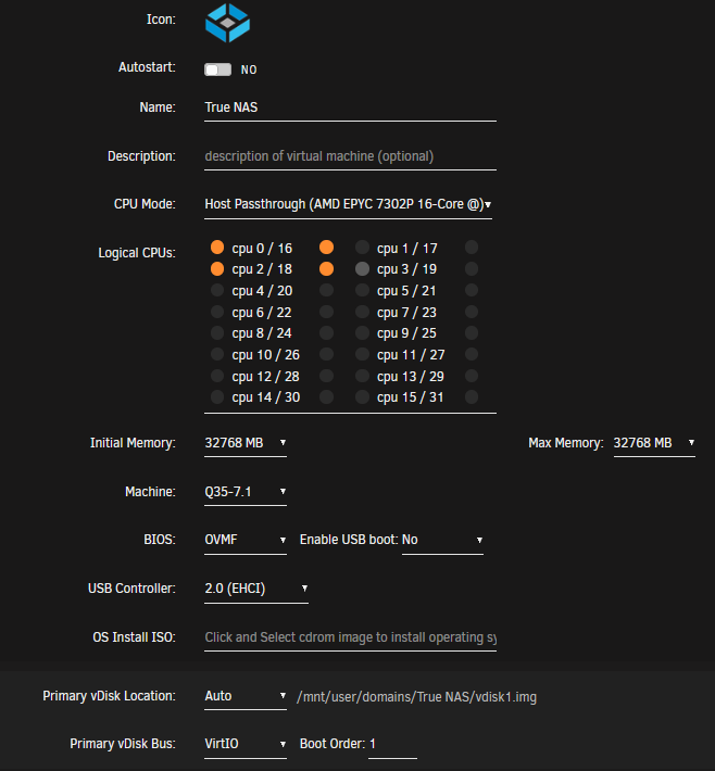

  • I tried to create a TrueNAS VM in order to have access to ZFS and easier iSCSi
  • It is well known that it is better to pass through a host controller as apposed to devices (be it USB, SATA, etc.)
  • I tried TrueNAS core and TrueNAS scale (FreeBSD and Debian respectively)

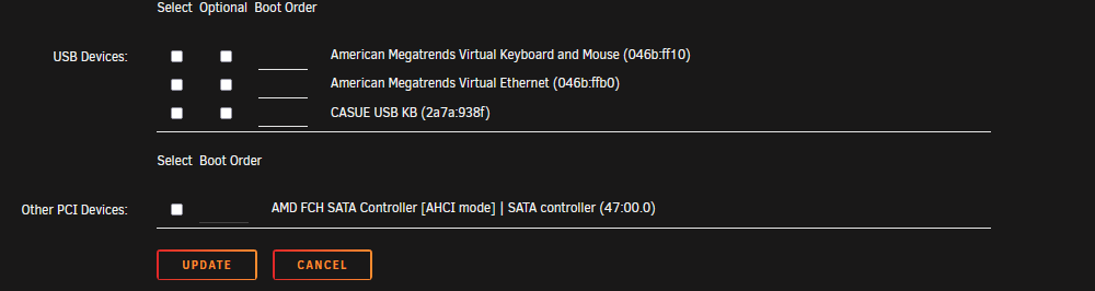

  • How ever I could not get the VM to start even to install the OS, this would also cause my whole server to crash requiring a hard reset.
  • when I detached the SATA controller it would post

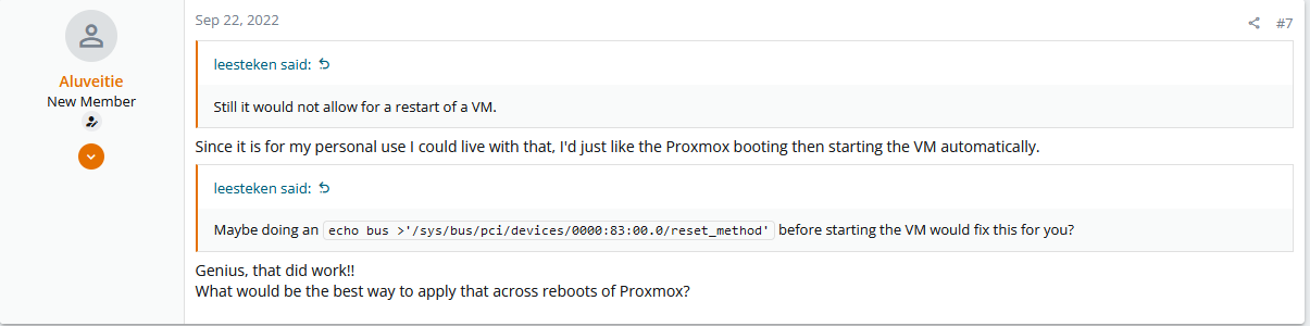

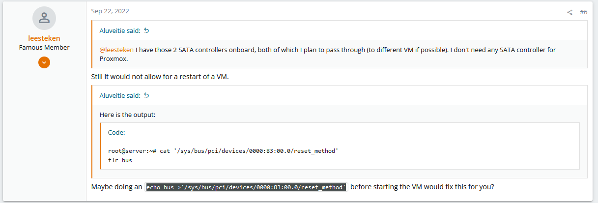

I saw that someone running Proxmox had this same issue:
https://forum.proxmox.com/threads/passthrough-of-onboard-sata-controller-locks-up-system.115569/
https://forum.proxmox.com/threads/amd-epyc-pcie-passthrough-flr-error.106070/#post-456481
I used their work around as a fix

(punching this into my Unriad terminal: "echo bus >'/sys/bus/pci/devices/0000:47:00.0/reset_method'")

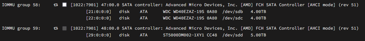

But it does with a TrueNAS VM and with the the "AMD FCH SATA" controller.
