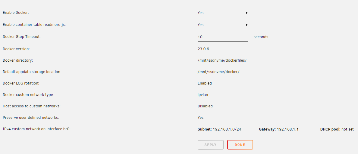

Sorry for the "light report", but I cannot replicate and provide diagnostics at this time. I have 3 Unraid servers, and I have migrated 2 to 6.12 so far. On both of those migrated servers, I experienced a loss of internet access (LAN works just fine) 3 or 4 mins after the array start; it is hard to diagnose the why because the situation doesn't leave any traces on the logs or diagnostics files as far as I was able to check.
By trial and error, I have come to the conclusion that the culprit is the "Host access to custom networks" setting on the docker config. Despite that, I had the config set to enabled, but I wasn't using it. Once I stopped the array and set the config to Disable, I stopped experiencing the loss of internet access.
My current config is the following; the only difference with the previous one is the setting already mentioned:
