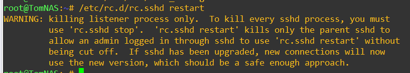

/etc/rc.d/rc.sshd restart --->  Restart the SSHD service (reload has the same effect)
2024-05-2409_04_55-mRemoteNG_-_confCons.xml_-_TomNAS(mRemoteNG).png.15f04076c08be12ef937595a5917beef.png
nano /etc/ssh/sshd_config  --->  Open the config file again to see that my config has been erased.
2024-05-2409_05_19-mRemoteNG_-_confCons.xml_-_TomNAS(mRemoteNG).png.31a58ffba56a93f1c9b70599bc5c3974.png

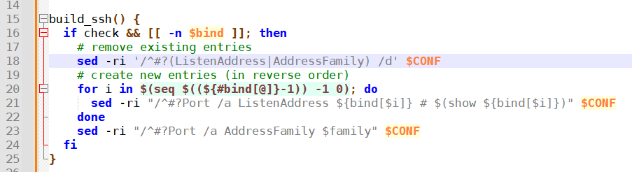

I have inspected the /etc/rc.d/rc.sshd script which contains this comment (no date/timestamp)
# bergware - added interface bind functionality
Looking at line 18 and 21 the ListenAddress is removed and re-added using the "bind" array however I cannot tell where that bind array is being populated from.
