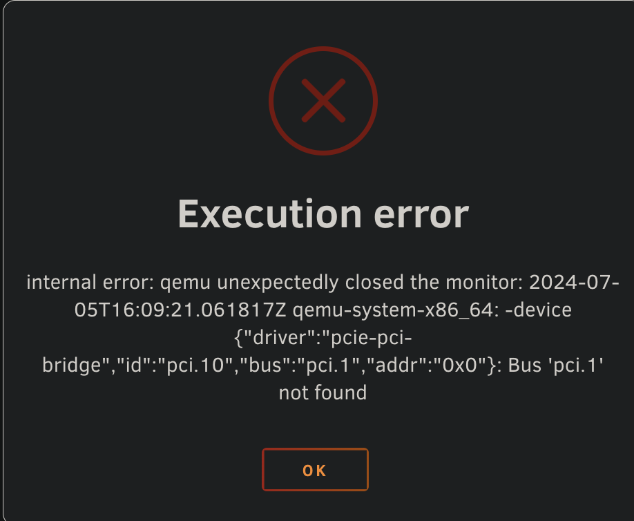

There seems to be a issue on 6.12.10 when you create a Q35-7.2 VM and assigning a GPU to it. If you remove the GPU afterwards and change it to a virtual Display, the machine no longer works. This is also vice versa! The VM will not boot at all.
After some testing I can conclude this is not always happening. Sometimes there is nothing wrong, and otherwise the VM won't boot.

- Stop the VM (Probably forcefully because it wont boot because of this issue)
- Edit the VM and remove the GPU and assign the graphics "Virtual" back.

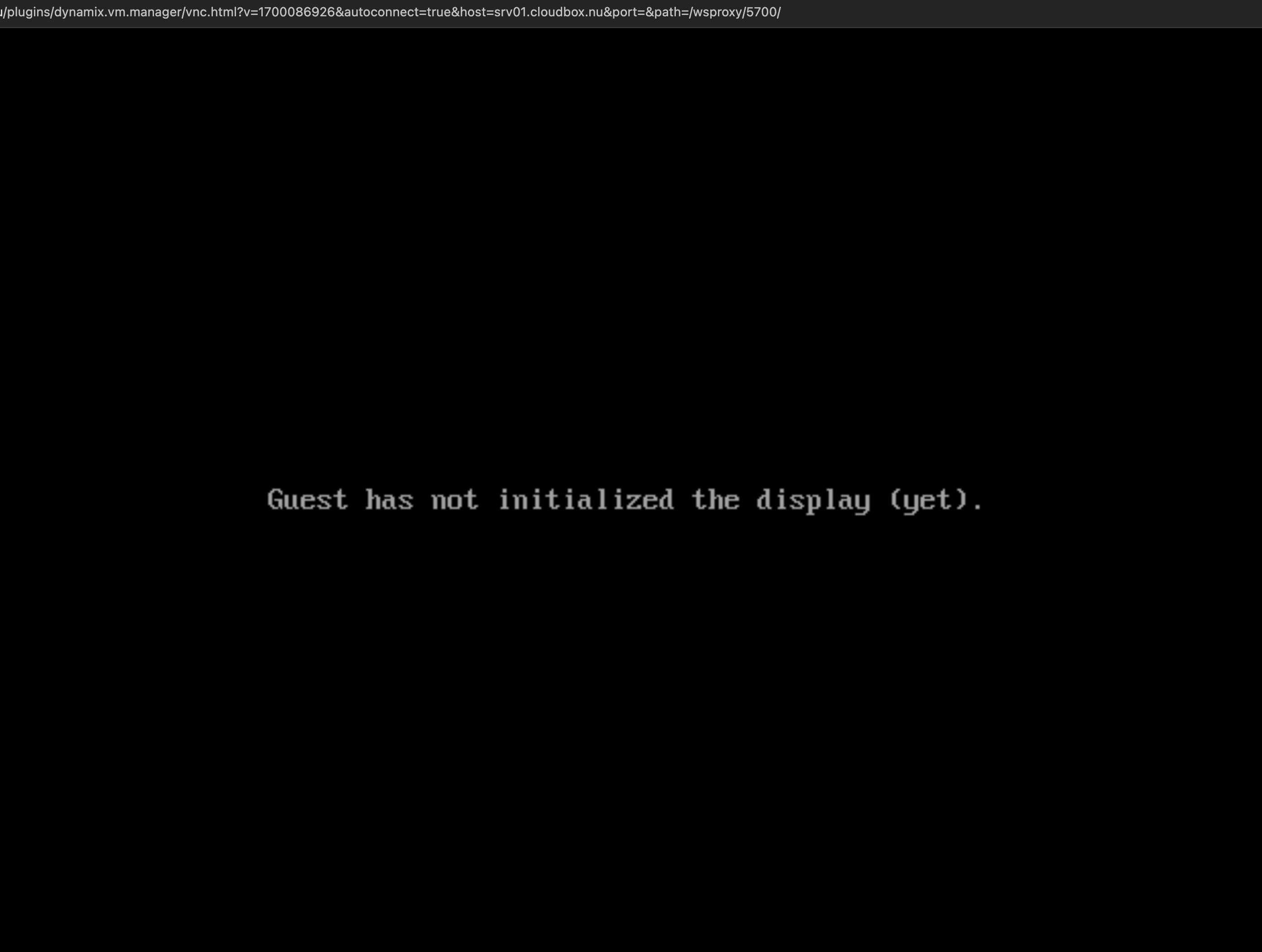

- Start the VM
- The VM is no longer working (Guest has not initialized the display yet)

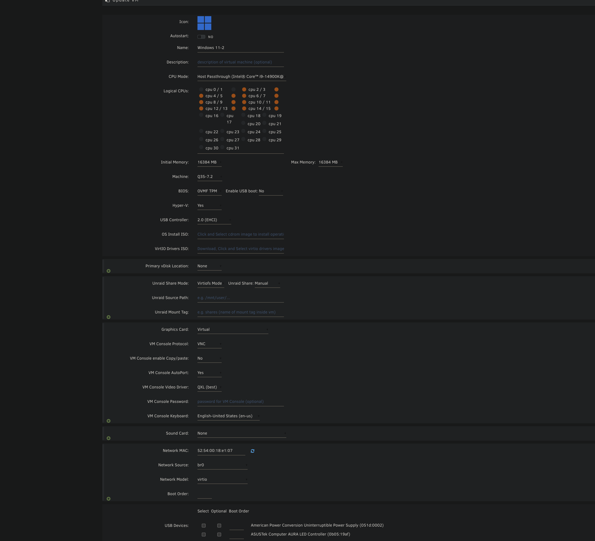

Questions about settings? See my screenshot for the config:
