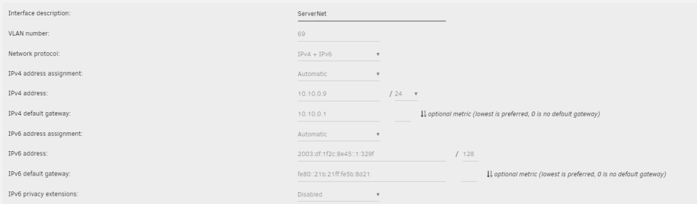

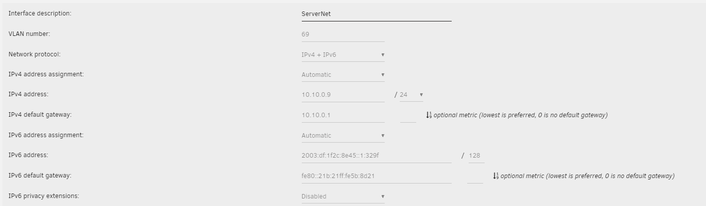

I have my addresses to my IPv6 dockers assigned, Unraid showed them in the docker-settings page, and they are enabled, yet in the container Settings they are not showing up as they did with version. 6.12.2!
Unraid Network Settings of the Interface

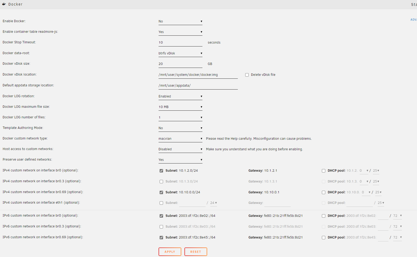

Docker Settings Page

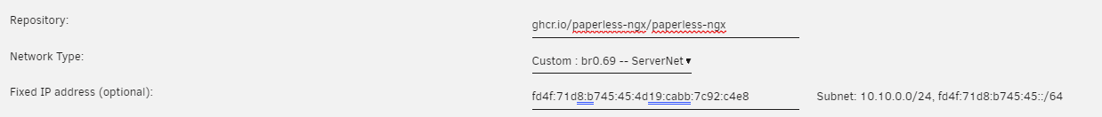

Now I rolled back to 6.12.2 because I didn't want to change my configuration to IPv4! Here everything works as expected.
Here how the container settings should look like! I have a additional Unique Local Address-Network announced for static addressing within my homenet.
