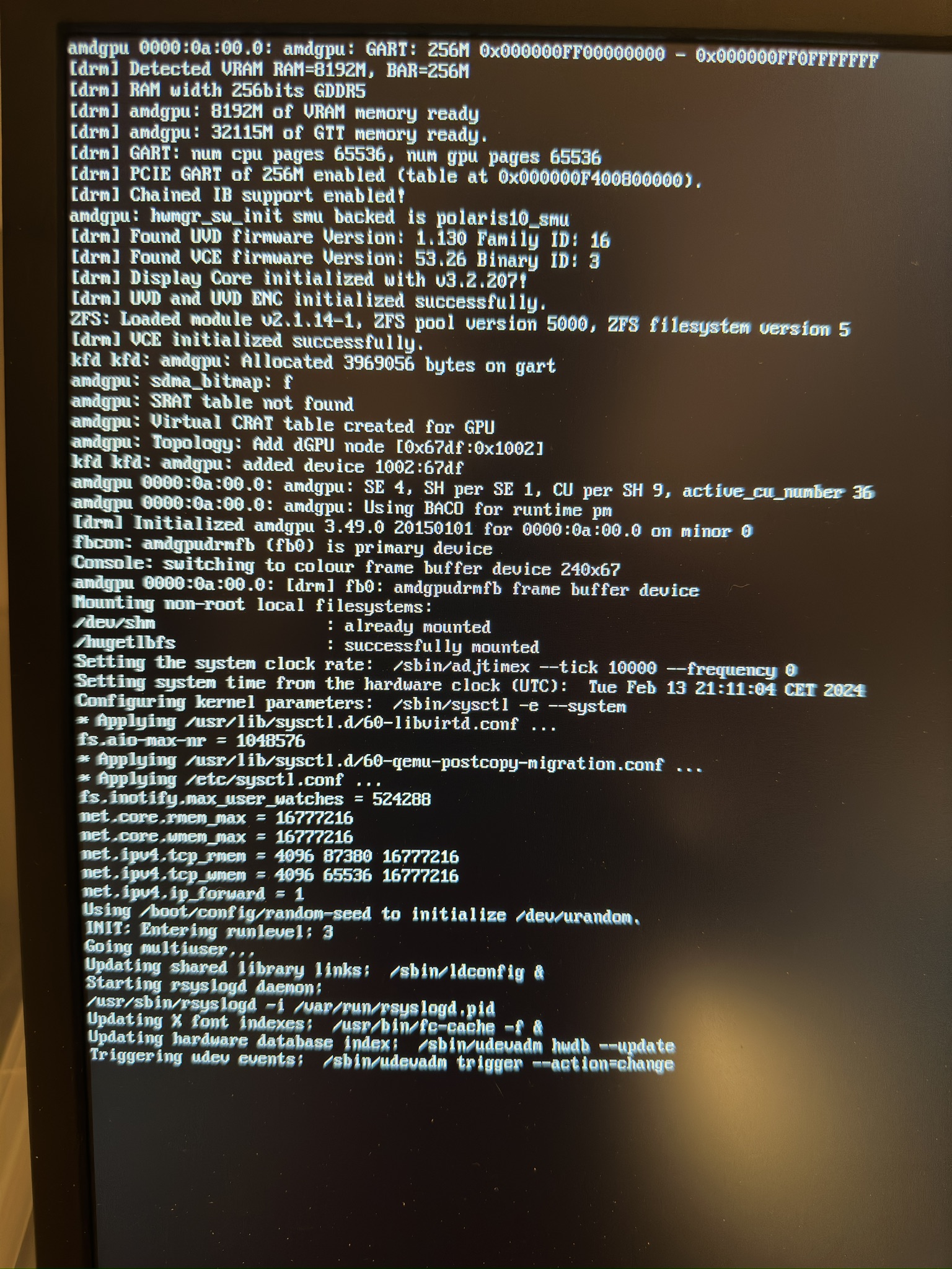

- Screenshot of the terminal output when the system hangs
andgpu 0000:0a:00.0: amdgpu: GART: 256M 0x000000F00000000 - 0x000000FFOFFFFFFF
Carm] Detected VRAM RAM=8192M, BAR=256M [drm] RAM width 256bits GDDR5
[drm] andgpu: 8192M of VRAM memory ready [drm ]
andgpu: 32115M of GTT memory ready.
Ldrm]
GART: num cpu pages 65536, num gpu pages 65536 [drm] PCIE GART of 256M enabled (table at 0x000000F400800000).
Idrm] Chained IB support enabledt
andgpu: hungr sw_init smu backed is polaris10_smu [drm] Found UVD firmuare Version: 1.130 Family ID: 16
[arm] Found UCE firmuare Version: 53.26 Binary ID: 3 [drm]
Display Core initialized with u3.2.2071
Larm too and tob enc initialized successfully.
275: Loaded module U2.1.14-1, 2PS pool version 5000, 2FS filesystem version 5 [drm] VCE initialized successfully.
kfd kfd: andgpu: Allocated 3969056 bytes on gart andgpu: sama_bitnap: f andgpu: SRAT table not found
andgpu: Virtual CRAT table created for GPU andypu: Topology: Add AGPU node [0x67df:0x1002] kfd kfd: andgpu: added device 1002:67df
andgpu 0000:0:00.0: andgpu: SE 4, SH per SE 1, CU per SH 9, active cu number 36 andypu 0000:0a:00.0: andgpu: Using BACO for runtime
Carm] Initialized andgpu 3.49.0 20150101 for 0000:0a:00.0 on minor 0 fbcon: andgpudrfb (fbO) is primary device
Console: switching to colour frame buffer device 240x67 andypu 0000:0a:00.0: [drm] fbO: andgpudrmfb frame buffer device
Mounting non-root local filesystems:
/ deu/shn
: already mounted
huget Ibfs
: successfully mounted
Setting the system clock rate:
/sbin/ad jtimex -tick 10000 --frequency 0
Setting systen time fron the harduare clock (UTC): Tue Feb 13 21:11:04 CET 2024
Configuring kernel parameters:
/sbin/sysctl -e --system
* Applying /usr/lib/sysctl.d/60-libuirtd.conf ...
ts.aio max-mr = 1048576
* Applying /usr/lib/sysctl.d/60-gemu-postcopy-migration.conf ...
*Applying /etc/sysctl.conf
Is.inotify.max_user watches = 524288
net.core.rmem_max = 16777216
net core.umem_max = 16777216
net, iput.top_rmem = 4096 87380 16777216
net, pus, tcp-smem = 4096 65536 16777216
net, iput, ip forward = 1
Using boot/config/random-seed to initialize /dev/urandom.
INIT: Entering rulevel: 3
Going multiuser,..
Updating shared
Library links: /sbin/Idconfig &
Starting rsysloga daemon:
ust/sbin/rsyslogd -1 /var/run/rsyslogd.pid
Updating X font indexes; /usy/bin/fc-cache -f& Updating hardware database index:
sbin/udevadm hudb --update
Triggering udeu events: /sbin/udevadm trigger -action=change

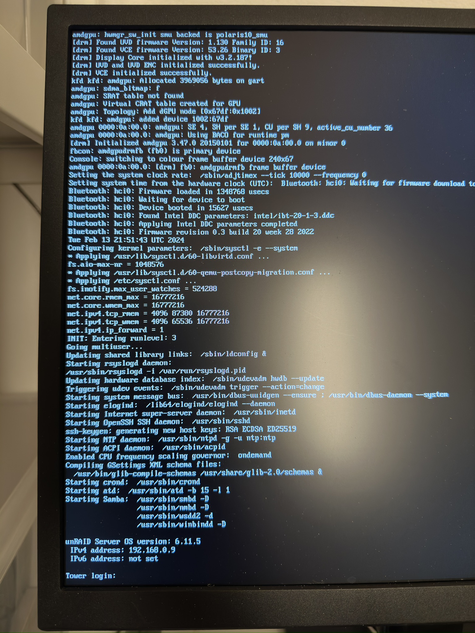

- Screenshot of successful passage at version 6.12.4
คห Fo แบ้า (ruare Uers ton: 1.700 Fantly D: 16
Carm] Found VCE firmuare Version: 53.26 Binary ID: 3
Carm] Display Core initialized with 03.2.1871 [drm] UVD and UVD ENC initialized successfully. kha do it ia sued full bytes on gart
andgpu: sana_bitmap: f andgpu:
andgpu: Virtual CRAT table created for GPU andgpu: Topology: Add AGPU node COx67df:0x10021 kfd kfd: andgpu:
added deuice 1002:674F
andgpu 0000:0a:00,0: andgpu: S6 4, SH per SE 1, CU per SH 9, active_ou number 36 andgpu 0000:0a:00.0: andgpu: Using BACO for runtime pm
Carmi Initialized andgpu 3.47.0 20150101 for 0000:0a:00.0 on minor o fbcon: andgpudrfb (FbO) is primary device
andgpu 0000:0a:00.0: [drm] fbo: andgpudrmfb frame buffer device
/sbin/adjtimex -tick 10000 -frequency o
Setting
time from the harduare clock (UTC): Bluetooth: hcio: Waiting for firmare download t
Bluetooth: hcio: Firmware loaded in 1348768 usecs
Bluetooth: hcio:
Waiting for device to boot
Bluetooth: hci®: Device booted in 15627 usecs
Bluetooth: hciO: Found Intel DDC parameters: intel/ibt-20-1-3.dde
Bluetooth: hci®: Applying Intel DDC parameters completed
Bluetooth: hci0: Firmuare revision 0.3 build 20 week 28 2022
Tue Feb 13 21:51:43 UTC 2024
fs.aio-max-ar = 1048576
= Applying /usr/lib/sysctl.d/60-gemu-postcopy-migration.conf ...
* Applying /etc/sysctl.conf fs. inotify.max_user_watches
net.core.rmem max = 16777216
net.core.unem_max = 16777216
net.ipu4.tcp_rmem = 4096 87380
net.iput.tcp_umem = 4096 65536 16777216
net.iput.ip_forward = 1
INIT: Entering runlevel: 3
Going multiuser...
Updating shared
links: /sbin/ldconfig &
Starting rsyslogd daemon:
/usr/sbin/rsyslogd -i /var/run/rsyslogd.pid
Updating harduare database index:
/sbin/udevadm hudb --update
Triggering udev events:
/sbin/udevadm trigger --action-change
Starting system message bus: /usr/bin/bus-uuidgen -ensure : /usr/bin/dbus-daemon -susten
Starting elogind:
/1ib64/elogind/elogind --daemon
Starting
Internet super-server daemon: /usr/sbin/inetd
Starting OpenSSH SSH daemon:
/usr/sbin/sshd
ssh-keygen: generating new host keys: RSA ECDSA
Starting NIP daemon:
/usr/sbin/ntpd -g -u ntpintp
Starting ACPI daemon: /usr/sbin/acpid
Enabled CPU frequency scaling governor:
ondemand
Compiling Settings XML schema files:
usr/bin/glib-compile-schemas /usr/share/glib-2.0/schemas &
Starting crond; /usr/sbin/crond
Starting atd;
/usr/sbin/atd -b 15 -1 1
Starting Samba:
/usr/sbin/smid -)
/usr/sbin/nmbd -D
/usr/sbin/usdd2 -d
/usr/sbin/winbindd -D
unRAID Server 08 version: 6.11,5
IPu address: 192.168.0.9
IPu6 address: not set
Tower login:
