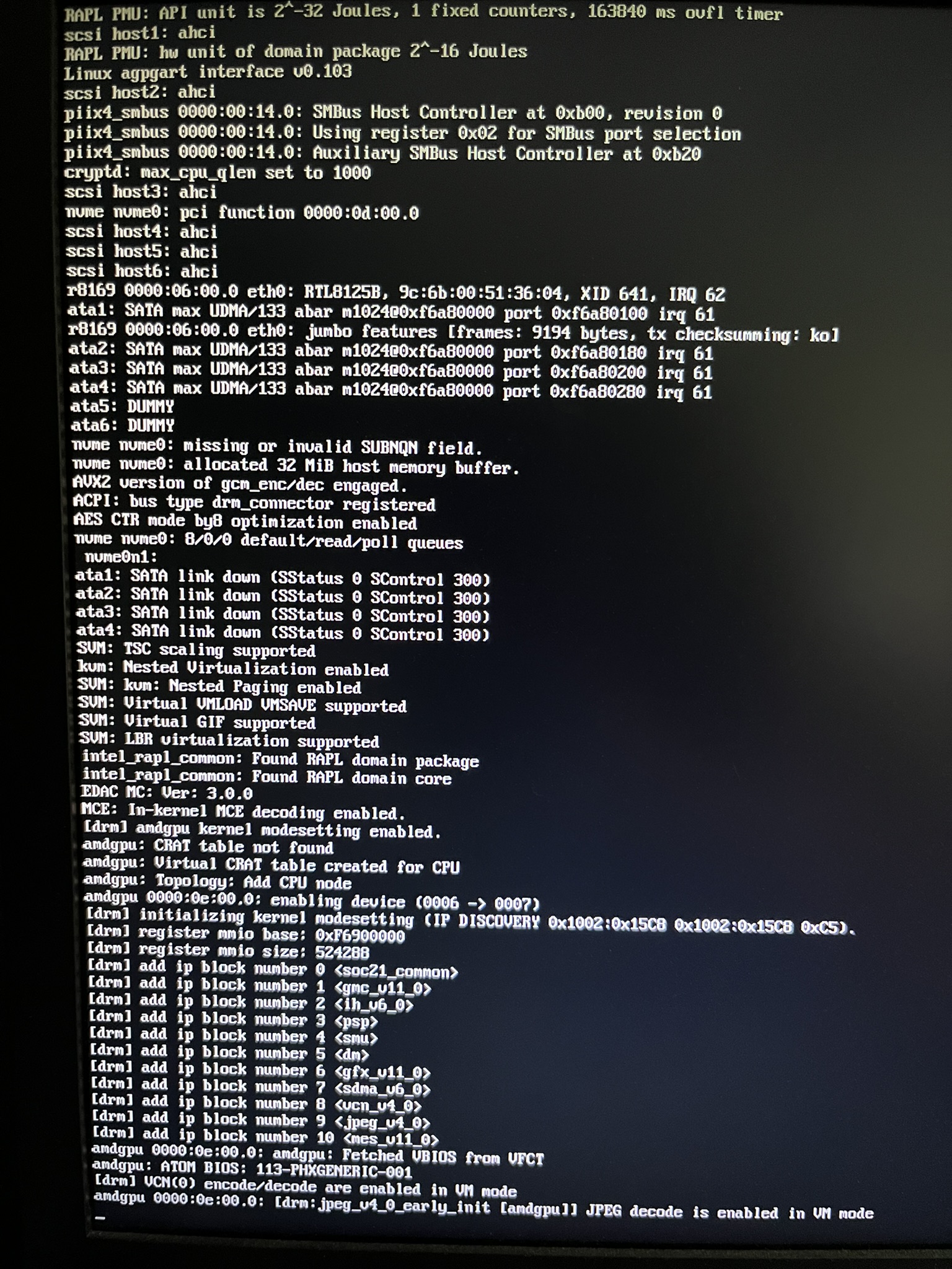

I´m new here and tried to install and configure my first Unraid Server. Unfortunately the boot process always stops at the same point, while starting in the newest version 6.12.8 from the Unraid webiste:
"amdgpu 0000:0e:00.0: [drm:jpeg_v4_0_early_init [amdgpu]] JPEG decode is enable in VM mode"

The boot process doesn't look like it's getting an error to me, but I may be missing something (see attached picture).

On the screen it stops at:
"amdgpu: Topology: Add CPU Node"
