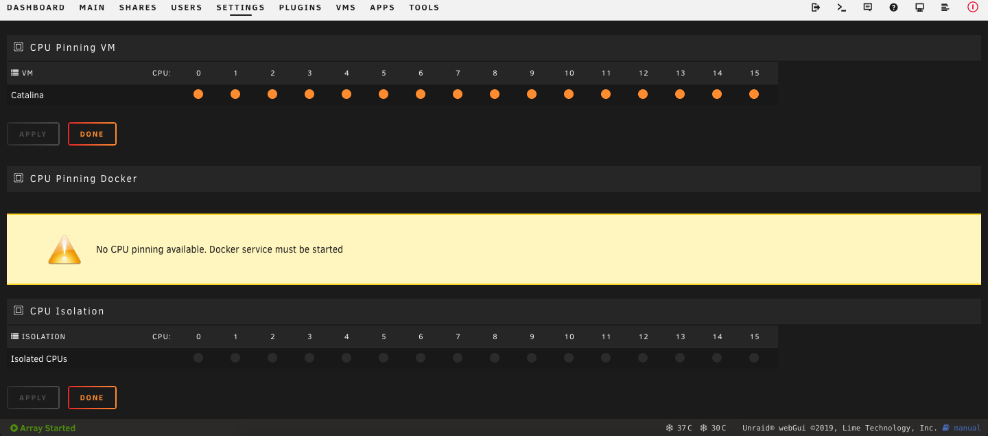

2- Unraid webUI: Settings-->CPU pinning--> CPU pinning VM: all cores are selected:

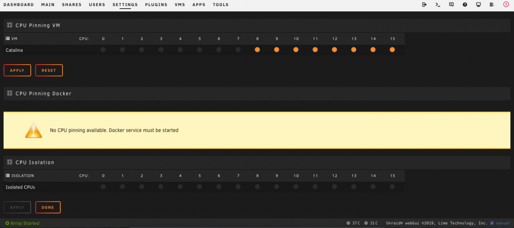

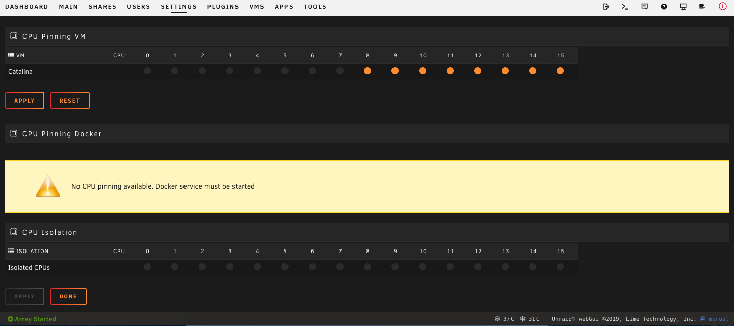

3- Deselect some cores (in my example cores 0-7 are deselected):

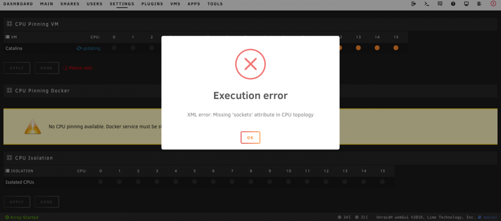

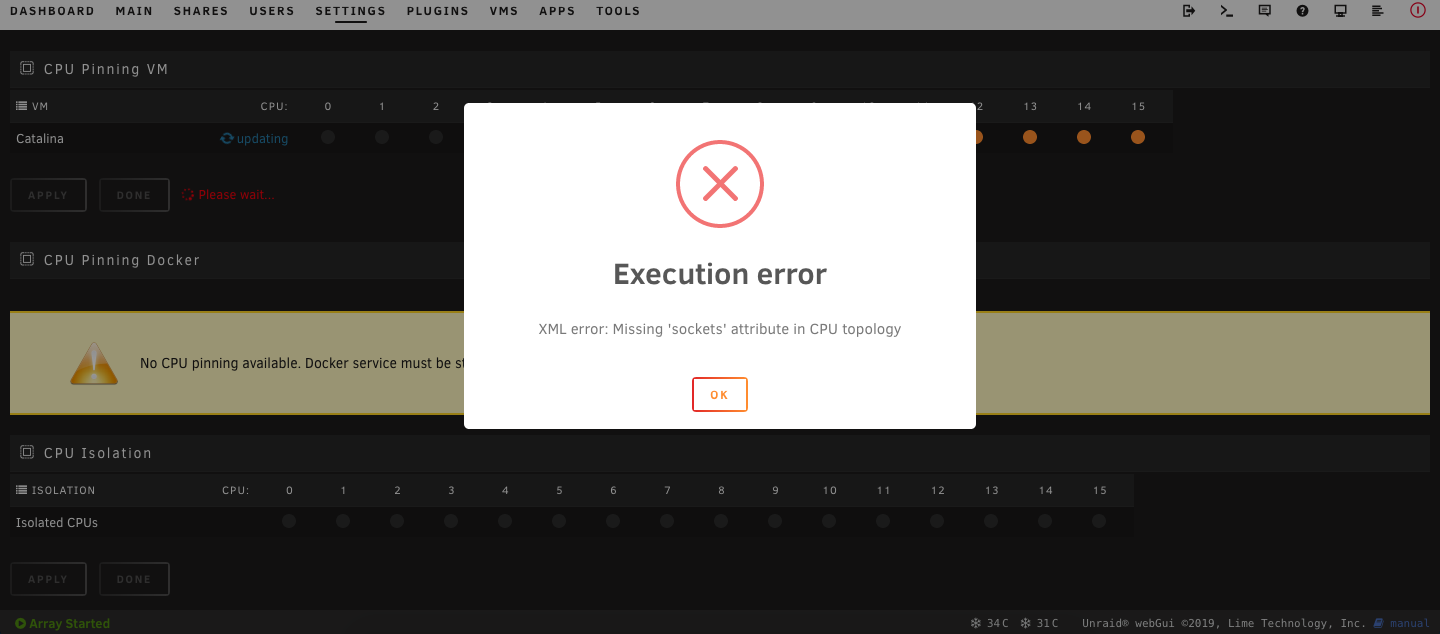

4- Click apply: error "missing sockets attribute in cpu topology" pop up:
5- Click OK

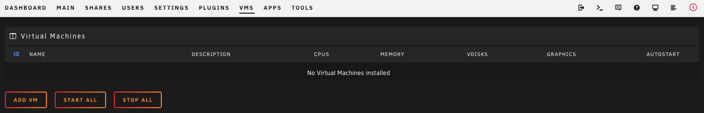

6- in Unraid WebUI go to VM: you can see that the VM template has been deleted (luckily disks are in their places)
