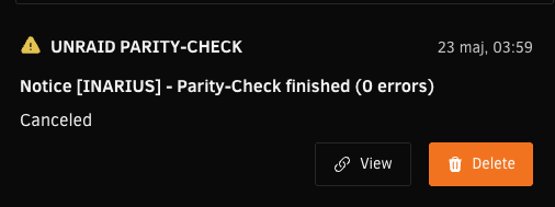

I have noticed a strange issue with notifications. Yesterday, my server had an unclean shutdown due to a power outage. After the server came back online, it started the usual parity check. It finished successfully, and no issues were found, but the notification shows that the Parity Check was "Cancelled":

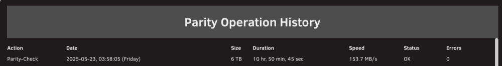

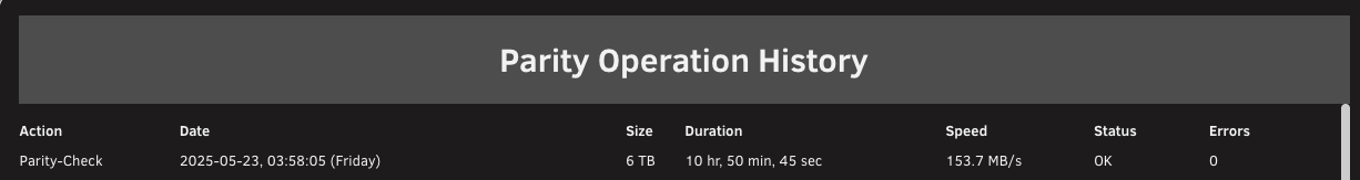

At the same time, the Parity Check history shows that everything went fine:
Attached syslog and screenshots.
