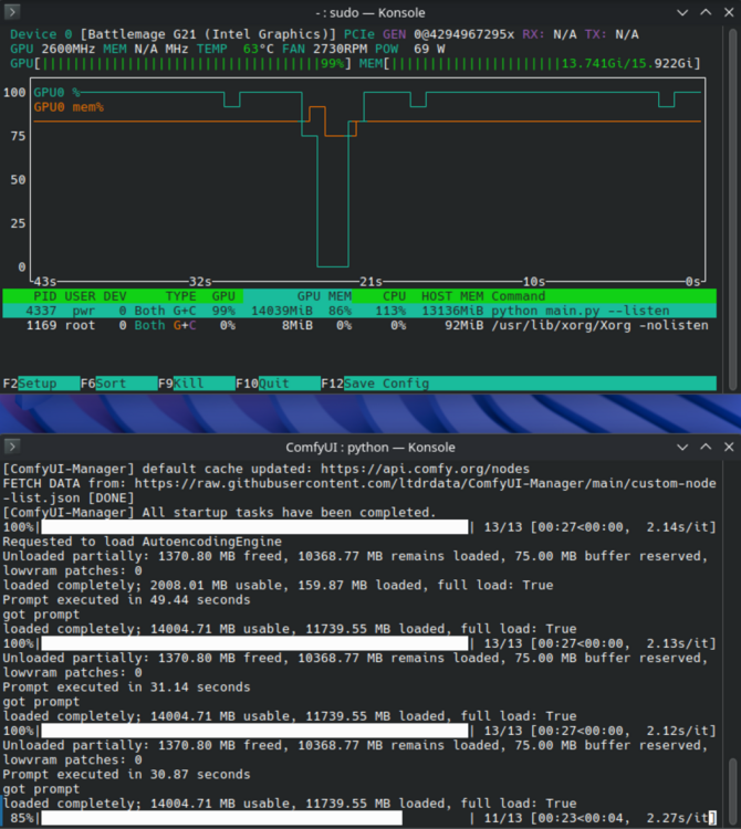

Since the update to Version 7.2.3 my discrete Intel B50 GPU only works with around half the power (35-40 Watt) and seems to throttle around 60 degrees, which could explain the power loss. Before the Unraid OS-update, the temperatures were around 68 degrees and the power consumption was 70 watts.
I changed nothing (no gpu driver update / no bios update / no change in anything) expect of the Unraid OS-update, tried several VMs (Ubuntu / Win Server 2022) which all worked with full power (70 Watts) on 7.2.2 and now throttle at 60 degrees wit a power consumption around 35-40 Watt.
The GPU is used for AI-Workloads (Ollama / ComfyUI) and added to the VM via the add GPU Option in the VM settings.
