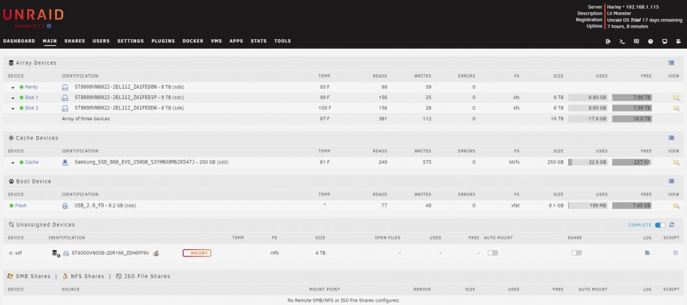

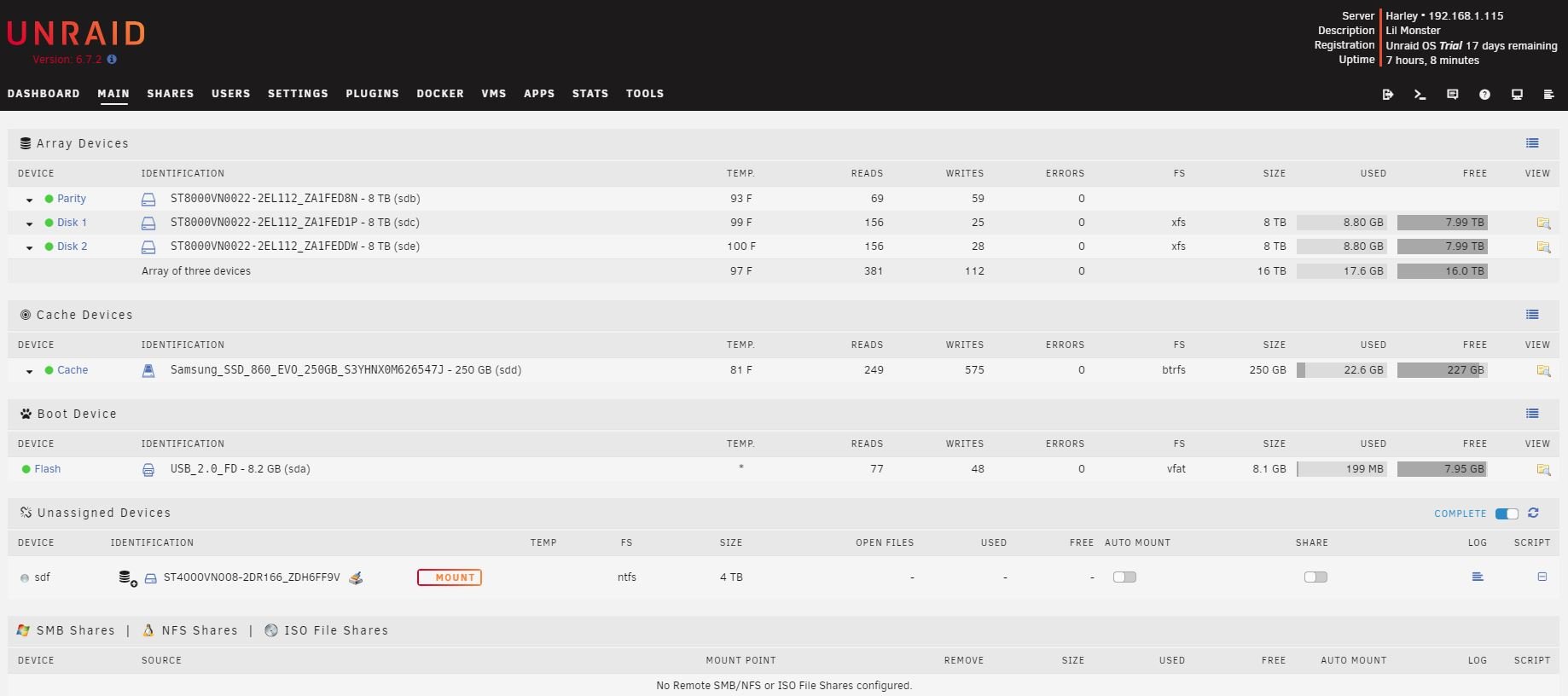

Added another drive into an available drive bay but the drive does not show up in Unassigned_Devices. (see 1st image)

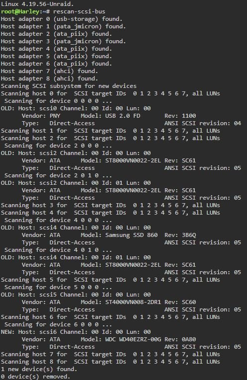

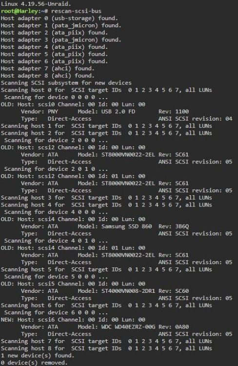

Rescaned from terminal:  rescan_scsi_bus (see 2nd image)

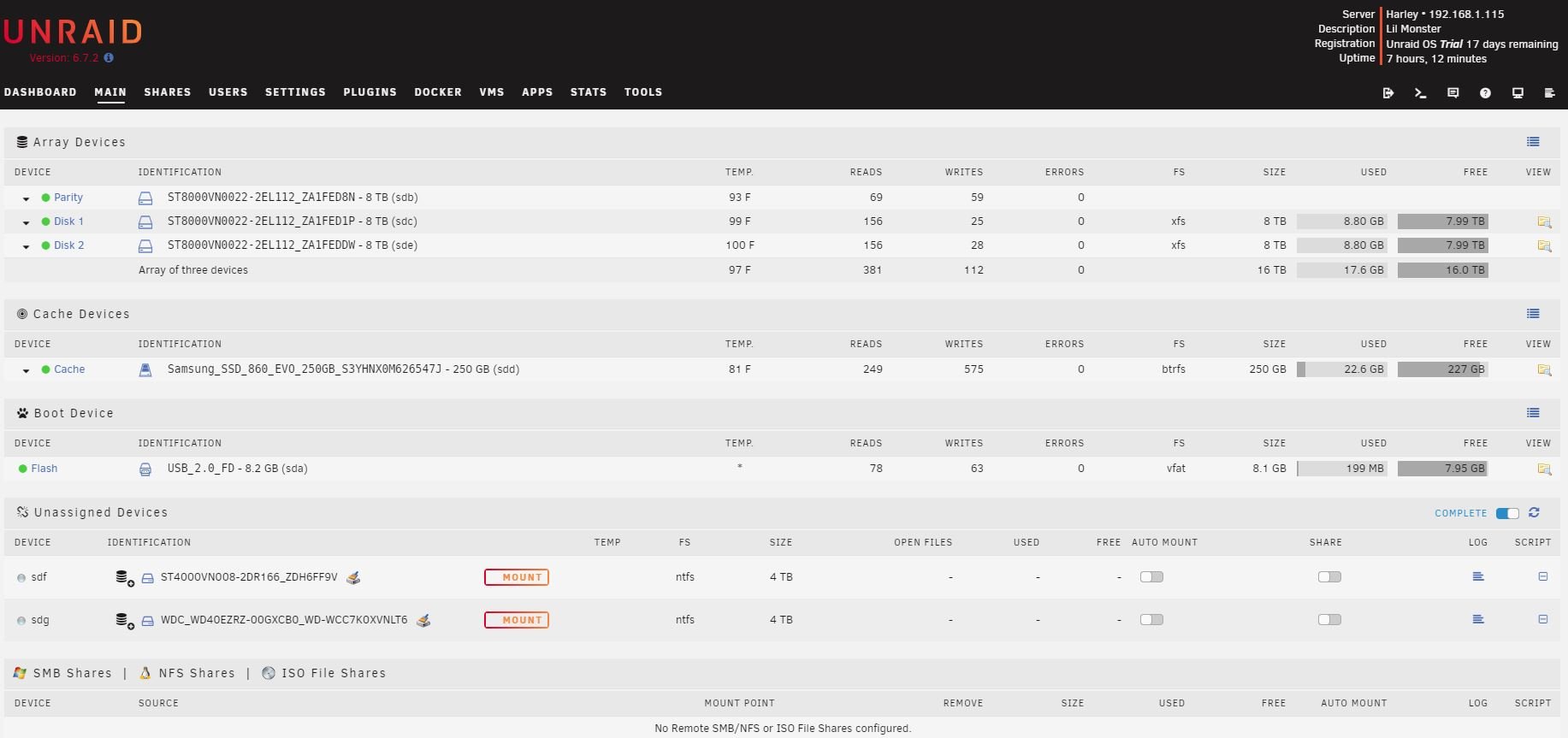

Drive now shows up as an Unassigned_Device (see 3rd image)
