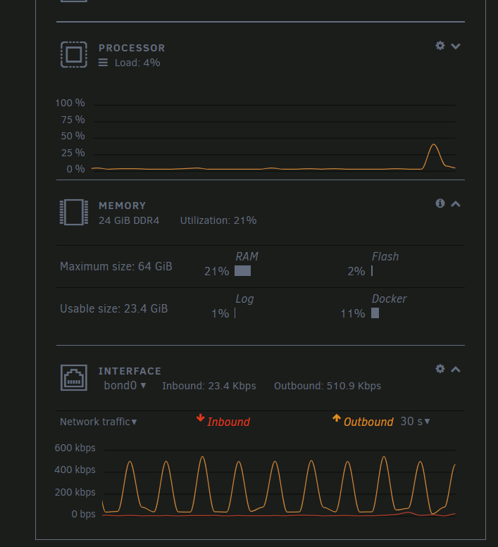

I think I've found a bug, but would like to see if I'm the only one experiencing the issue: The "network load" bar in the dashboard is always sending stuff.
This is very unusual to me, since I'm working in Cybersecurity and that's a real good indication for infection.
So, after a ( not so-) little heart attack, I started digging:
I first noticed it about a week ago with an older vertion ( 6.10.X ) and it's still happening with 6.11.1.
I have made sure it's not an application or a service using some basic bash commands, before it occured to me that the hard-working errors-counter is probably the most unusual thing with my server.

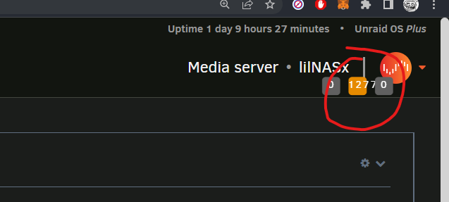

It's funny but I'm getting many "udma crc error count" notifications. about 2 per minute.

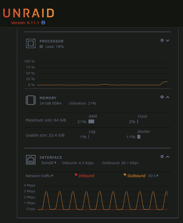

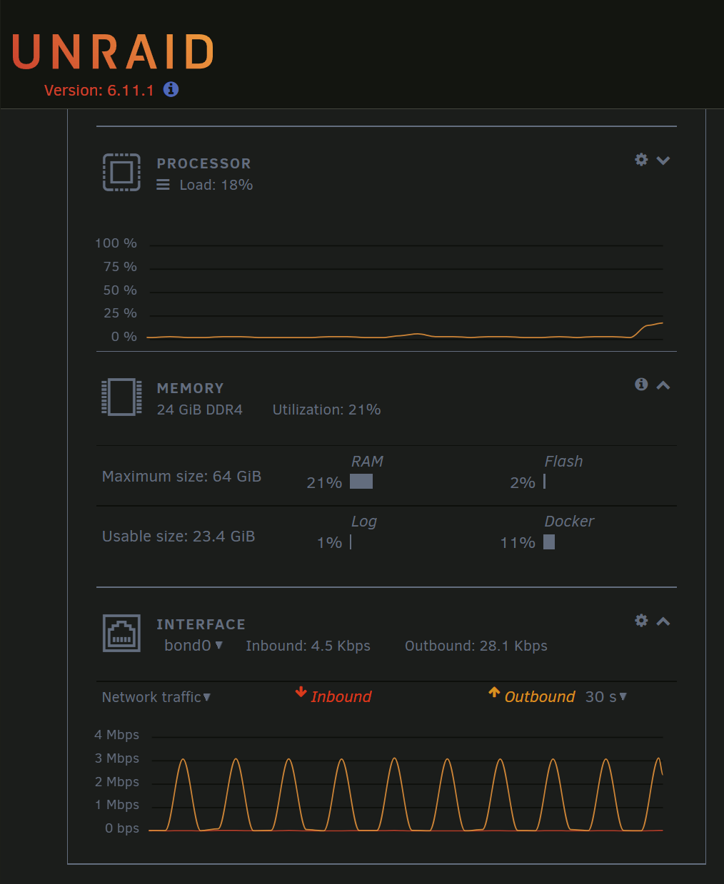

That's making the errors counter at the top right to grow, and after a few hours, it starts to use the outbound interface for some reason.
With 200 notifications I'm reaching about 500-600Kbps peaks and it may raise to 10Mbps for 2000.
I do not know if that's happening 24/7 or only when I'm logged-in to the GUI ( so, if I close the GUI, will it still move that much data? )
YES, I know I can disable the check -- but should an error-list be sent every 2 seconds?
Has anyone heard of anything like it? Do you think that's the expected behaviour for the process?
It's kinda hard to google something like that haha
Attaching some pictures of the usage, diagnostics before and after clearing the notifications feed and a video to show the problem
