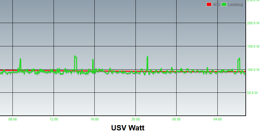

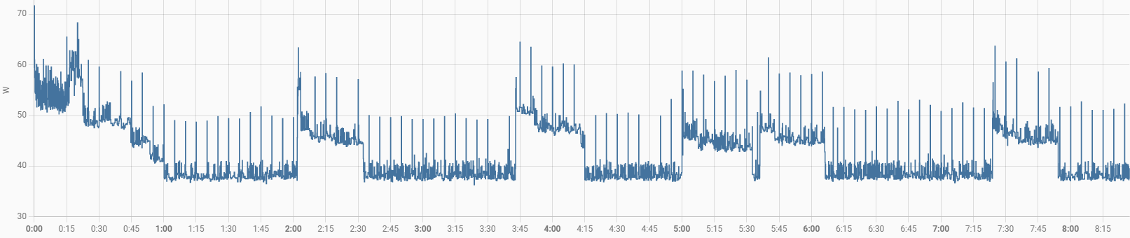

Multiple users reported spikes in their power consumption after updating to Unraid 6.10 and this is still present in Unraid 6.11:
https://forums.unraid.net/topic/105909-mein-10-zoll-server/?do=findComment&comment=1143526
https://forums.unraid.net/topic/108966-strom-sparen-mit-powertop-stromverbrauch-von-unraid-verbessern/?do=findComment&comment=1177306
image.png.3c3dc563e1bae7ad7d560a5e30e4d4fd.thumb.png.ba7d1fbf370c2b565f849f92e61b25ad.png
https://forums.unraid.net/topic/105909-mein-10-zoll-server/?do=findComment&comment=1176094

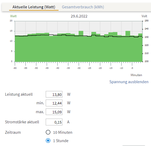

In Unraid 6.9 the power consumption was relatively stable. Example:
I will try to monitor the processes on my test server, which uses Unraid 6.11.1. Hopefully I can find out which process causes those spikes. I will update this bug report later...

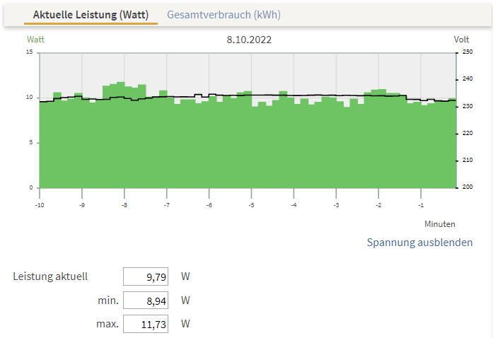

Every couple of minutes I was able to capture an "rpcd_lsad" process:

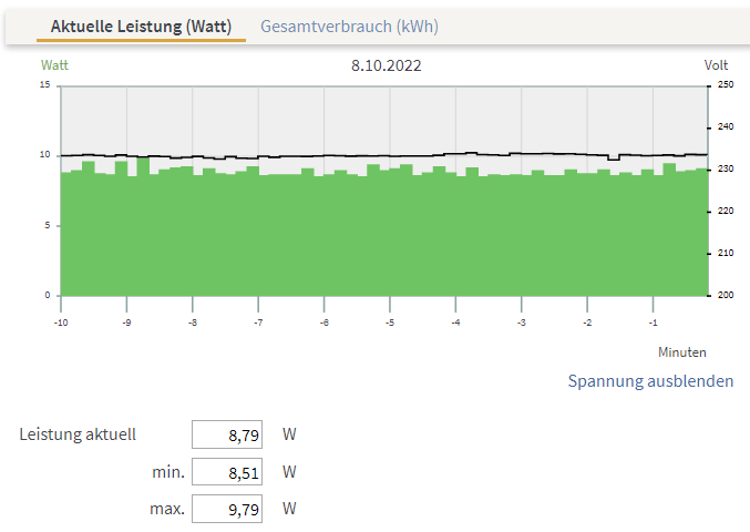

Compared with the default situation:
In addition you can see that "emhttpd", "update_3", "file_manager", "device_list" and "parity_list" are constantly producing load.

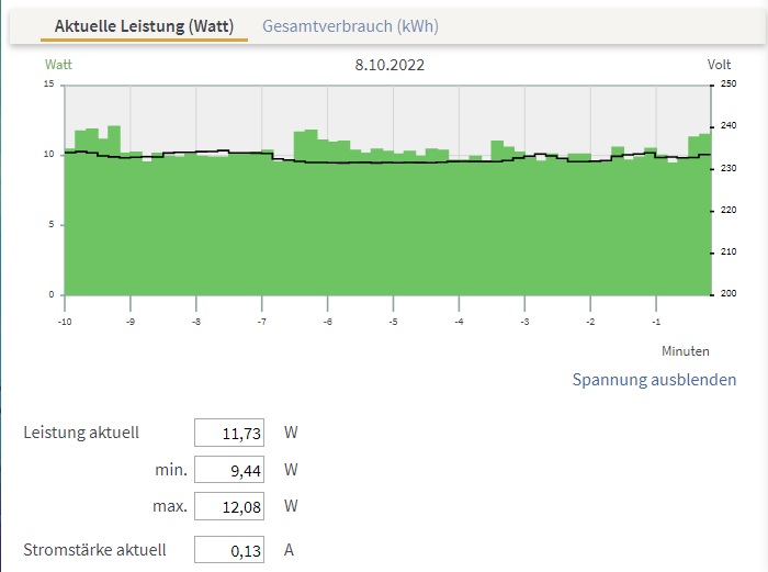

EDIT4:
Before disabling SMB:
After disabling SMB (only a small improvement visible):

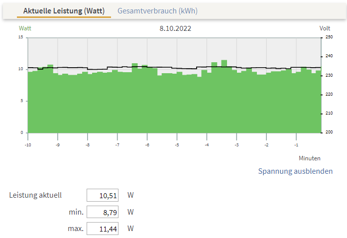

EDIT7: After killing all php processes (update_1, update_2, ...) and the bash script /usr/local/emhttp/nchan/disk_load, it looks much more like Unraid 6.9:
In comparison Unraid 6.9 only had the constanly running diskload script:
