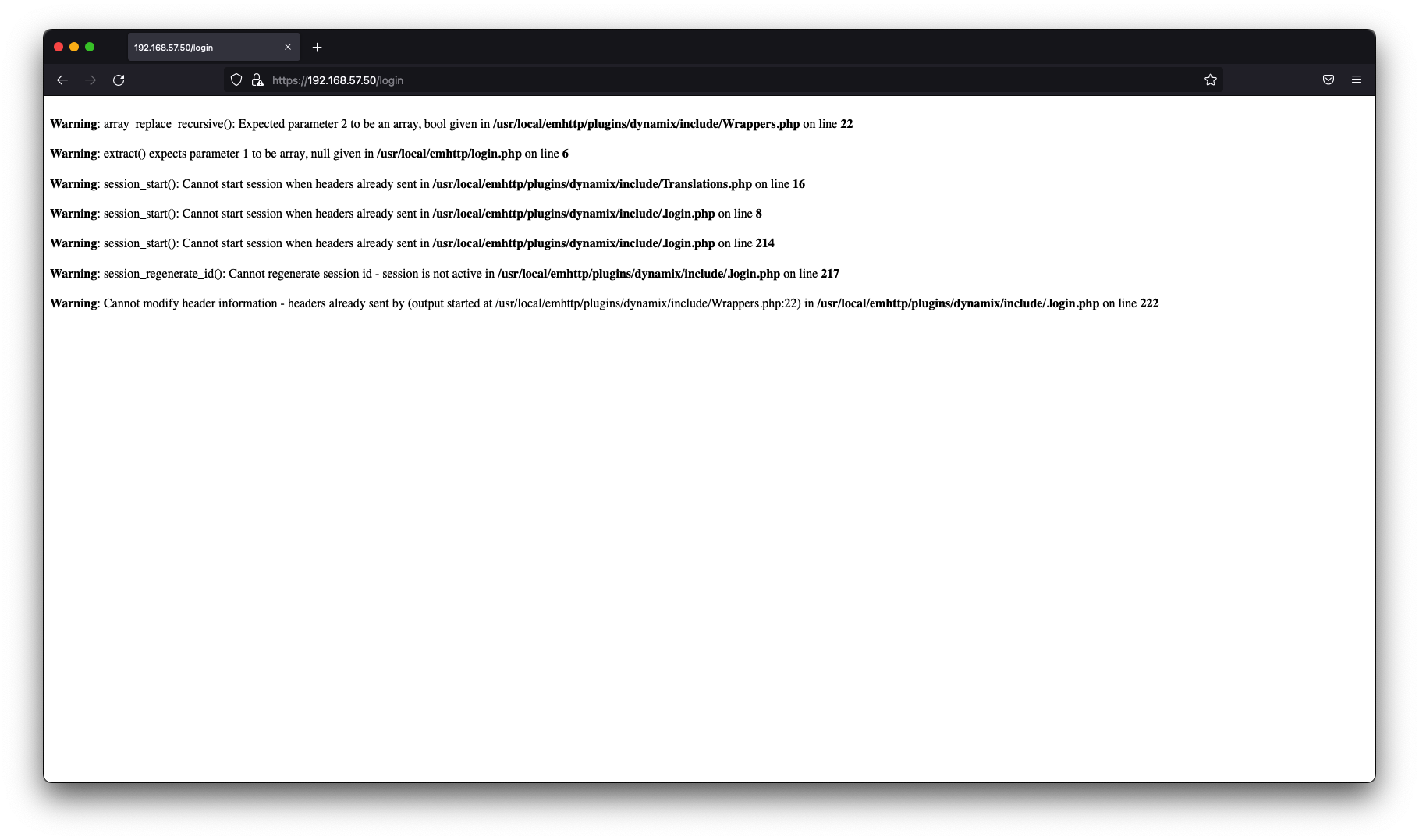

Hello there, I recently encountered a very odd situation with Unraid. I did upgrade recently, but server worked fine after upgrade until I decided to update a few docker containers causing the server to freeze. I essentially was left with no access to the Web GUI or SSH. I left alone for about 10 to 15 minutes and then decided to force shutdown. When the system came back up there were some errors displayed on the Web GUI:
1720701919_ScreenShot2022-09-02at1_13_29AM.thumb.png.8bc9938c09da0e33326f6ba9dca9be90.png

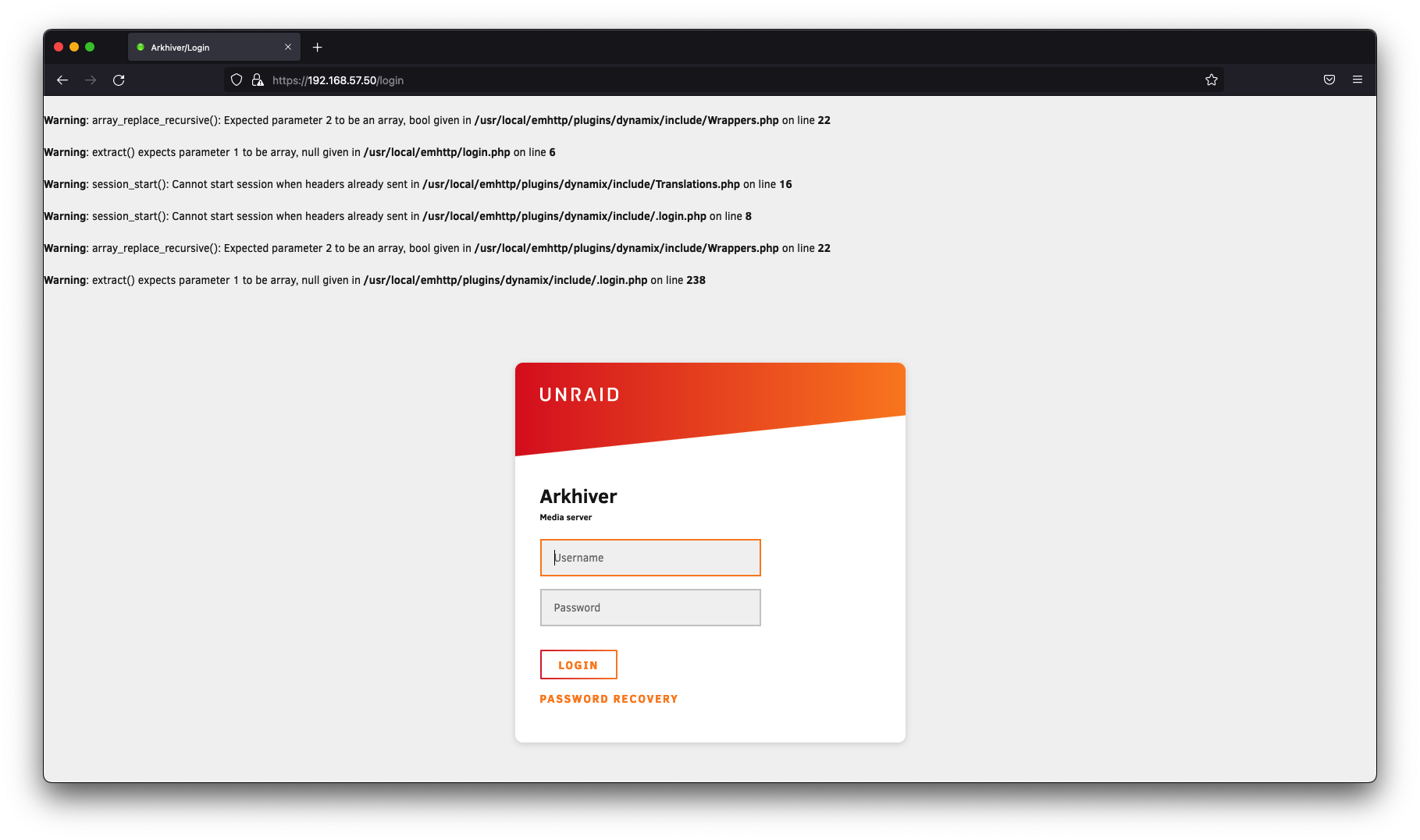

I tried to log in and it threw these errors at me:
1478886304_ScreenShot2022-09-02at1_14_39AM.thumb.png.d24186484c55d07c655b451034a7646a.png
