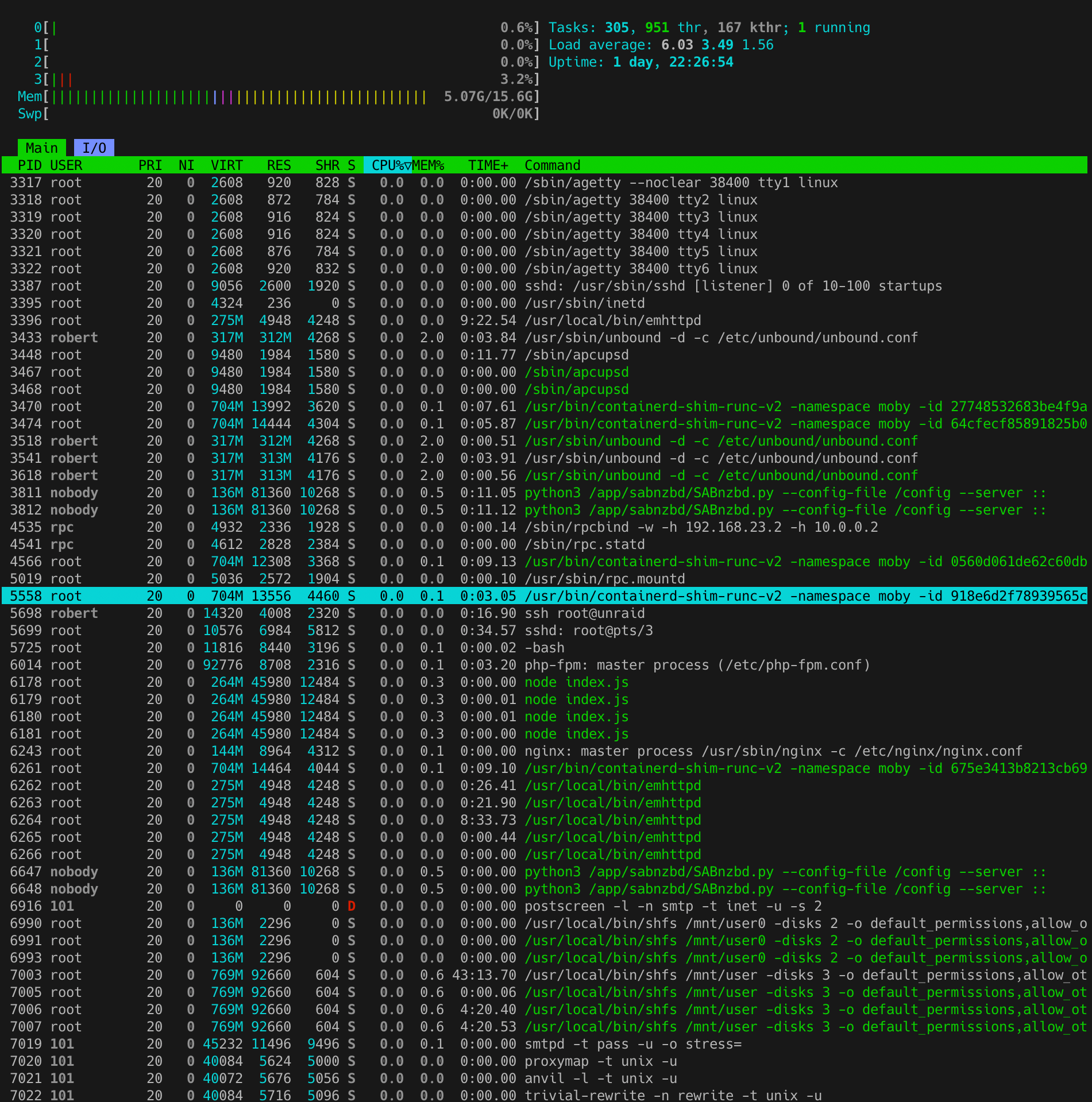

The symptoms are that shfs stops working for some reason, causing processes to get stuck in a D state. Processes that don't access disk continue to work. I had an `htop` running this time, notice the `postscreen` process (running inside a Docker-Mailserver container) that is stuck:
At this point, I can try and initiate a shutdown but it will fail because the filesystem is stuck and I have to hard-power-down the server.
This time though, I killed the main shfs process (PID 7003), which unstuck the server and the shutdown succeeded.
