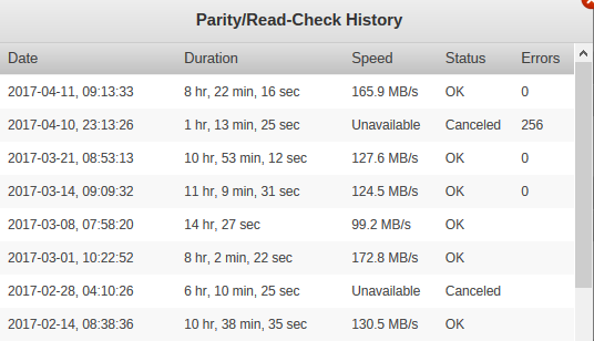

I was excited for dual parity, and quickly upgraded to that. Since I did, a whole new set of issues popped up. Here is what my last few parity checks look like:
On Feb 28, I was streaming Plex during the weekly Parity check. At some point during that Plex tosses an error that It cannot read the data anymore, I go and check and find drive 3 and 4 failed this time. So I did a system reboot. After the reboot, drives 3/4 are being emulated now, but also my cache 1 drive is now missing. Not failed, but it straight up did not boot and the server doesn't even see it. Did another reboot to see if it would come back up and it does not. I ended up switching to another cable/port on my raid controller. And it came back up and mounted with cache2 to restore my appdata. So I ran extended smart tests on both drives 3/4 and they passed with no errors. So i rebuilt the array and everything checked out. I have the syslogs and will attach them at the bottom. I put 2 syslogs down there, one before and the reboot after the failures.
Now on Apr 10, literally the exact thing happened again, right down to me streaming plex. And I went through the motions again and checked the smart reports, and swapped cache1 cable on the controller. I dont have the syslogs for this due to the fact Powerdown wasnt updated for 6.3 and I didnt realize this till today.
