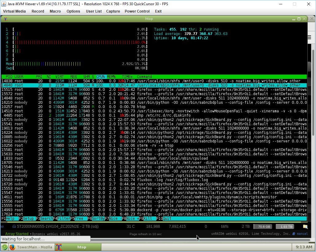

-          HTOP shows process that is eating up cpu, something about a “shfs error noatime.big_writes.allow only”.  I’ve had no luck searching for forums.  I am unable to KILL this process.

So far I have used the Server Console to view HTOP and that is how I know the cpu is at 100%.  It shows a process that I do not recognize or understand, see attached screenshot of HTOP.  I cannot KILL the process, not using htop and not using command line.  The system will simple ignore the commands.  I also tried to just leave the server alone and see if it would recover, no luck.  After 3 days it was still screwed up and unresponsive.

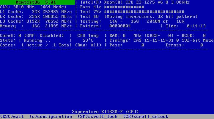

I’m still using reiserfs (I need to convert this when I have time) so I ran file system checks and reviewed SMART data on all drives - no errors.    For my cache pool (btrfs) I ran the SCRUB command.  I also ran memtest – no issues.  After a fresh reboot I’m able to run tower-diagnostics and I can PM that and my Syslog files to LT support if it helps.
This WILL happen again and I’m concerned with having to do a COLD restart.  Because I’m unable to KILL the process that is pushing the cpu to 100%, it leaves no option but to turn off the power each time this happens – NOT GOOD.
