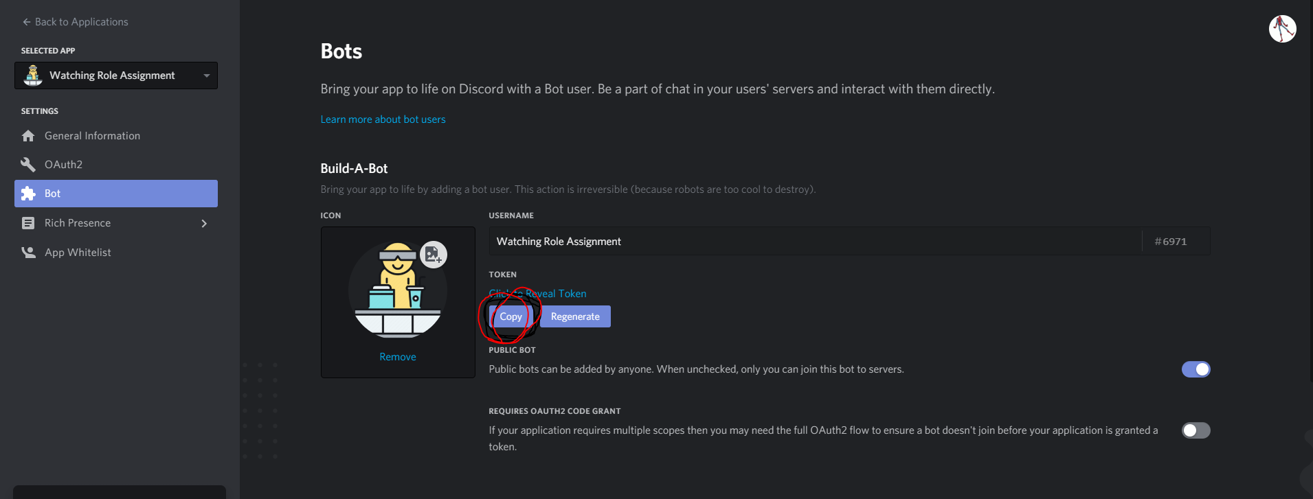

I have tested and confirmed that that error is the result of an invalid Discord Bot Token. Make sure you have a valid Token in the template and try again. Go to https://discordapp.com/developers/applications/ Click on your Bot application or make a new one. On that application click the bot tab and copy the Token and use it in your template.

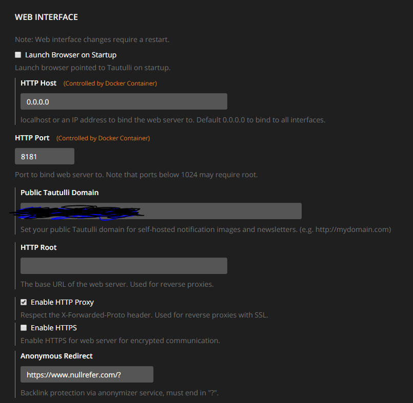

For what its worth, I'm using the linuxserver version and its fine. My web interface settings look like this and its behind a nginx proxy but the bot accesses it locally so it has no problems. Did you change the HTTP Root section?
[Support] Plex-Discord Role Management Docker
First off, thanks for the log info and that screen capture. You clearly have the ip and port correct because of the "Powered by CherryPy 5.1.0" footer. If the api key was wrong it would still return a json saying invalid API key. Instead, its returning a html 404 error which is why the bot doesn't errors. I can reproduce the same 404 error page on my own Tautuill service by entering an invalid path. It's like your Tautulli api endpoint doesn't exist. This is very strange. The only thing I can suggest right now is to check if your Tautulli is up-to-date but I doubt that will make a difference. I am in communication with the Tautulli Discord support channel to see as to why your endpoint is not working. I will get back to you when someone offers a solution. Sorry if I could not be of more help at this current moment.
