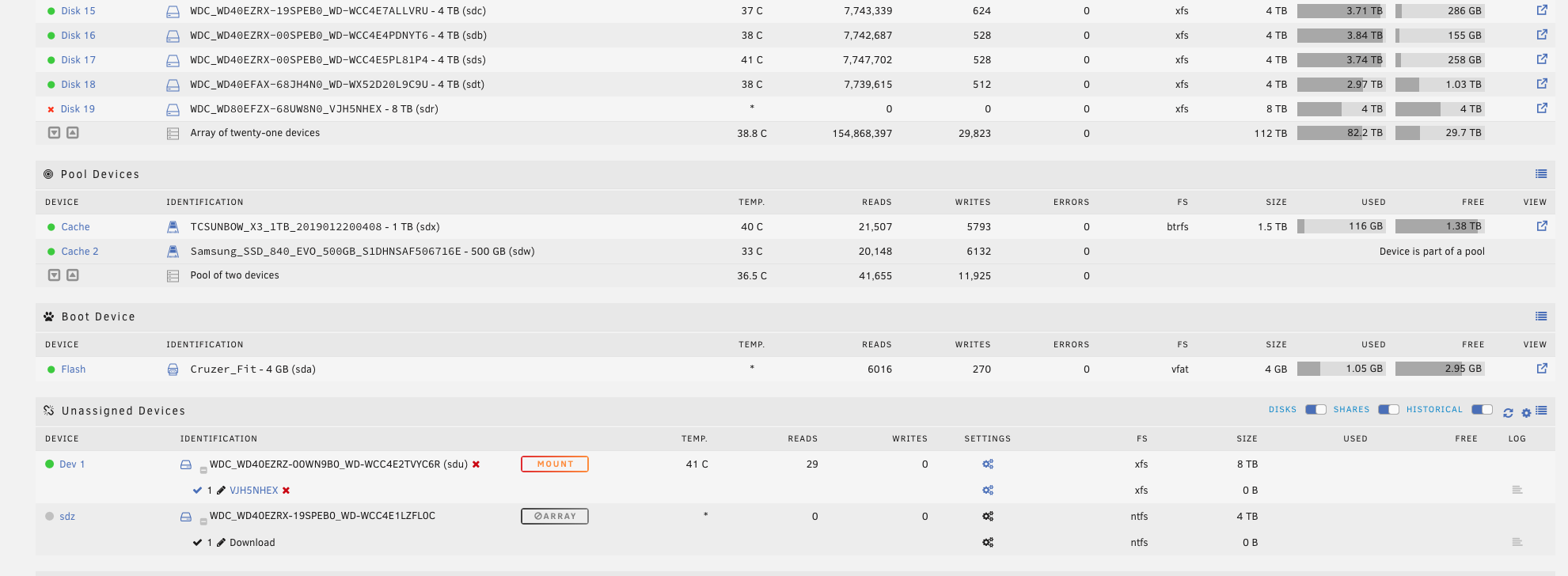

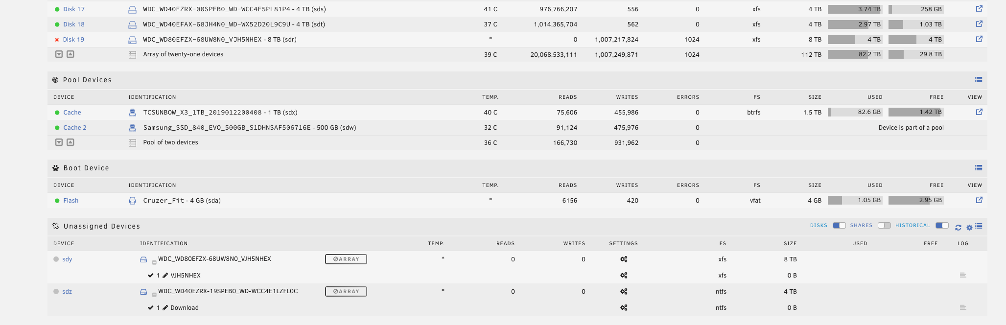

  18. After 4 disks got fried by a faulty cable I was able to get the server back on line with almost all data recovered... Now I have an issue with Unassigned Devices plugin... Sorry if I cannot explain myself in the correct way. I tred already twice to mount an extra disk that I use only to keep my downloaded files with JDownloader and I do not want to be part of the array. As soon as is installed I have the same disk plus the last disk of the array popping up in the list of the Unassigned devices (see pics) and the array disk is disabled and content emulated... I stopped the array and I started a data rebuilt that was succesfull. Once finisced I tried again to mount a disk for the downoads and... once again my array one is poppin as a unassigned device (Dev 1) again and is disabled... Once again rebuilt and so on Why this is happening? How should I fix it? Sorry for the stupid question but now I am scare to death to loose another disk or the data inside it!!!
