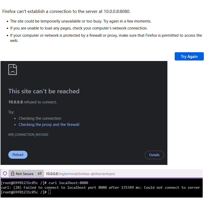

  1. Recently installed docker container from CA and added my wg0 config from my VPN provider. The container starts but the UI is inaccessible. Firefox Reports: Can't Establish a Connection (Not a connection timed out) Chrome reports: Cant be reached (Refused to connect) There are no conflicts with other containers for the webUI port (8080), even so, to do my due diligence, I followed all of the steps to change the port (internally and externally) but that didn't help so I reset it back to default. I've also re-installed and configured the container to no avail. This behavior also persisted through an Unraid upgrade. I can't even curl the webUI from within the container ("Could not connect") qbittorrentvpn-supervisord.txt qbittorrentvpn-docker-run.txt
