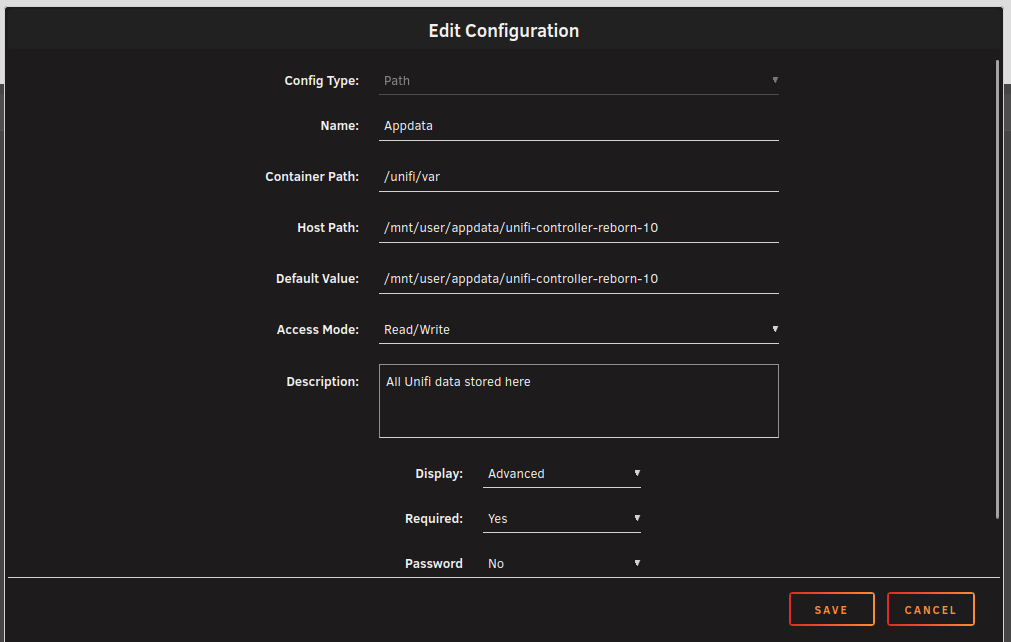

  2. Testing for version 10 needed (see below). Version 10 introduces some changes that will require manual intervention for users to upgrade from a 9x release to 10x for this docker. There are 2 methods you can use to upgrade. Method 1: In place upgrade. Method 2: Backup of settings of current running docker, and redeploy of docker to a new location. Both these methods are described below. Method 1 has the advantage of being easier and quicker, but may require restore from an archive/backup if something goes wrong. Method 2 will leave your current running docker alone but requires additional work to create a second unifi docker, and both cannot run/be started at the same time. Both methods would be supported so simply choose what works better for you (non critical systems probably method 1, systems for no downtime method 2 probably). Method1: Confirm that the DHCP server on your network is functional. This is required for readoption of unifi devices. Edit the unifi-controller-reborn docker. The following changes are required: Step 1: Repository. Change this tag to a appropriate tag eg: 11notes/unifi:10-unraid (note this tag is rolling in this example so dont use this if you cannot experience any downtime ever) Step 2: Enable advanced view Step 3: under extra parameters modify them to be this: --memory=8G --tmpfs /unifi/log:exec,uid=99,gid=100 --tmpfs /unifi/run:exec,uid=99,gid=100 Click apply to finish and allow new image to be pulled. Wait 10 minutes for adoption to occur after logging into the web interface via browser or phone. Method 2: Confirm that the DHCP server on your network is functional. This is required for readoption of unifi devices. Step 1: Take backup of running container via system - backups. Choose "settings only" (you could chose a time period like 7 days but this was not tested). Step 2: NB: STOP container in Unraid (very important) and go to apps and search for unifi reborn app. Click install. Step 3: If you install the app without making any changes at this stage, it will deploy over your current app. You must modify these settings before installing: a) Turn on advanced view and give the docker a slightly different name such as appending '-10' on the end: b) Under more settings modify the volume to write data to a different place than your current unraid docker: NOTE THIS IS CRITICAL, if you fail to do this your current docker will get modified! Note below how I have changed the path to include '-10' on the end: Step 4: You will now need to go to the web UI and restore the backup you created in step 1. Click restore from backup: Once it restores, it should stop the container. Unraid does not start it again, you will manually have to start it after 2 minutes or so. Wait till its stopped, then start it again and it will be restored. It can take 5 minutes to start up after a restore. Dont forget to set autostart on the appropriate container when done. If anyone can test the above (ie take a backup) and report back if it worked or broke for you that would be great. Kind regards P
