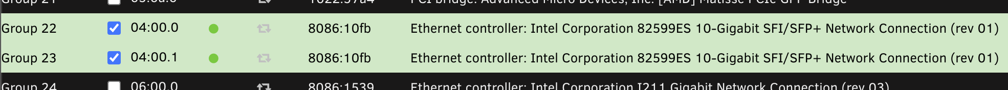

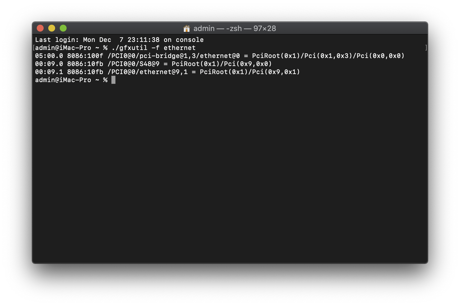

David, thx so far. I tried both methods. Unfortunately the card does not show up in mac OS, neither with multifunction='on' nor with both on bus 00 and slot 09 function 0x0 and 0x1... Could it be another problem? Maybe kext related? Any other idea? -

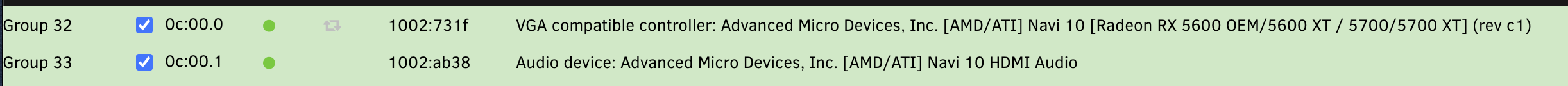

Hmm, I am not 100% sure but I thought I have to reset the 5700XT also when I shut down my Windows 10 VM and start it again. As said not 100% sure cause 99% of my work I use mac OS. But I will check this out! -

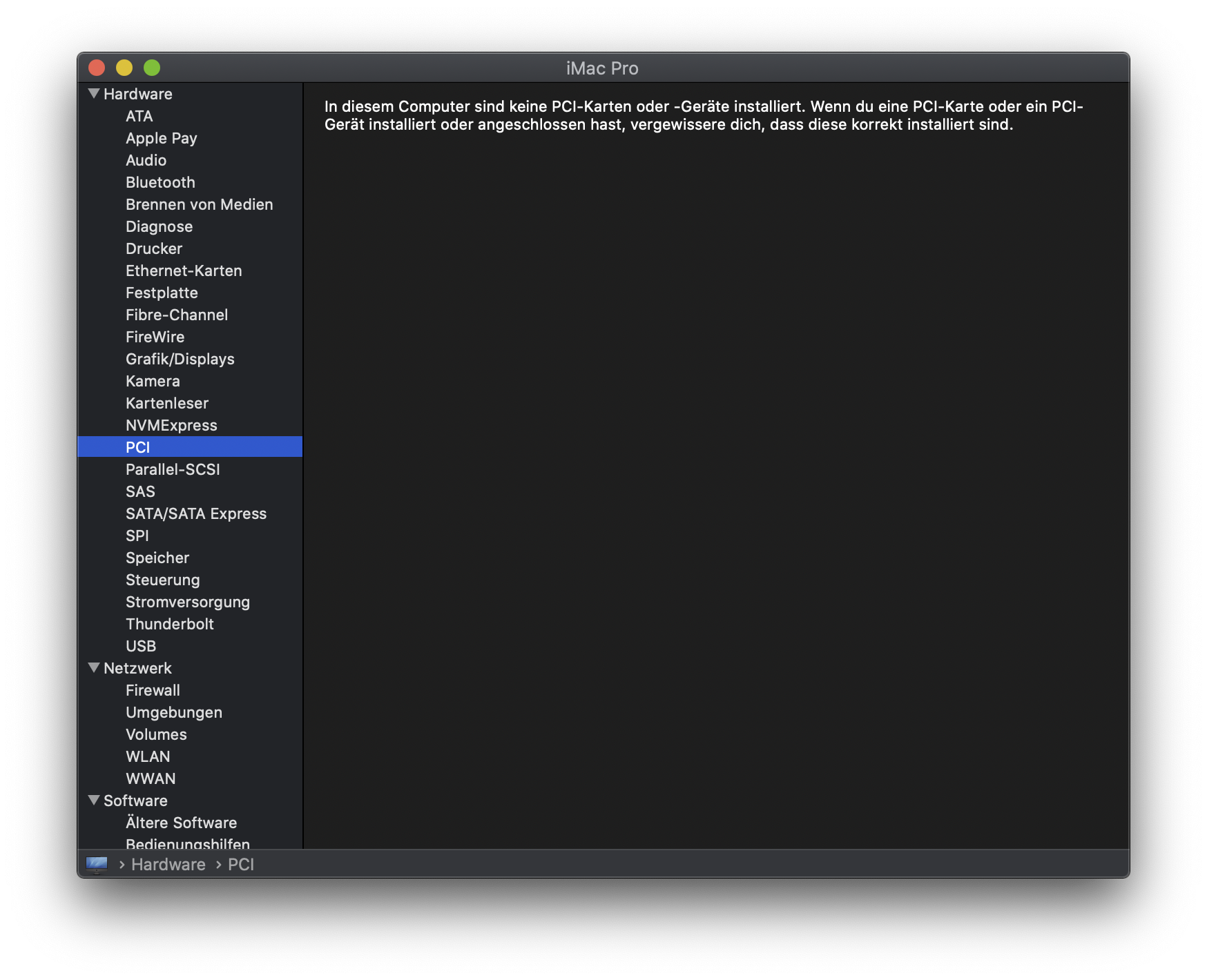

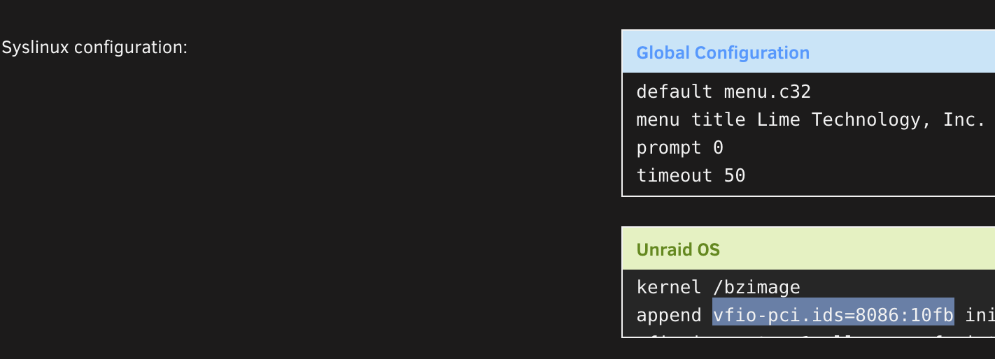

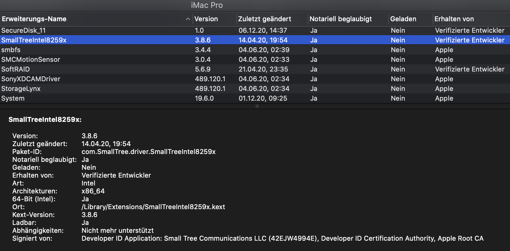

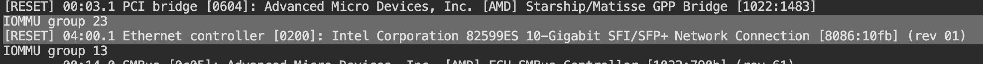

This is the part I should move up? <hostdev mode='subsystem' type='pci' managed='yes'> <driver name='vfio'/> <source> <address domain='0x0000' bus='0x04' slot='0x00' function='0x0'/> </source> <address type='pci' domain='0x0000' bus='0x07' slot='0x00' function='0x0'/> </hostdev> <hostdev mode='subsystem' type='pci' managed='yes'> <driver name='vfio'/> <source> <address domain='0x0000' bus='0x04' slot='0x00' function='0x1'/> </source> <address type='pci' domain='0x0000' bus='0x08' slot='0x00' function='0x0'/> </hostdev> Another thing I though, do I have to put the vendor id 8086:10fb into info.plist in my SmallTreeIntel8259x.kext? Update: Ckecked that, it is already in there! 0x10fb8086 <key>CFBundleIdentifier</key> <string>com.SmallTree.driver.SmallTreeIntel8259x</string> <key>IOClass</key> <string>SmallTreeIntel8259x</string> <key>IOPCIPauseCompatible</key> <true/> <key>IOPCIPrimaryMatch</key> <string>0x10c68086 0x10c78086 0x10c88086 0x10ec8086 0x10d88086 0x10fb8086 0x10f18086 0x151c8086 0x150b8086 0x15288086 0x10fc8086 0x15608086 0x15638086</string> <key>IOPCITunnelCompatible</key> <true/> <key>IOProviderClass</key> <string>IOPCIDevice</string> <key>IOResourceMatch</key> <string>IOBSD</string> <key>IOUserClientClass</key> <string>SmallTreeUserClient</string> Here is my XML: <!-- WARNING: THIS IS AN AUTO-GENERATED FILE. CHANGES TO IT ARE LIKELY TO BE OVERWRITTEN AND LOST. Changes to this xml configuration should be made using: virsh edit macOS or other application using the libvirt API. --> <domain type='kvm' xmlns:qemu='http://libvirt.org/schemas/domain/qemu/1.0'> <name>macOS</name> <uuid>XXX</uuid> <description>MacOS Catalina</description> <metadata> <vmtemplate xmlns="unraid" name="MacOS" icon="/mnt/user/domains/macOS/icon/catalina.png" os="Catalina"/> </metadata> <memory unit='KiB'>33554432</memory> <currentMemory unit='KiB'>33554432</currentMemory> <memoryBacking> <nosharepages/> </memoryBacking> <vcpu placement='static'>16</vcpu> <cputune> <vcpupin vcpu='0' cpuset='1'/> <vcpupin vcpu='1' cpuset='13'/> <vcpupin vcpu='2' cpuset='2'/> <vcpupin vcpu='3' cpuset='14'/> <vcpupin vcpu='4' cpuset='3'/> <vcpupin vcpu='5' cpuset='15'/> <vcpupin vcpu='6' cpuset='4'/> <vcpupin vcpu='7' cpuset='16'/> <vcpupin vcpu='8' cpuset='5'/> <vcpupin vcpu='9' cpuset='17'/> <vcpupin vcpu='10' cpuset='6'/> <vcpupin vcpu='11' cpuset='18'/> <vcpupin vcpu='12' cpuset='7'/> <vcpupin vcpu='13' cpuset='19'/> <vcpupin vcpu='14' cpuset='8'/> <vcpupin vcpu='15' cpuset='20'/> </cputune> <resource> <partition>/machine</partition> </resource> <os> <type arch='x86_64' machine='pc-q35-4.2'>hvm</type> <loader readonly='yes' type='pflash'>/mnt/user/domains/macOS/ovmf/OVMF_CODE.fd</loader> <nvram>/mnt/user/domains/macOS/ovmf/OVMF_VARS.fd</nvram> </os> <features> <acpi/> <apic/> </features> <cpu mode='host-passthrough' check='none'> <topology sockets='1' cores='8' threads='2'/> <cache mode='passthrough'/> <feature policy='require' name='topoext'/> </cpu> <clock offset='utc'> <timer name='rtc' tickpolicy='catchup'/> <timer name='pit' tickpolicy='delay'/> <timer name='hpet' present='no'/> </clock> <on_poweroff>destroy</on_poweroff> <on_reboot>restart</on_reboot> <on_crash>restart</on_crash> <devices> <emulator>/usr/local/sbin/qemu</emulator> <disk type='file' device='disk'> <driver name='qemu' type='raw' cache='none' io='native' discard='unmap'/> <source file='/mnt/user/domains/macOS/boot_opencore.dmg'/> <target dev='hdc' bus='sata'/> <boot order='1'/> <address type='drive' controller='0' bus='0' target='0' unit='2'/> </disk> <disk type='file' device='disk'> <driver name='qemu' type='raw' cache='writeback'/> <source file='/mnt/user/domains/macOS/Catalina-install.img'/> <target dev='hdd' bus='sata'/> <address type='drive' controller='0' bus='0' target='0' unit='3'/> </disk> <disk type='file' device='disk'> <driver name='qemu' type='raw' cache='none' io='native' discard='unmap'/> <source file='/mnt/user/domains/macOS/macos_disk.img'/> <target dev='hde' bus='sata'/> <address type='drive' controller='0' bus='0' target='0' unit='4'/> </disk> <disk type='block' device='disk'> <driver name='qemu' type='raw' cache='writeback'/> <source dev='/dev/disk/by-id/ata-APPLE_SSD_SM512E_S0VMNYAC802141'/> <target dev='hdf' bus='sata'/> <address type='drive' controller='0' bus='0' target='0' unit='5'/> </disk> <disk type='block' device='disk'> <driver name='qemu' type='raw' cache='writeback'/> <source dev='/dev/disk/by-id/ata-ST8000AS0002-1NA17Z_Z840GAEA'/> <target dev='hdg' bus='sata'/> <address type='drive' controller='1' bus='0' target='0' unit='0'/> </disk> <controller type='pci' index='0' model='pcie-root'/> <controller type='pci' index='1' model='pcie-root-port'> <model name='pcie-root-port'/> <target chassis='1' port='0xb'/> <address type='pci' domain='0x0000' bus='0x00' slot='0x01' function='0x3'/> </controller> <controller type='pci' index='2' model='pcie-root-port'> <model name='pcie-root-port'/> <target chassis='2' port='0xd'/> <address type='pci' domain='0x0000' bus='0x00' slot='0x01' function='0x5'/> </controller> <controller type='pci' index='3' model='pcie-root-port'> <model name='pcie-root-port'/> <target chassis='3' port='0xe'/> <address type='pci' domain='0x0000' bus='0x00' slot='0x01' function='0x6'/> </controller> <controller type='pci' index='4' model='pcie-root-port'> <model name='pcie-root-port'/> <target chassis='4' port='0x13'/> <address type='pci' domain='0x0000' bus='0x00' slot='0x02' function='0x3'/> </controller> <controller type='pci' index='5' model='pcie-root-port'> <model name='pcie-root-port'/> <target chassis='5' port='0x8'/> <address type='pci' domain='0x0000' bus='0x00' slot='0x01' function='0x0' multifunction='on'/> </controller> <controller type='pci' index='6' model='pcie-root-port'> <model name='pcie-root-port'/> <target chassis='6' port='0x9'/> <address type='pci' domain='0x0000' bus='0x00' slot='0x01' function='0x1'/> </controller> <controller type='pci' index='7' model='pcie-root-port'> <model name='pcie-root-port'/> <target chassis='7' port='0xa'/> <address type='pci' domain='0x0000' bus='0x00' slot='0x01' function='0x2'/> </controller> <controller type='pci' index='8' model='pcie-root-port'> <model name='pcie-root-port'/> <target chassis='8' port='0xc'/> <address type='pci' domain='0x0000' bus='0x00' slot='0x01' function='0x4'/> </controller> <controller type='pci' index='9' model='pcie-to-pci-bridge'> <model name='pcie-pci-bridge'/> <address type='pci' domain='0x0000' bus='0x06' slot='0x00' function='0x0'/> </controller> <controller type='virtio-serial' index='0'> <address type='pci' domain='0x0000' bus='0x02' slot='0x00' function='0x0'/> </controller> <controller type='sata' index='0'> <address type='pci' domain='0x0000' bus='0x00' slot='0x1f' function='0x2'/> </controller> <controller type='sata' index='1'> <address type='pci' domain='0x0000' bus='0x09' slot='0x01' function='0x0'/> </controller> <controller type='usb' index='0' model='ich9-ehci1'> <address type='pci' domain='0x0000' bus='0x00' slot='0x07' function='0x7'/> </controller> <controller type='usb' index='0' model='ich9-uhci1'> <master startport='0'/> <address type='pci' domain='0x0000' bus='0x00' slot='0x07' function='0x0' multifunction='on'/> </controller> <controller type='usb' index='0' model='ich9-uhci2'> <master startport='2'/> <address type='pci' domain='0x0000' bus='0x00' slot='0x07' function='0x1'/> </controller> <controller type='usb' index='0' model='ich9-uhci3'> <master startport='4'/> <address type='pci' domain='0x0000' bus='0x00' slot='0x07' function='0x2'/> </controller> <controller type='pci' index='10' model='pcie-root-port'> <model name='pcie-root-port'/> <target chassis='10' port='0xf'/> <address type='pci' domain='0x0000' bus='0x00' slot='0x01' function='0x7'/> </controller> <interface type='bridge'> <mac address='XXX'/> <source bridge='br0'/> <model type='e1000-82545em'/> <address type='pci' domain='0x0000' bus='0x01' slot='0x00' function='0x0'/> </interface> <serial type='pty'> <target type='isa-serial' port='0'> <model name='isa-serial'/> </target> </serial> <console type='pty'> <target type='serial' port='0'/> </console> <channel type='unix'> <target type='virtio' name='org.qemu.guest_agent.0'/> <address type='virtio-serial' controller='0' bus='0' port='1'/> </channel> <input type='tablet' bus='usb'> <address type='usb' bus='0' port='1'/> </input> <input type='mouse' bus='ps2'/> <input type='keyboard' bus='ps2'/> <hostdev mode='subsystem' type='pci' managed='yes'> <driver name='vfio'/> <source> <address domain='0x0000' bus='0x0c' slot='0x00' function='0x0'/> </source> <rom file='/mnt/disk1/isos/Sapphire.RX5700XT.8192.191101.rom'/> <address type='pci' domain='0x0000' bus='0x03' slot='0x00' function='0x0'/> </hostdev> <hostdev mode='subsystem' type='pci' managed='yes'> <driver name='vfio'/> <source> <address domain='0x0000' bus='0x0c' slot='0x00' function='0x1'/> </source> <address type='pci' domain='0x0000' bus='0x04' slot='0x00' function='0x0'/> </hostdev> <hostdev mode='subsystem' type='pci' managed='yes'> <driver name='vfio'/> <source> <address domain='0x0000' bus='0x0f' slot='0x00' function='0x4'/> </source> <address type='pci' domain='0x0000' bus='0x05' slot='0x00' function='0x0'/> </hostdev> <hostdev mode='subsystem' type='pci' managed='yes'> <driver name='vfio'/> <source> <address domain='0x0000' bus='0x04' slot='0x00' function='0x0'/> </source> <address type='pci' domain='0x0000' bus='0x07' slot='0x00' function='0x0'/> </hostdev> <hostdev mode='subsystem' type='pci' managed='yes'> <driver name='vfio'/> <source> <address domain='0x0000' bus='0x04' slot='0x00' function='0x1'/> </source> <address type='pci' domain='0x0000' bus='0x08' slot='0x00' function='0x0'/> </hostdev> <hostdev mode='subsystem' type='pci' managed='yes'> <driver name='vfio'/> <source> <address domain='0x0000' bus='0x07' slot='0x00' function='0x3'/> </source> <address type='pci' domain='0x0000' bus='0x0a' slot='0x00' function='0x0'/> </hostdev> <hostdev mode='subsystem' type='usb' managed='no'> <source> <vendor id='0x0b05'/> <product id='0x18e1'/> </source> <address type='usb' bus='0' port='2'/> </hostdev> <hostdev mode='subsystem' type='usb' managed='no'> <source> <vendor id='0x1038'/> <product id='0x0100'/> </source> <address type='usb' bus='0' port='3'/> </hostdev> <hostdev mode='subsystem' type='usb' managed='no'> <source> <vendor id='0x1e7d'/> <product id='0x38a4'/> </source> <address type='usb' bus='0' port='4'/> </hostdev> <memballoon model='none'/> </devices> <seclabel type='dynamic' model='dac' relabel='yes'/> <qemu:commandline> <qemu:arg value='-usb'/> <qemu:arg value='-device'/> <qemu:arg value='usb-kbd,bus=usb-bus.0'/> <qemu:arg value='-device'/> <qemu:arg value='************************'/> <qemu:arg value='-smbios'/> <qemu:arg value='type=2'/> <qemu:arg value='-cpu'/> <qemu:arg value='Skylake-Client,kvm=on,vendor=GenuineIntel,+invtsc,+hypervisor,vmware-cpuid-freq=on,+pcid,+popcnt,check'/> <qemu:arg value='-set'/> <qemu:arg value='device.sata0-0-2.rotation_rate=1'/> <qemu:arg value='-set'/> <qemu:arg value='device.sata0-0-4.rotation_rate=1'/> </qemu:commandline> </domain> -
** Hackintosh ** Tips to make a bare metal MacOS
derpuma replied to Leoyzen's topic in VM Engine (KVM)
I have a problem installing my 10 Gbe Intel Ethernet Card under VM mac OS Catalina 10.5.7. I was able to passthrough the card via VFIO-PCI Config. The card is prepared for the use with the SmallTreeIntel8259x drivers and it was running in my Hackintosh without any problem. Unfortunately mac OS Systems does not show the card neither it loads the Smalltree driver, which is in /Library/Extensions. As it is a PCI device, where should it be shown? It is not under PCI and also not under Ethernet-Cards. What else can I check and do, to get this card on the run? I checked that the card can be reset. Do I have to isolate the card via Syslinux config to reset the card? vfio-pci.ids=8086:10fb -

Yeah, that is the reset problem. Hoped the fix would have been compiled into the kernel. For that reason I use a script via CA User Scripts Plugin. The use avoids me from restarting the whole server. It simply powers the 5700xt off/on and then you are able to reboot the VM. Be sure not to simply copy the script, enter the individual PCI root for your card. I use VFIO-PCI Config and it shows me the the PCI address of my card. #!/bin/bash echo "disconnecting amd graphics" echo "1" | tee -a /sys/bus/pci/devices/0000\:0c\:00.0/remove echo "disconnecting amd sound counterpart" echo "1" | tee -a /sys/bus/pci/devices/0000\:0c\:00.1/remove echo "entered suspended state press power button to continue" echo -n mem > /sys/power/state echo "reconnecting amd gpu and sound counterpart" echo "1" | tee -a /sys/bus/pci/rescan echo "AMD graphics card sucessfully reset" -
