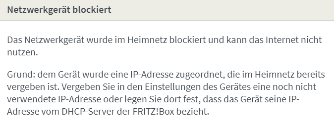

  1. so the problem is not quite solved. So everything still works but on the fritzbox I see the ip of the unraid server twice again nd on one of them it has supposedly blocked access because it is a duplicate IP. Unraid server and all dockers have access to the internet. Does anyone have an idea how to prevent this?
  2. Very strange after I changed everything back as follows, everything works again: Docker custom network type: macvlan Host access to custom networks: Enabled Preserve user defined networks: Yes IPv4 custom network on interface eth0: Subnet: 192.168.178.0/24 Gateway: 192.168.178.1 DHCP pool: not set Enable bonding: No Enable bridging: NO This is exactly what I had set at the beginning. Maybe it was due to the Unraid server crash I had the other day.
  3. mh...ok thanks for your feedback. Had hoped for a different solution 🙂 I tried the following config again yesterday: Docker custom network type: macvlan Host access to custom networks: Enabled Preserve user defined networks: Yes IPv4 custom network on interface br0: Subnet: 192.168.178.0/24 Gateway: 192.168.178.1 DHCP pool: not set Enable bonding: No Enable bridging: Yes As a result, I was able to access the Unraid shares again via Home Assistant VM (br0). However, I now have 2x Unraid server on my Fritzbox with the same IP. Once the “shim-br0” interface and once the eth0/br0 interface. Not bad in itself, but the Fritzbox thinks that it doesn't like the double IP and therefore blocks its internet access 😞 My Unraid server can no longer access any address on the Internet, so I can't install any Docker / plugin updates. Also all dockers in bridge mode can no longer access the network. Does anyone have any ideas about this? I'm really lost at the moment. Everything used to work before.
  4. Have the same problem. @aglyons were you able to solve the problem? If so, how? For me it looks like this. Unraid server is displayed twice in the Fritzbox (currently no longer, I don't know what I changed, probably it no longer appears twice after an Unraid crash / hard reset). In addition, I can no longer access my Unraid CIFS share from my Home Assistant VM. Ping does not go through either. From the UR server to the HA VM no ping goes through either. I have now spent 3 hours reading all possible posts on this topic and on the topic of ipvlan (“Call traces and crashes related to macvlan”) and am confused as to which settings I should now set so that everything works again?! Here are my settings: Docker custom network type: macvlan Host access to custom networks: Enabled Preserve user defined networks: Yes IPv4 custom network on interface eth0: Subnet: 192.168.178.0/24 Gateway: 192.168.178.1 DHCP pool: not set Enable bonding: No Enable bridging: No

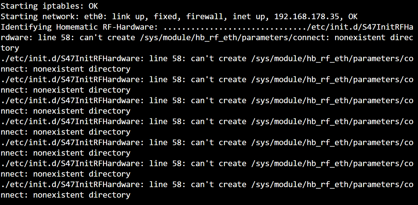

  5. kann ich so unterschreiben. Datei ist definitiv vorhanden. Habs mit und ohne privilegierte rechte probiert. Also wenn du Zeit hast wäre ich gespannt ob es immer noch bei dir funktioniert 🙂
  6. Ja hab ich alles so gemacht. Er versucht sich ja zu verbinden aber kann in dem Verzeichnis nicht schreiben. Wenn man nach dem Fehler sucht, finden man diesen Post bei Github/HM Forum: https://github.com/jens-maus/RaspberryMatic/discussions/1924 "deuten daraufhin, dass er nicht in der Lage ist das kernel modul (hb_rf_eth) korrekt zu laden. Insofern wird es in der Tat wohl an einer fehlenden oder inkorrekten Installation des pivccu-modules-dkms debian paketes zu liegen." Hast du irgendwelche ähnliche Befehle durchgeführt? "sudo apt reinstall linux-headers-5.15.0-47-generic sudo apt reinstall pivccu-modules-dkms sudo service pivccu-dkms start sudo modprobe eq3_char_loop"
  7. So...grad nochmal getestet. Hab die Config von dir 1zu1 übernommen. Bekomme aber folgendes im Log angezeigt (s.u.) Was mach ich falsch?

  11. Leider nein. Generell als docker lief raspberrymatic aber das eth Modul wollte aufgrund fehlender Treiber oder so nicht laufen. VM ging schnell und einfach. Läuft reibungslos bisher.
  12. Servus. So Platine ist angekommen. Hast recht gehabt mit den Treibern 😕 konnte ich nicht glauben vorher aber am Ende hat es doch Sinn ergeben ^^ Naja mal abwarten ob der Entwickler die Treiber für Unraid mal kompiliert oder jemand anderes es hinbekommt. So lange läuft das ganze erstmal als VM. Läuft auch mit nur einem zugewiesen CPU Kern super schnell. Unterschied wie Tag und Nacht zur CCU2 🙂
  13. Ich glaub nicht das für die ETH Platine Treiber benötigt werden. Geht doch über IP die Anbindung. Bei der USB Platine...klar da werden Treiber benötigt. Hab mir die Platine und das Funkmodul mal bestellt. Werde es mal mit dem Container testen. Und wenn nicht, wird es halt eine VM. Auch nicht schlimm.
