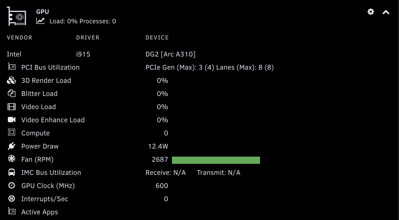

  1. I'm having the issue with an ARC A310 where it isn't showing anything but fan usage and power draw. I've set it to top + qmassa... I've got tdarr almost constantly running GPU transcodes and I did confirm it is running when I did the requested support commands/documentation: 1&2: root@[redacted]:~# timeout -k .500 .400 intel_gpu_top -J -s 250 root@[redacted]:~# cd /usr/local/emhttp/plugins/gpustat/ && php ./gpustatus.php Could not open input file: ./gpustatus.php 3): 4) the contents of '/boot/config/plugins/gpustat/gpustat.cfg': MULTIGPU = "85:00.0" TEMPFORMAT = "F" UIREFRESH = 1 UIREFRESHINT = 2000 DEBUGLOG = 0 DISPCLOCKS = 1 DISPPCIUTIL = 1 DISPPWRDRAW = 1 DISPPWRSTATE = 1 DISPMEMUTIL = 0 DISPTEMP = 0 DISPFAN = 1 DISPSESSIONS = 1 DISPENCDEC = 0 DISPTHROTTLE = 0 INTELBACKEND = "top_qmassa" DISP3DRENDER = 1 DISPBLITTER = 1 DISPVIDEO = 1 DISPVIDENH = 1 DISPCOMPUTE = 1 DISPINTERRUPT = 1 DISPPWRDRWSEL = "GPU" DISPEVENT = 0 DISPVERTEX = 0 DISPTEXTURE = 0 DISPSHADEREXP = 0 DISPSEQUENCER = 0 DISPSHADERINTER = 0 DISPSCANCON = 0 DISPPRIMASSEM = 0 DISPDEPTHBLK = 0 DISPCOLORBLK = 0 DISPGFXTRANS = 0 MULTIGPUJSON = "%7B%2285%3A00.0%22%3A%7B%22id%22%3A%2285%3A00.0%22%2C%22model%22%3A%22DG2+%5BArc+A310%5D%22%2C%22vendor%22%3A%22i>
