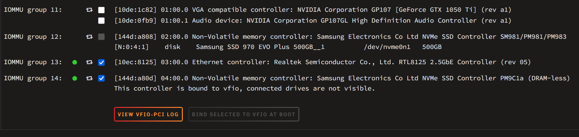

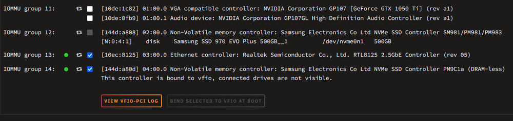

  1. Hello! Unable to passthrough Samsung 990 Evo plus NVME to a VM. Attempted all troubleshooting steps found in this forum, with no success. Summary below: Hardware Unraid 7.1.4 / Asrock H670m-ITX/AC---->i5-12400/32GB RAM 970 EVO (CACHE Drive - pcix3) / 990 EVO PLus NVME (For VM - pcix4) KVM IOMMU Groups - Validated NVME Controllers in separate Groups (990 EVO - Group 14) Q35-9.2 / OVMF-TPM VFIO - Bound 990 EVO Plus IOMMU group (attached) Primary Vdisk Location - NONE Other PCI Devices - Selected 990 EVO Plus (Boot Order '1') NVME Passthrough Problems (XML Attached) VM starts (no errors in logs). Hangs @ 'Unraid' splash screen. Single CPU core pegged @100% -- SLOOOOW - Takes 3-4 minutes before booting to Install ISO. No NVME Drives Found Troubleshooting Steps ISOLATED CPU CORES to VM - No change Swapped NVME Slots - No Change VFIO - Disabling bind to 990 SSD Controller SSD works without issue (VFIO) via Manual Vdisk - /dev/disk/by-id/nvme-Samsung_SSD_990_EVO_Plus Test - Outside of Unraid - Installed Windows 11 directly to 990 EVO PLUS - No issues Baffled why NVME passthrough 'seems to work', but hangs the VM & does not see 990 EVO Plus drive (i/o hardware limitation?). Can still use the VFIO method if needed, trying for best performance via passthrough. Suggestions? Thanks. Pancho VM.XML VM Log.txt
