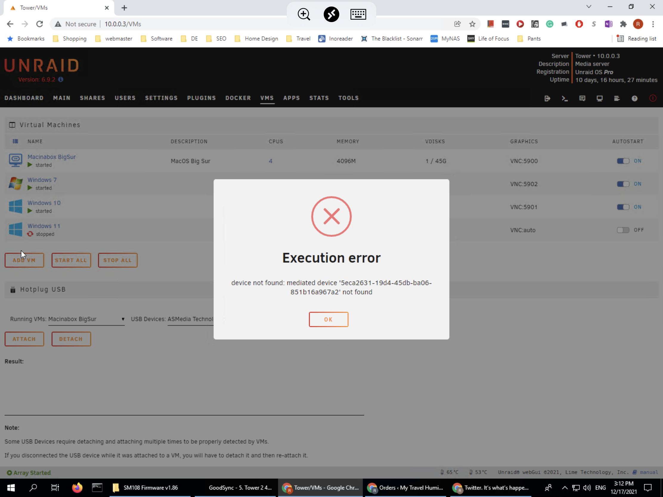

  3. Hi, I tried to attached a usb device to a VM, failed. then I found out I cannot update any VMs as well. Please see the attached pic and the log. where is wrong? thanks so much! tower-diagnostics-20211217-1512.zip

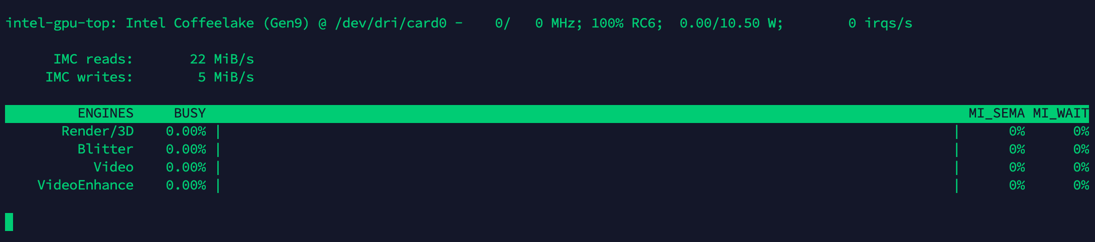

  5. if I check intel_gpu_top . it seems working. but if I try to add the vGPU inside a VM, it errors out like the pic I sent you earlier. " XML error: 'model' attribute in <hostdev> is only supported when type='pci' "

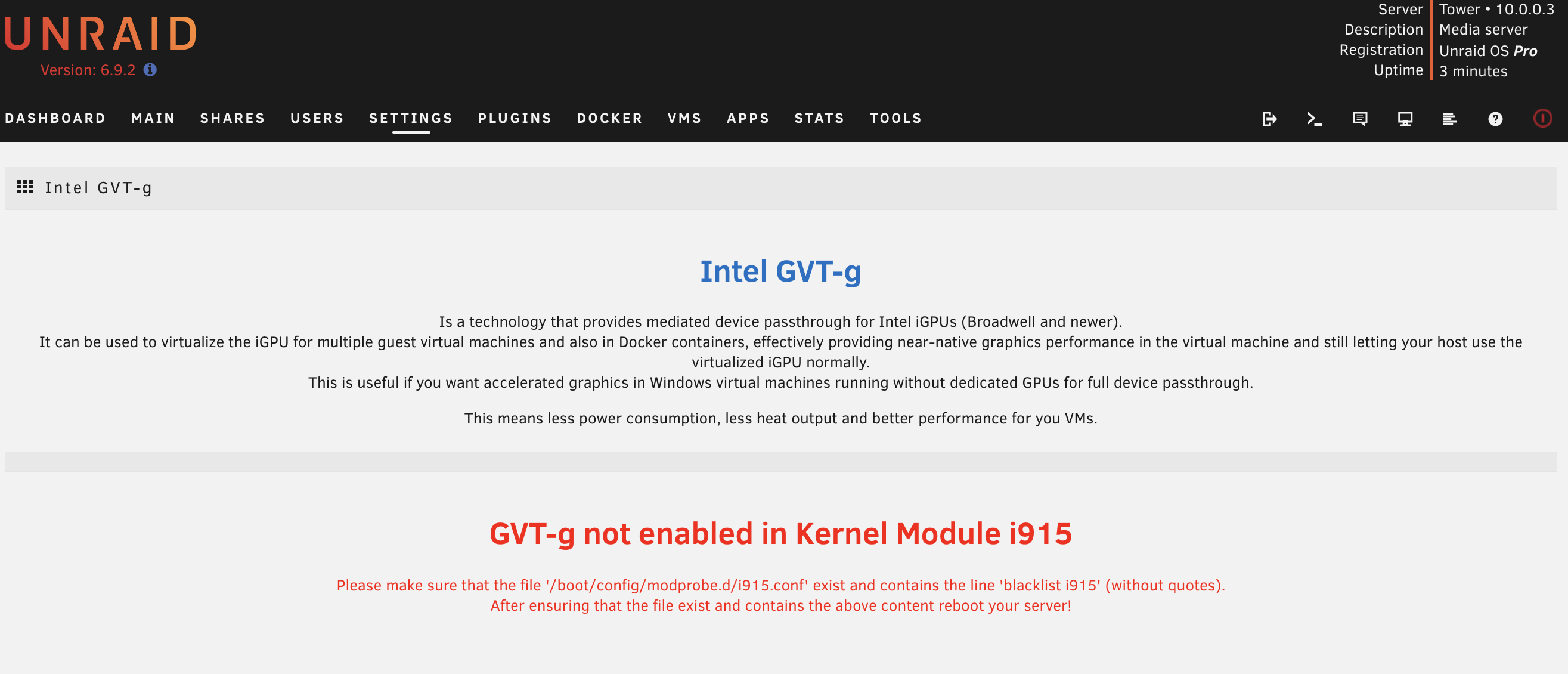

  7. I have deleted i915.conf under /boot/config/modprobe.d. but after the reboot, the file came back again. and inside it has this content: blacklist i915 when I manually added options i915 enable_gvt="Y". it will auto add blacklist in the end. and I cannot use GVT-g anymore. please see the attached screenshot.
  8. and it looks like my intel-gpu-top is working fine though.
  9. After reading the document from Arclinux, I am thinking this item is not enabled"Set i915 module parameter enable_gvt=1 to enable GPU virtualization" When I checked my GPU: /boot/config/modprobe.d/i915.conf it has blacklist i915 there. then I realized the intel gpu top plugins added the blacklist i915. I was able to add this one line above the blacklist: options i915 enable_gvt=1 blacklist i915 and after that, I can add the vGPU inside my VM without any issues. however, now the intel gpu top is broken, said it needs blacklist i915 on the file.
