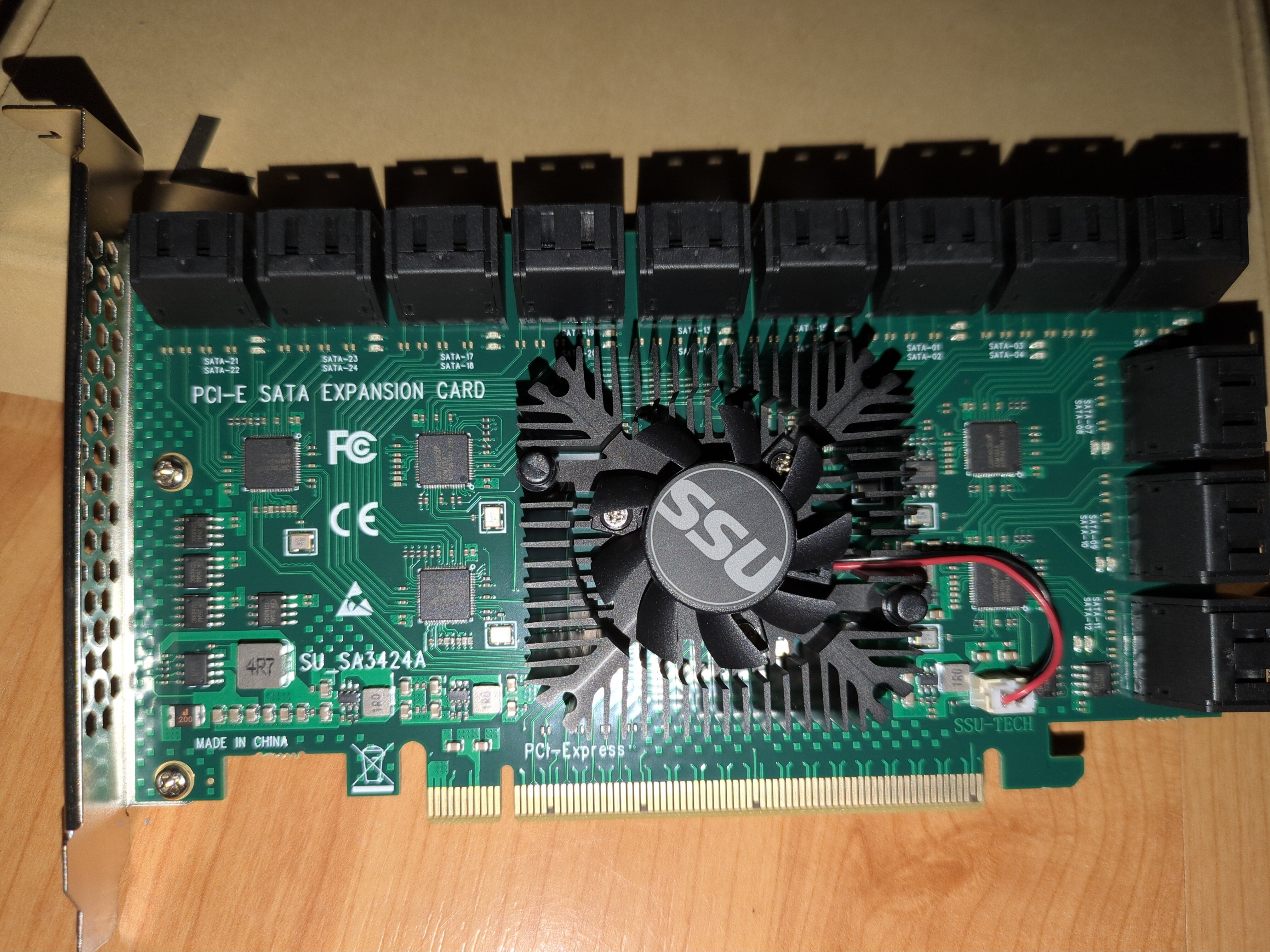

  15. It has 6 ASM1064 controllers.
  16. Hello. I have an raid card pcie gen 3 x 16 to 24 sata 3. It has an ASM 1812 +1064 controller. Is it ok to use. If I want to use it should i put the x16 pcie port to 4x4x4x4?
