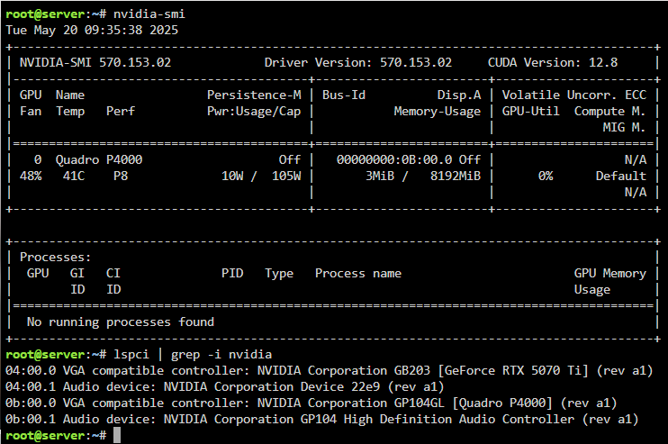

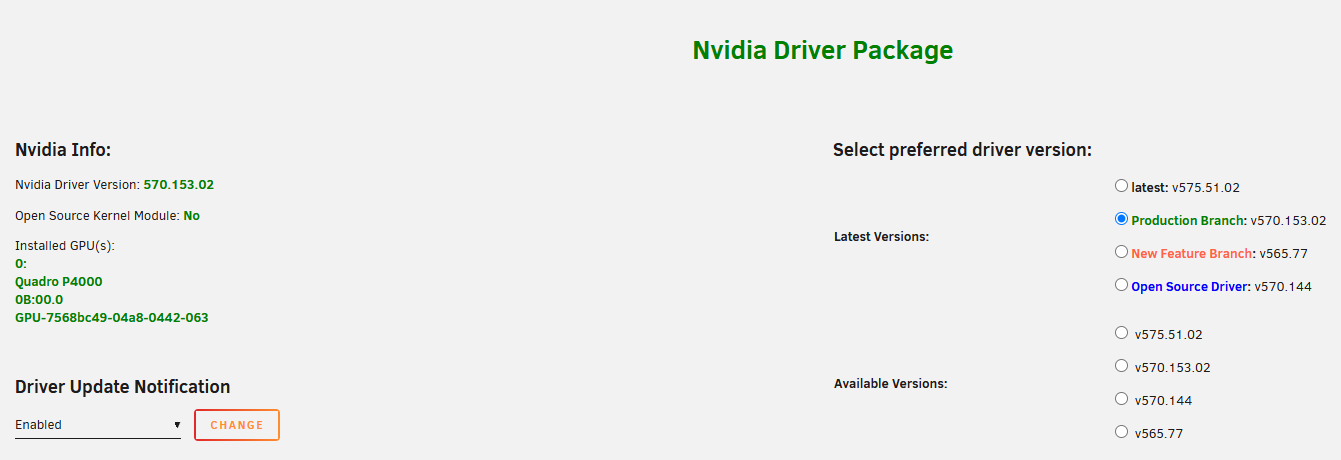

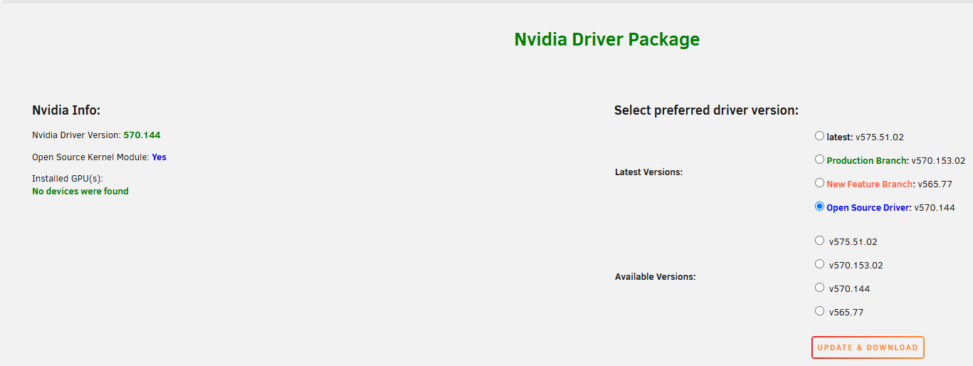

  4. I did turn on 4g and rebar in the bios. When i'm using production branch my P4000 is detected but the 5070Ti is not. When i'm using open source brance non of the GPUs is detected. I've attached screenshots and diagnostics. server-diagnostics-20250520-0946.zip
