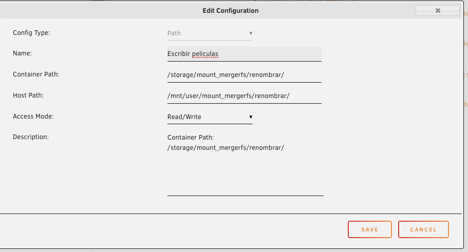

  1. I could finally fix the problem and see the files by adding a new path to the container and providing read/write access mode to it. Thank you for your support on this case!
