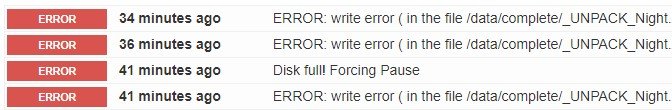

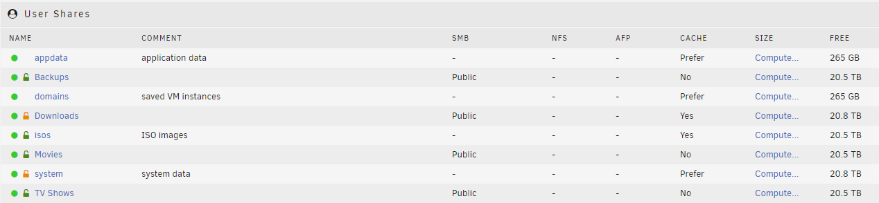

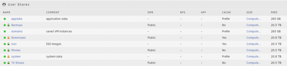

  5. binhex thanks for helping out! As far as I can tell I have tons of free space. I essentially set each of my shares over most of my drives: Thanks again!
  6. I have a space issue going on that I keep getting error for. It first started right after I got my new unraid system set up and through online reading I figured out I installed it to the wrong location. In response I ended up making a download share which has plenty of space and now I am pretty sure I have everything configured right. But after a week or so of downloads it has crept up again. Sab says I have plenty of space as does the unraid main dashboard (around 19TB). Sab error: Docker settings: Any guidance here would be super helpful. Thank you in advance, and sorry I am very new at all of this.

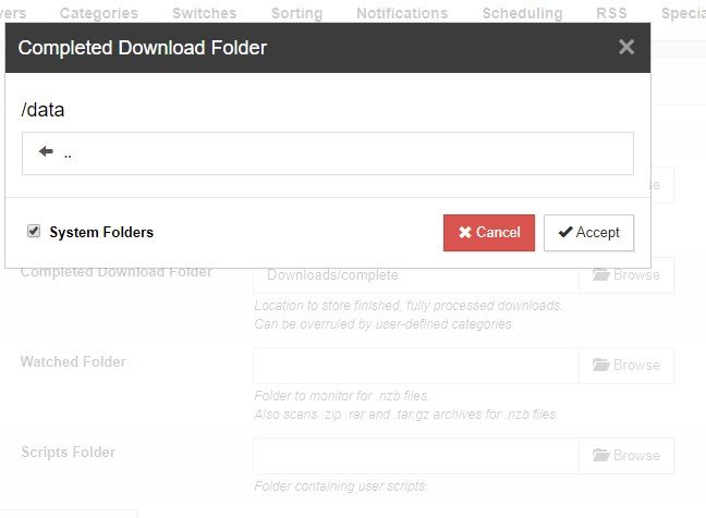

  8. I thought that was a problem at one point in my search but there is nothing showing in data when I browse from the sab UI. Do I need to create a downloads and complete folder in the data folder? If so where do I go to do that. Thanks! Sorry for the trouble. Edit:updated screen shot of the completed folder

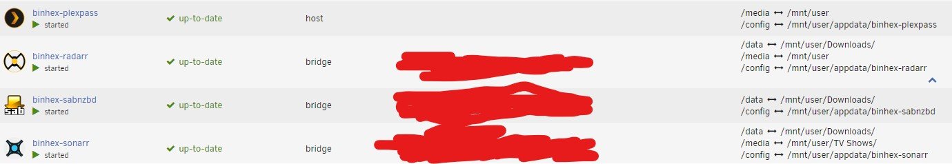

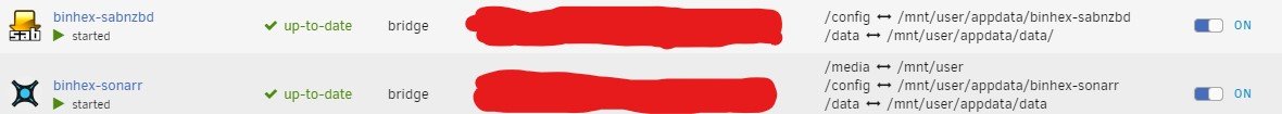

  9. Sorry: No files found are eligible for import in /config/Downloads/complete/Last.Week.720p
