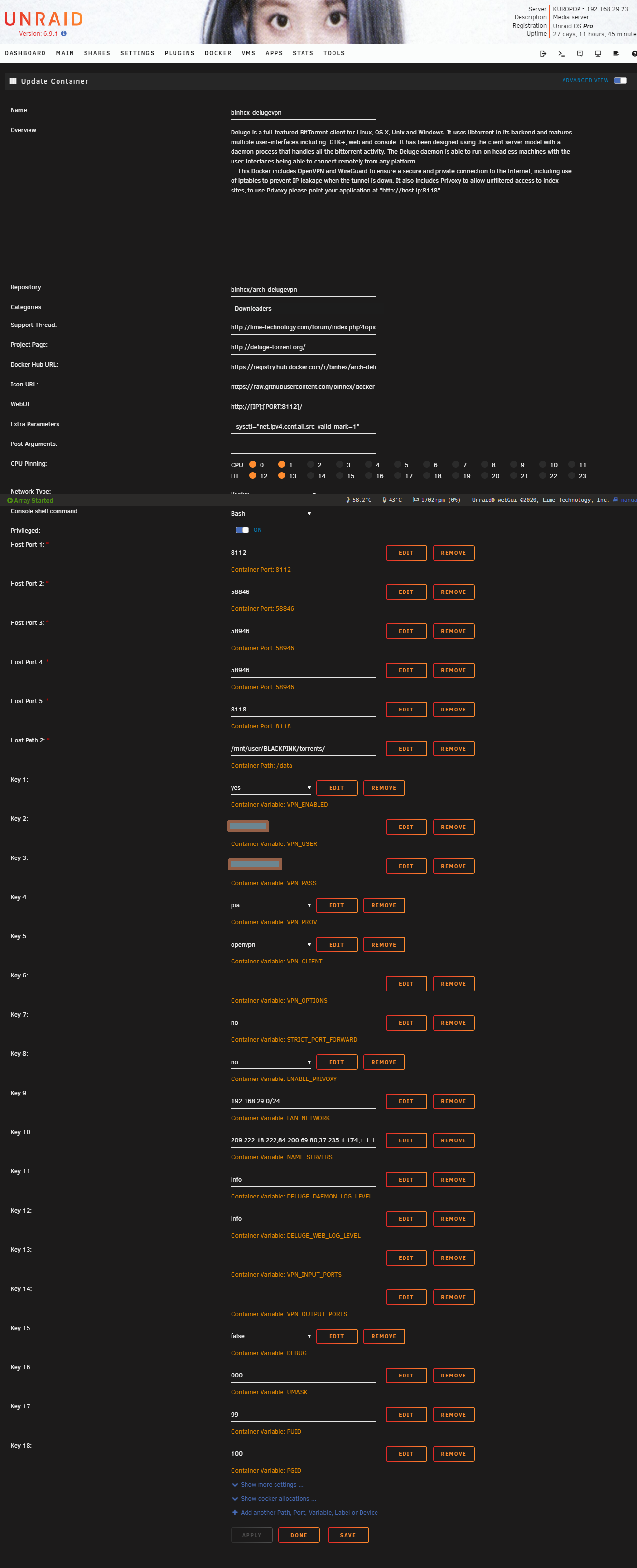

  7. Is anyone else having issue trying to use VPN with PIA? The container auto-updated last night, and now I am unable to connect to the WebUI and it seems like it is unable to connect to internet. I tried reinstalling the container fresh, with fresh config and fresh appdata, no help. I also tested my PIA config with OpenVPN client on my computer and it works. With VPN_ENABLED to no, I am able to access WebUI, but obviously no VPN. Config: Logs: Created by... ___. .__ .__ \_ |__ |__| ____ | |__ ____ ___ ___ | __ \| |/ \| | \_/ __ \\ \/ / | \_\ \ | | \ Y \ ___/ > < |___ /__|___| /___| /\___ >__/\_ \ \/ \/ \/ \/ \/ https://hub.docker.com/u/binhex/ 2021-04-06 12:41:08.120197 [info] System information Linux aa79a6579bb1 5.10.21-Unraid #1 SMP Sun Mar 7 13:39:02 PST 2021 x86_64 GNU/Linux 2021-04-06 12:41:08.140288 [info] OS_ARCH defined as 'x86-64' 2021-04-06 12:41:08.159466 [info] PUID defined as '99' 2021-04-06 12:41:08.188273 [info] PGID defined as '100' 2021-04-06 12:41:08.214429 [info] UMASK defined as '000' 2021-04-06 12:41:08.233345 [info] Permissions already set for volume mappings 2021-04-06 12:41:08.260327 [info] Deleting files in /tmp (non recursive)... 2021-04-06 12:41:08.281635 [info] VPN_ENABLED defined as 'yes' 2021-04-06 12:41:08.299506 [info] VPN_CLIENT defined as 'openvpn' 2021-04-06 12:41:08.317204 [info] VPN_PROV defined as 'pia' 2021-04-06 12:41:08.520058 [info] OpenVPN config file (ovpn extension) is located at /config/openvpn/CA Toronto.ovpn 2021-04-06 12:41:08.559369 [info] VPN remote server(s) defined as 'ca-toronto.privacy.network,' 2021-04-06 12:41:08.575705 [info] VPN remote port(s) defined as '1198,' 2021-04-06 12:41:08.592209 [info] VPN remote protcol(s) defined as 'udp,' 2021-04-06 12:41:08.611018 [info] VPN_DEVICE_TYPE defined as 'tun0' 2021-04-06 12:41:08.628683 [info] VPN_OPTIONS not defined (via -e VPN_OPTIONS) 2021-04-06 12:41:08.647143 [info] LAN_NETWORK defined as '192.168.29.0/24' 2021-04-06 12:41:08.665805 [info] NAME_SERVERS defined as '209.222.18.222,84.200.69.80,37.235.1.174,1.1.1.1,209.222.18.218,37.235.1.177,84.200.70.40,1.0.0.1' 2021-04-06 12:41:08.688276 [info] VPN_USER defined as '*******' 2021-04-06 12:41:08.706065 [info] VPN_PASS defined as '*******' 2021-04-06 12:41:08.724402 [info] STRICT_PORT_FORWARD defined as 'yes' 2021-04-06 12:41:08.742173 [info] ENABLE_PRIVOXY defined as 'no' 2021-04-06 12:41:08.761591 [info] VPN_INPUT_PORTS not defined (via -e VPN_INPUT_PORTS), skipping allow for custom incoming ports 2021-04-06 12:41:08.779377 [info] VPN_OUTPUT_PORTS not defined (via -e VPN_OUTPUT_PORTS), skipping allow for custom outgoing ports 2021-04-06 12:41:08.797326 [info] DELUGE_DAEMON_LOG_LEVEL defined as 'info' 2021-04-06 12:41:08.815243 [info] DELUGE_WEB_LOG_LEVEL defined as 'info' 2021-04-06 12:41:08.833761 [info] Starting Supervisor... 2021-04-06 12:41:09,047 INFO Included extra file "/etc/supervisor/conf.d/delugevpn.conf" during parsing 2021-04-06 12:41:09,047 INFO Set uid to user 0 succeeded 2021-04-06 12:41:09,050 INFO supervisord started with pid 6 2021-04-06 12:41:10,052 INFO spawned: 'shutdown-script' with pid 186 2021-04-06 12:41:10,052 INFO spawned: 'start-script' with pid 187 2021-04-06 12:41:10,053 INFO spawned: 'watchdog-script' with pid 188 2021-04-06 12:41:10,054 INFO reaped unknown pid 7 (exit status 0) 2021-04-06 12:41:10,058 DEBG 'start-script' stdout output: [info] VPN is enabled, beginning configuration of VPN 2021-04-06 12:41:10,058 INFO success: shutdown-script entered RUNNING state, process has stayed up for > than 0 seconds (startsecs) 2021-04-06 12:41:10,058 INFO success: start-script entered RUNNING state, process has stayed up for > than 0 seconds (startsecs) 2021-04-06 12:41:10,058 INFO success: watchdog-script entered RUNNING state, process has stayed up for > than 0 seconds (startsecs) 2021-04-06 12:41:10,095 DEBG 'start-script' stdout output: [info] Adding 209.222.18.222 to /etc/resolv.conf 2021-04-06 12:41:10,097 DEBG 'start-script' stdout output: [info] Adding 84.200.69.80 to /etc/resolv.conf 2021-04-06 12:41:10,099 DEBG 'start-script' stdout output: [info] Adding 37.235.1.174 to /etc/resolv.conf 2021-04-06 12:41:10,101 DEBG 'start-script' stdout output: [info] Adding 1.1.1.1 to /etc/resolv.conf 2021-04-06 12:41:10,103 DEBG 'start-script' stdout output: [info] Adding 209.222.18.218 to /etc/resolv.conf 2021-04-06 12:41:10,105 DEBG 'start-script' stdout output: [info] Adding 37.235.1.177 to /etc/resolv.conf 2021-04-06 12:41:10,107 DEBG 'start-script' stdout output: [info] Adding 84.200.70.40 to /etc/resolv.conf 2021-04-06 12:41:10,109 DEBG 'start-script' stdout output: [info] Adding 1.0.0.1 to /etc/resolv.conf 2021-04-06 12:43:10,227 DEBG 'start-script' stderr output: Error: error sending query: Could not send or receive, because of network error 2021-04-06 12:43:10,227 DEBG 'start-script' stderr output: Error: error sending query: Could not send or receive, because of network error I don't immediately see any errors other than than failing to connect.
