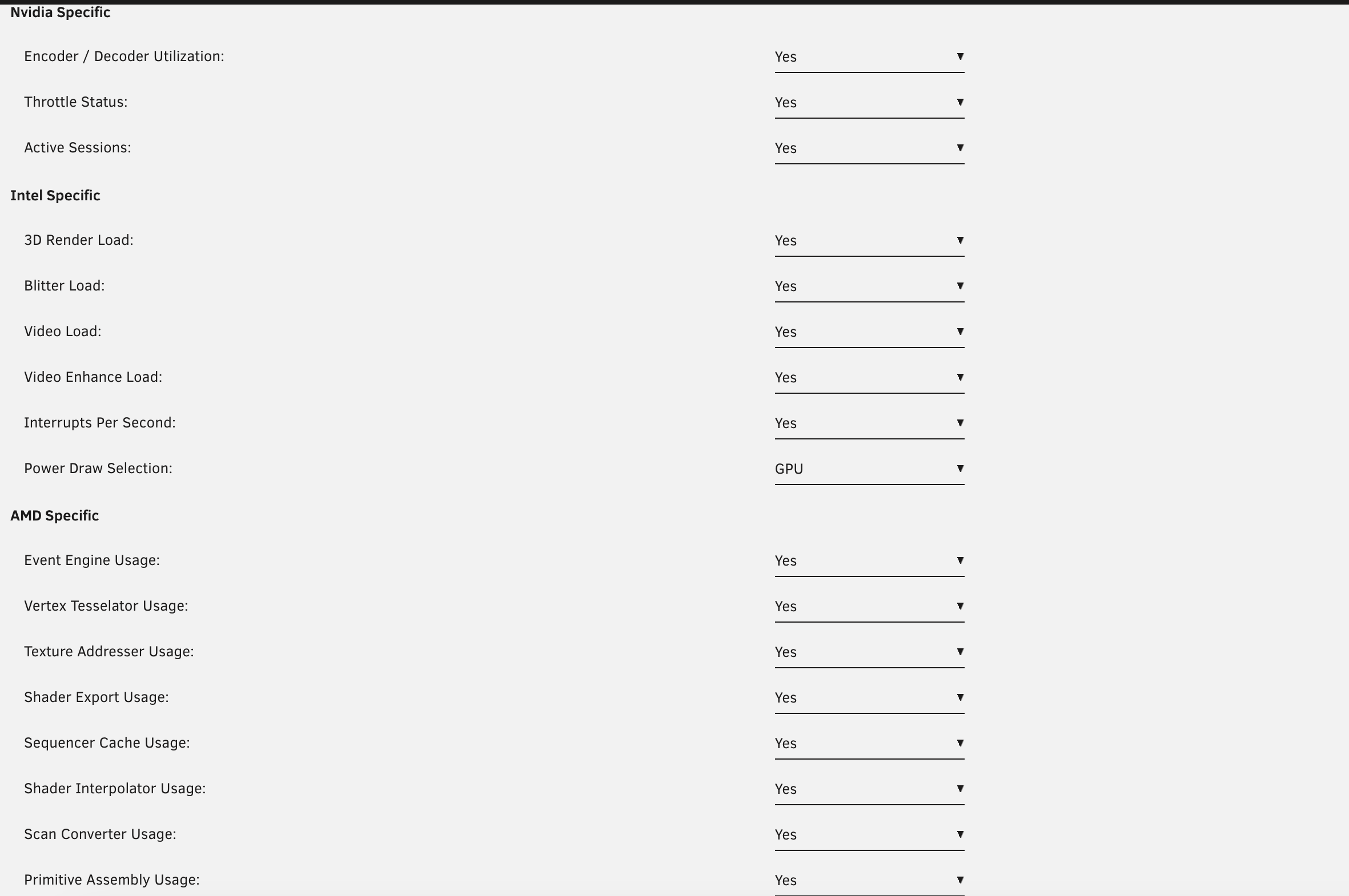

  6. <lspci -Dmm | grep -E 'Display|VGA'> outputs 0000:00:02.0 "VGA compatible controller" "Intel Corporation" "CometLake-S GT2 [UHD Graphics 630]" -r03 -p00 "ASRock Incorporation" "CometLake-S GT2 [UHD Graphics 630]" 0000:01:00.0 "VGA compatible controller" "NVIDIA Corporation" "GP106 [GeForce GTX 1060 3GB]" -ra1 -p00 "GALAX" "GP106 [GeForce GTX 1060 3GB]" 0000:02:00.0 "VGA compatible controller" "Advanced Micro Devices, Inc. [AMD/ATI]" "Baffin [Radeon RX 460/560D / Pro 450/455/460/555/555X/560/560X]" -re5 -p00 "Advanced Micro Devices, Inc. [AMD/ATI]" "Baffin [Radeon RX 460/560D / Pro 450/455/460/555/555X/560/560X]" inteltop is in the attachment. But it is empty. timeout -k .500 .600 intel_gpu_top -Jo - -d pci:slot=0000:00:02.0 outputs nothing. I found a really strange thing that I need to tell you. I have a macos vm which uses a passedthrough AMD Radeon rx460(listed above). When I open the vm, the gpustatics starts to work. But When I close the vm, gpustatics fail again with no outputs. Maybe gpu statistics takes rx460 as a input source wrongly in the beginning. When rx460 is occupied by the vm, it starts to use intel as input source. I can only assume this senario according to the situation. inteltop.zip

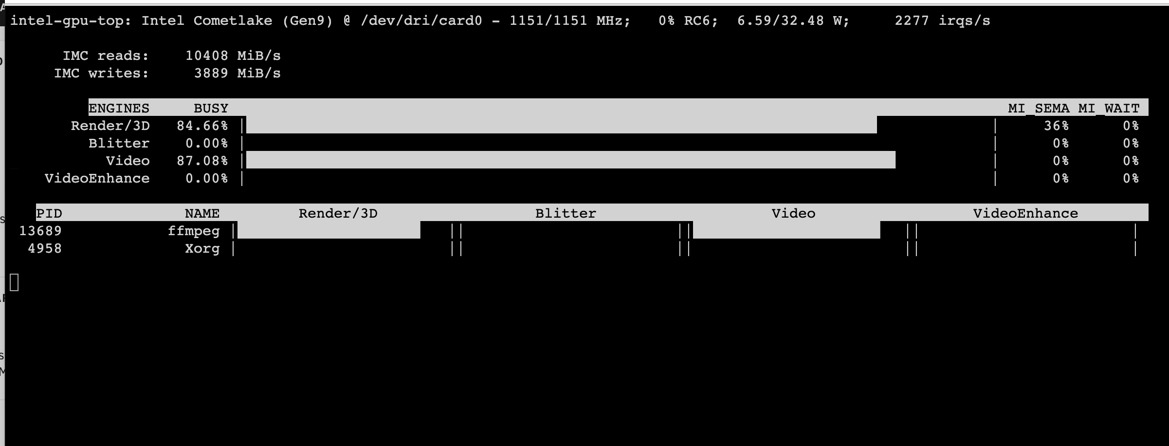

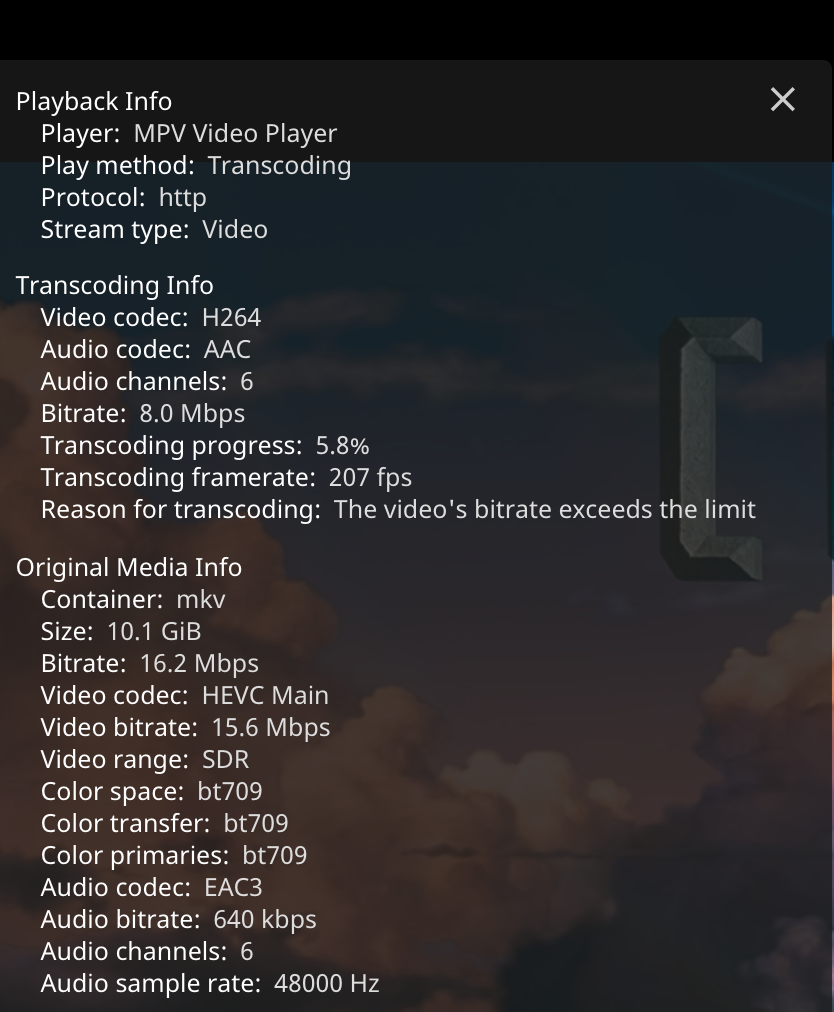

  8. Yes it's working. I did transcoding test using jellfin. Here are some screenshots. Intel_gup_top is working properly. Gpu statistics can't read the output.

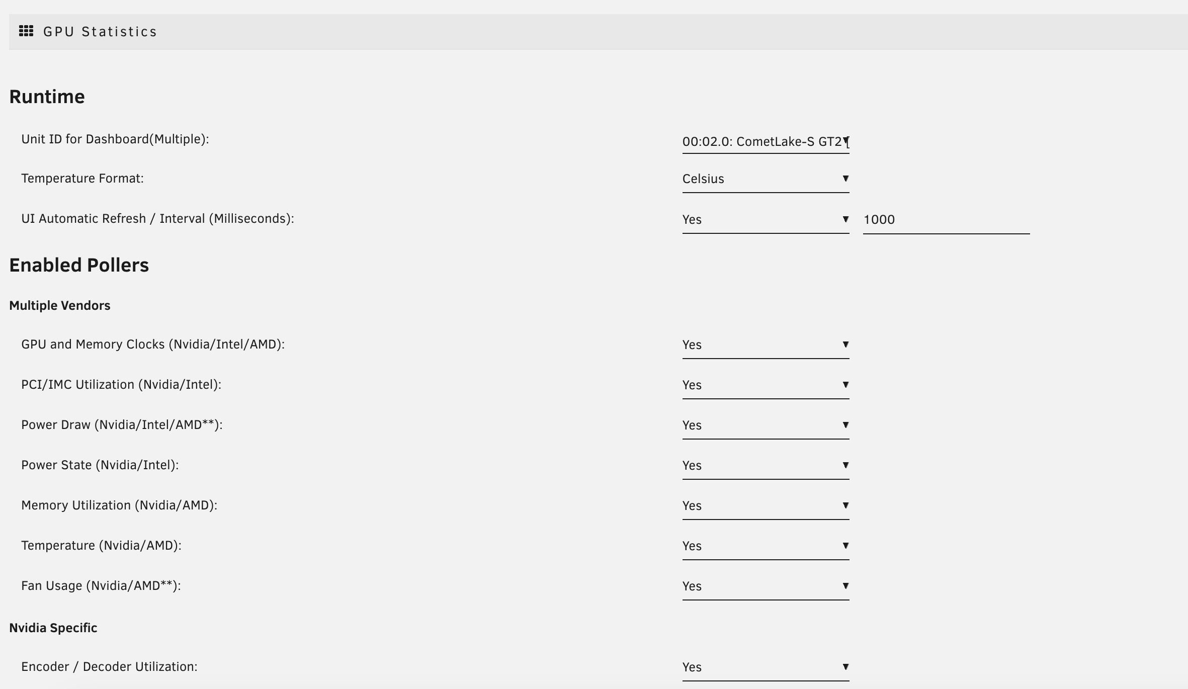

  9. maybe the the update of unraid has broken sth in the plugin. But the problem seems like gpu statistics can't read the output generated by intel_gup_top. Did the plugin work fine before you updated unraid?
  10. Did you update your unraid recently. I just updated my unriad from 6.9.2 to 6.12.3 last week. Both plugins were running fine under 6.9.2. GPU statistics stopped working after the update.
  11. yes. I've tried that. I've also tried to uninstall and then reinstall both intel gpu top and gup statistics. That doesn't help. at /boot/config/plugins/gpustat/gpustat.cfg MULTIGPU = "00:02.0" TEMPFORMAT = "C" UIREFRESH = 1 UIREFRESHINT = 1000 DISPCLOCKS = 1 DISPPCIUTIL = 1 DISPPWRDRAW = 1 DISPPWRSTATE = 1 DISPMEMUTIL = 1 DISPTEMP = 1 DISPFAN = 1 DISPENCDEC = 1 DISPTHROTTLE = 1 DISPSESSIONS = 1 DISP3DRENDER = 1 DISPBLITTER = 1 DISPVIDEO = 1 DISPVIDENH = 1 DISPINTERRUPT = 1 DISPPWRDRWSEL = "GPU" DISPEVENT = 1 DISPVERTEX = 1 DISPTEXTURE = 1 DISPSHADEREXP = 1 DISPSEQUENCER = 1 DISPSHADERINTER = 1 DISPSCANCON = 1 DISPPRIMASSEM = 1 DISPDEPTHBLK = 1 DISPCOLORBLK = 1 DISPGFXTRANS = 1 MULTIGPUJSON = "%7B%2200%3A02.0%22%3A%7B%22id%22%3A%2200%3A02.0%22%2C%22model%22%3A%22CometLake-S+GT2+%5BUHD+Graphics+630%5D%22%2C%22vendor%22%3A%22intel%22%2C%22guid%22%3A%220000%3A00%3A02.0%22%7D%7D"

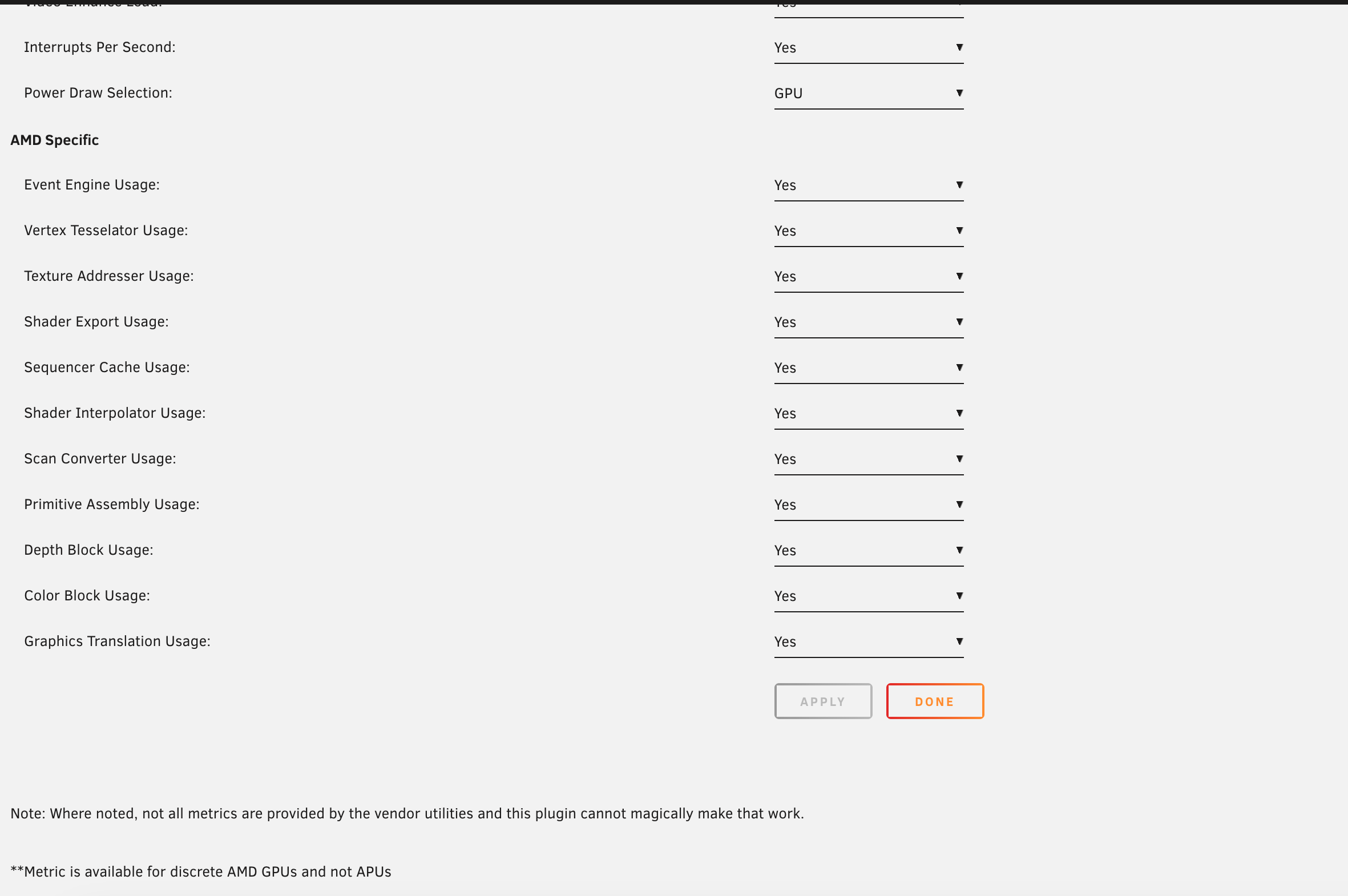

  12. ok. I included three screenshots of the plugin settings. You can tell me hwo to debug. It seems like the plugin can't read the data outputed by intel gup top and display it properly.

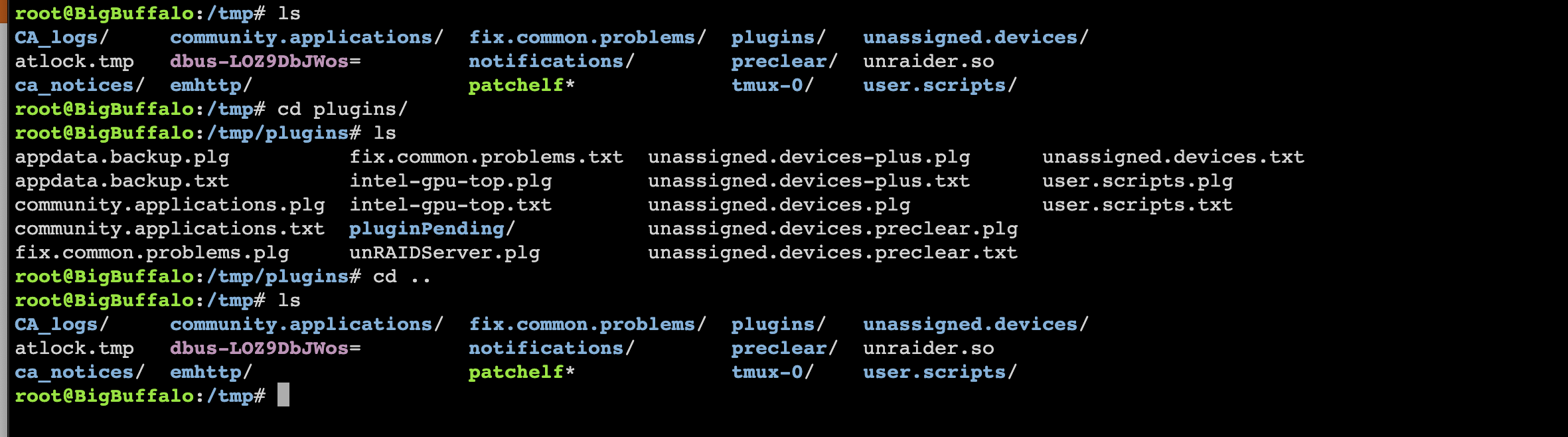

  13. gpujson under /tmp Time = Sat, 05 Aug 2023 19:22:31 +0800 {"00:02.0":{"clock":"N\/A","fan":"N\/A","memclock":"N\/A","memutil":"N\/A","memused":"N\/A","power":"N\/A","powermax":"N\/A","rxut il":"N\/A","txutil":"N\/A","temp":"N\/A","tempmax":"N\/A","util":"N\/A","error":[{"code":301,"message":"Vendor command returned no data.","extra":""}],"panel":1}} ~ ~ ~ ~ ~ ~ ~ ~ ~ ~ ~ ~ ~ ~ ~ ~ ~ ~ ~ ~ ~ ~ ~ ~ ~ ~ ~ ~ ~ ~ ~ ~ ~ ~ ~ ~ ~ ~ Read gpujson, 2 lines, 332 chars 1,1 Command intel_gpu_top -Jo - -d pci:slot=0000:00:02.0 outputs "clients": { "4294962338": { "name": "Xorg", "pid": "4958", "engine-classes": { "Render/3D": { "busy": "0.000000", "unit": "%" }, "Blitter": { "busy": "0.000000", "unit": "%" }, "Video": { "busy": "0.000000", "unit": "%" }, "VideoEnhance": { "busy": "0.000000", "unit": "%" } } } } }, { "period": { "duration": 1014.539619, "unit": "ms" }, "frequency": { "requested": 0.000000, "actual": 0.000000, "unit": "MHz" }, "interrupts": { "count": 0.000000, "unit": "irq/s" }, "rc6": { "value": 99.999998, "unit": "%" }, "power": { "GPU": 0.000000, "Package": 11.235806, "unit": "W" }, "imc-bandwidth": { "reads": 152.222533, "writes": 31.588686, "unit": "MiB/s" }, "engines": { "Render/3D/0": { "busy": 0.000000, "sema": 0.000000, "wait": 0.000000, "unit": "%" }, "Blitter/0": { "busy": 0.000000, "sema": 0.000000, "wait": 0.000000, "unit": "%" }, "Video/0": { "busy": 0.000000, "sema": 0.000000, "wait": 0.000000, "unit": "%" }, "VideoEnhance/0": { "busy": 0.000000, "sema": 0.000000, "wait": 0.000000, "unit": "%" } },

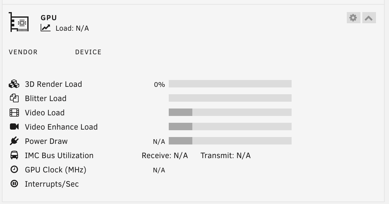

  14. I don't have gpu statistics output. (screenshot and diagostics included in attached files.)Please help! I am using unraid 6.12.3. The intel_gup_top and gup statistics are up-to-date. I run 'intel_gpu_top' under cmd and here is the output: intel-gpu-top: Intel Cometlake (Gen9) @ /dev/dri/card0 - 0/ 0 MHz; 100% RC6; 0.00/14.34 W; 0 irqs/s IMC reads: 143 MiB/s IMC writes: 33 MiB/s ENGINES BUSY MI_SEMA MI_WAIT Render/3D 0.00% | | 0% 0% Blitter 0.00% | | 0% 0% Video 0.00% | | 0% 0% VideoEnhance 0.00% | | 0% 0% PID NAME Render/3D Blitter Video VideoEnhance 5090 Xorg | || || || | bigbuffalo-diagnostics-20230805-0842 2.zip
