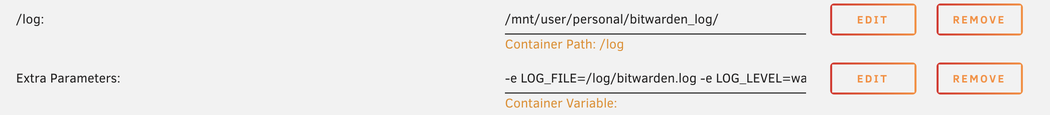

  3. He, Guys, was wondering if somebody could help me getting Fail2Ban working. Got the following: added to jail.local [bitwarden] enabled = true port = http,https filter = bitwardenrs action = iptables-allports[name=bitwarden] logpath = /log/bitwarden.log maxretry = 3 bantime = 14400 findtime = 14400 bitwardenrs.conf (inside filter.d folder): # Named this way beacause the one bundled with fail2ban is outdated # https://github.com/dani-garcia/bitwarden_rs/wiki/Fail2Ban-Setup # - Set up logging to file > https://github.com/dani-garcia/bitwarden_rs/wiki/Logging # - Set logging level to warn or error # Logged in bwdata/logs/identity/Identity/log.txt [Definition] failregex = Username or password is incorrect\. Try again\. IP: <HOST>\. Username: .*\.$ ignoreregex = added -e LOG_FILE=/log/bitwarden.log -e LOG_LEVEL=warn -e EXTENDED_LOGGING=true as extra parameter to bitwardenrs and mapped a folder for the log file. See also attachment. To Let's Encrypt (or Swag) added the same mapped folder. I can see the failed log in attemps in the log of bitwarden but F2B is not doing anything with it. gr Piet
