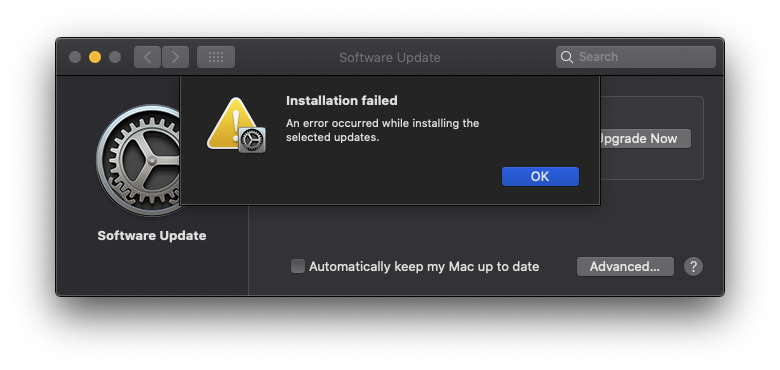

  3. Thanks for the info. I just tried to update but it keeps saying an error occurred.
