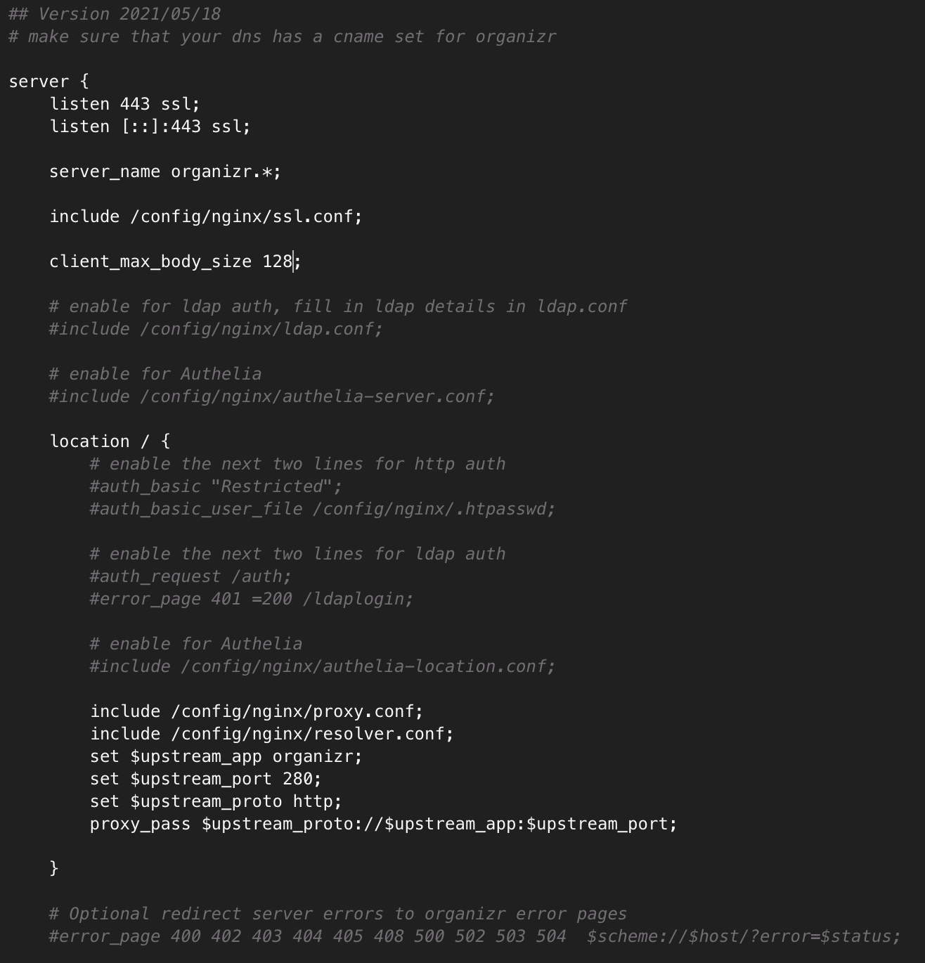

  1. Cant get reverse proxy to work for organizr. I am sorry having to ask for help on this, but I am at a loss. Prereq: 1) CNAME subdomain: "organizr.domain.xxx" has been created at cloudlare 2) Using SWAG - organizr.subdomain.conf has been configured (see attached) 3) SWAG restarted 4) Organizr is on docker's proxynet 5) Container name is "organizr" What am I missing? Container is up and running locally. ..
