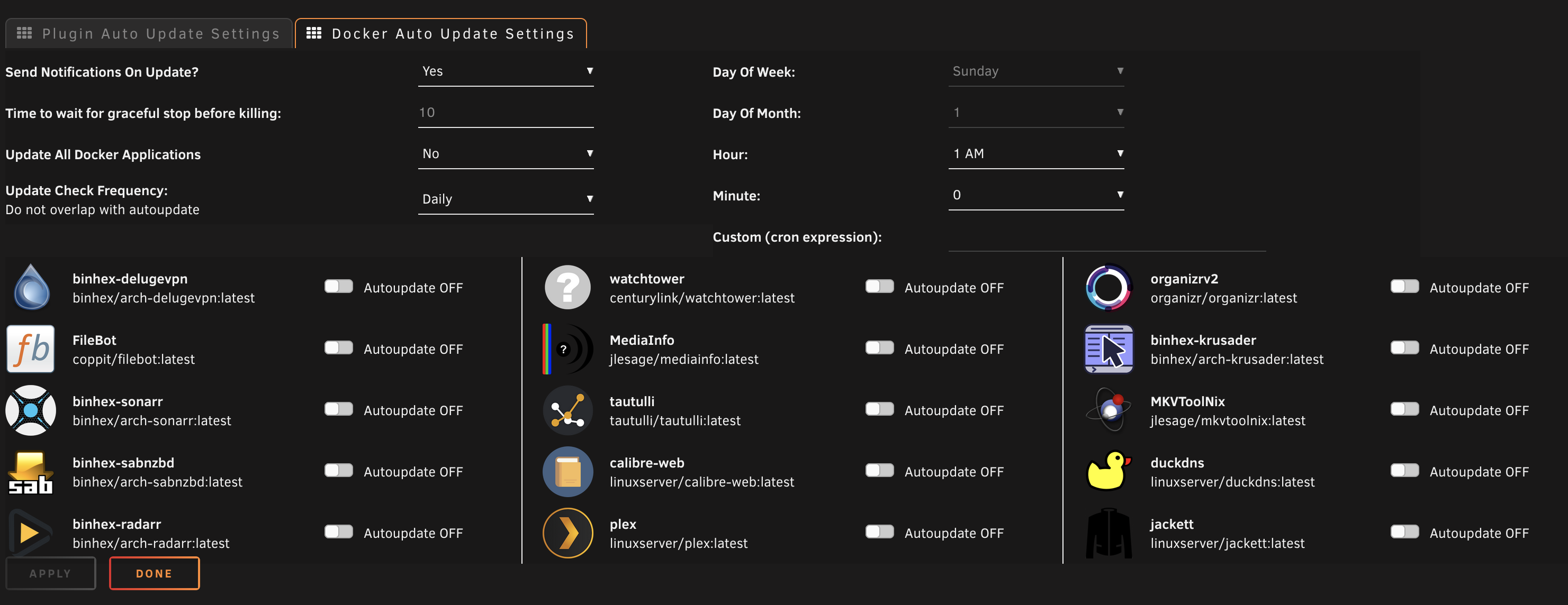

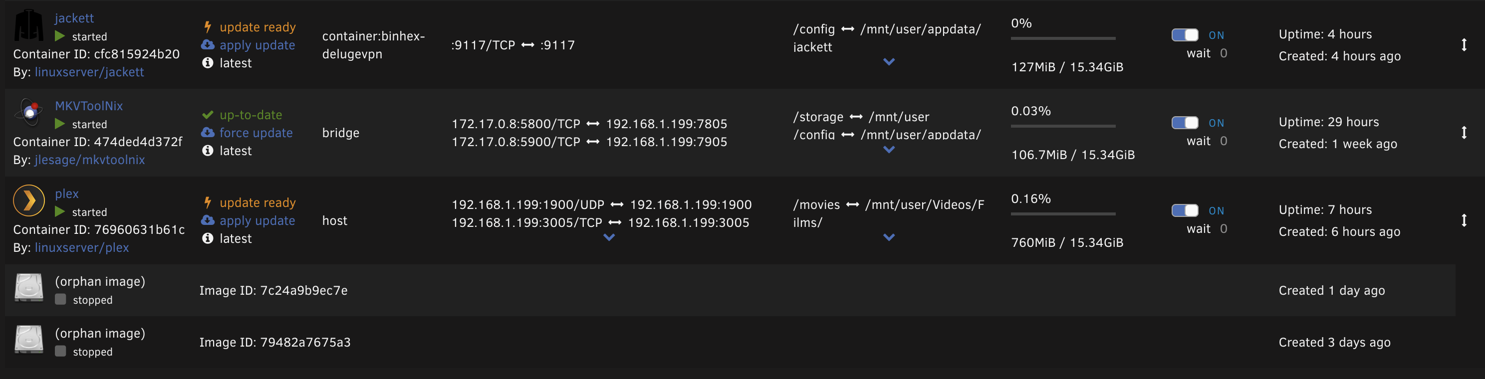

  4. okay so i disabled auto-update as detailed here: And there are two orphaned images and both Jackett & Plex have updates ready to apply ...

  6. yes - i am automatically updating them using the autoupdate plugin. I will disable all of those and post a reply once i have a chance to test with a new version release. I'm going to assume that orphans would be created when i hit "apply update"?

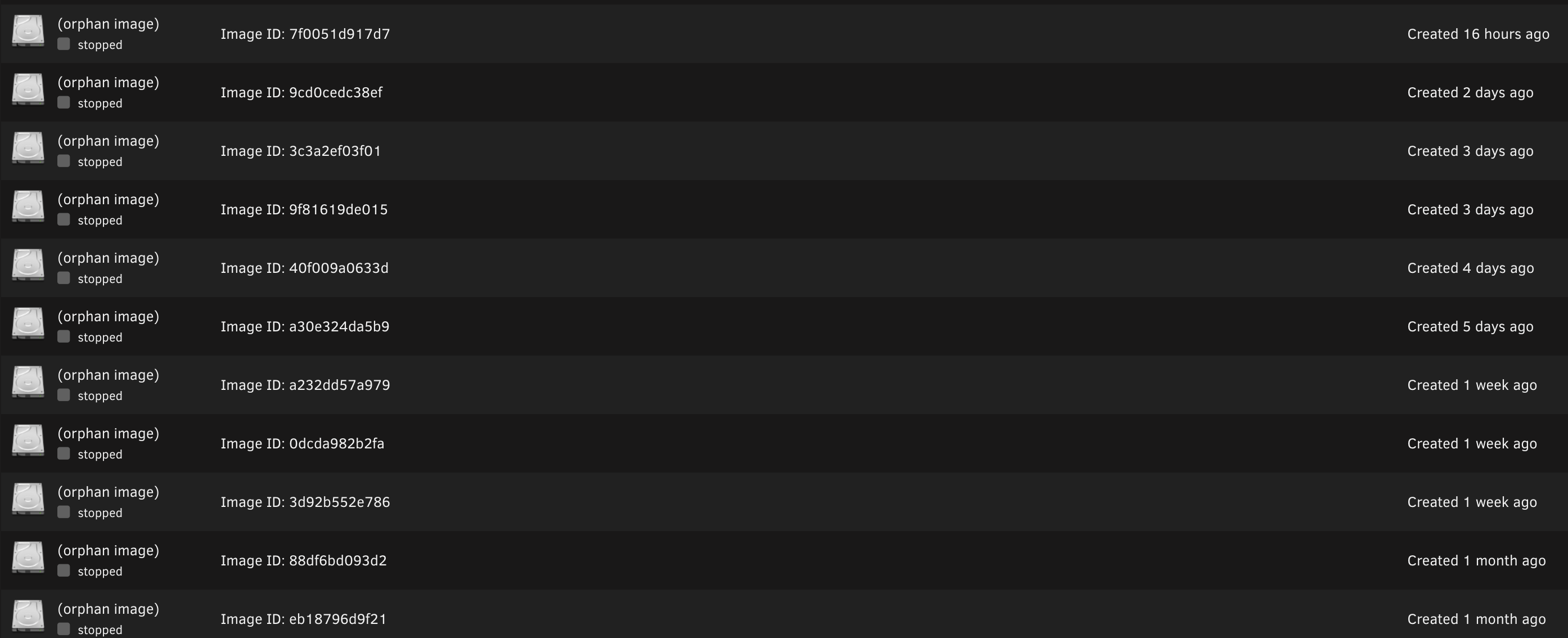

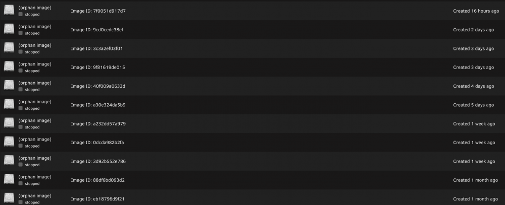

  12. Here ya go... as well as a screen shot of another orphaned image that appeared today but says it was created 2-days ago. buddha-diagnostics-20210526-0937.zip
  13. So just another update for people in case there's a way to solve this. After making my post on May 17th, I went in and deleted all of my orphaned images. Today i logged in - and low and behold there are a bunch listed including some with dates of more than a month ago. How is it possible that images created before my delete date are reappearing? Example: I have deleted these to by clicking on the drive icon and selecting remove. What could possibly be causing this?
  14. just wanted to bump this back up again - as I've just logged back into my server and had about 40-some odd orphaned images in. I am not sure what information to share right now to show the problem or give people here the ability to fix it but i would be happy to share whatever people think i need to post.

  21. I cannot explain why this keeps happening - I use auto update applications to run daily at 1am my time and every few days i will log in to my server and notice that i have new orphan images. My understanding is that they appear because of failed installs but i really don't know. Is there a way to automatically have my server delete them? If not, what other options are there to prevent them from filling up my docker container and having to manually remove them one at a time.
